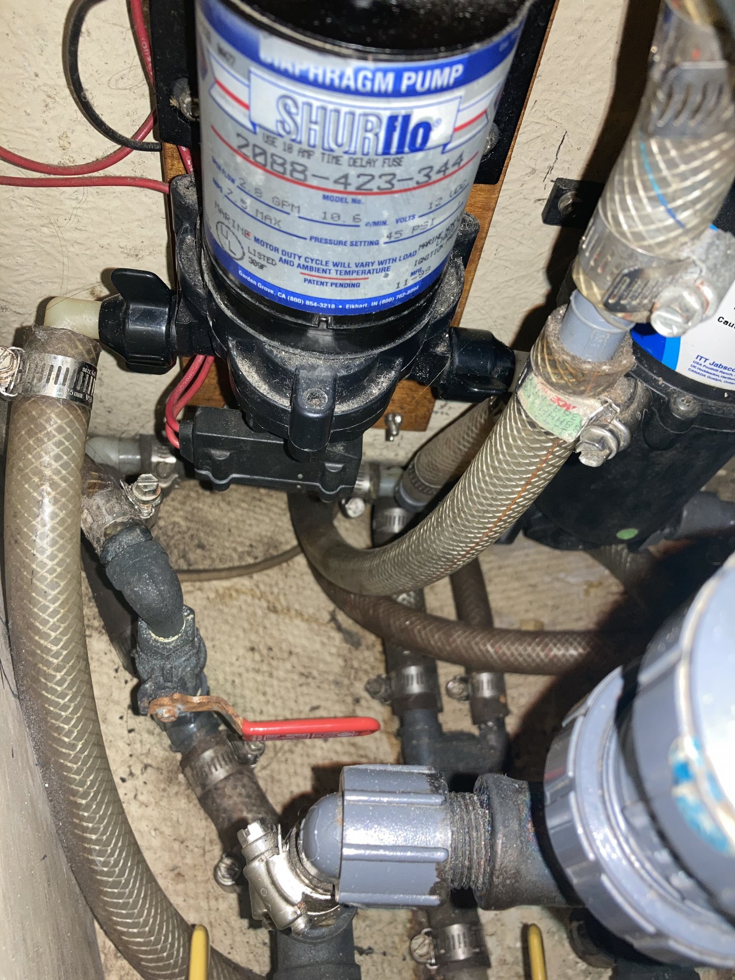

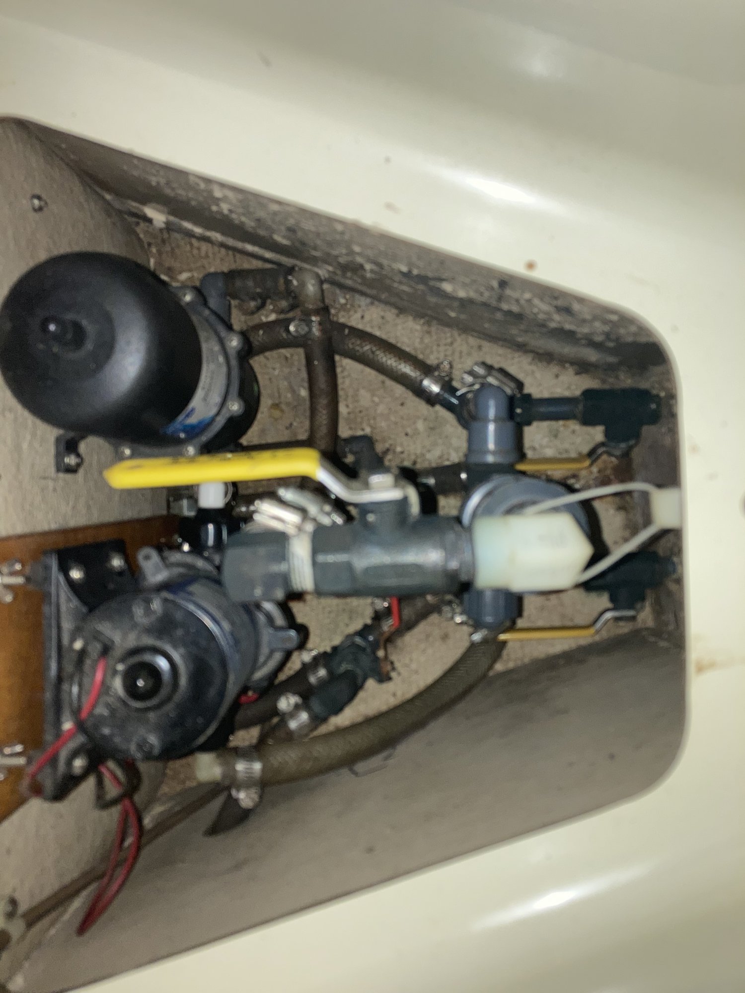

I had a functional water system. Accidentally ran one of my tanks dry, and then water pump wouldn’t shut off. Pulled air through it by mistake and noticed what I did and so I shut off the pump. Now I needed to figure out how to prime the system..
Got the system primed and can pull water to hand pumps. I also loosened clamp leading up to the water pump to make sure water is leading right up to it. Water pump still won’t pump water to main faucet.

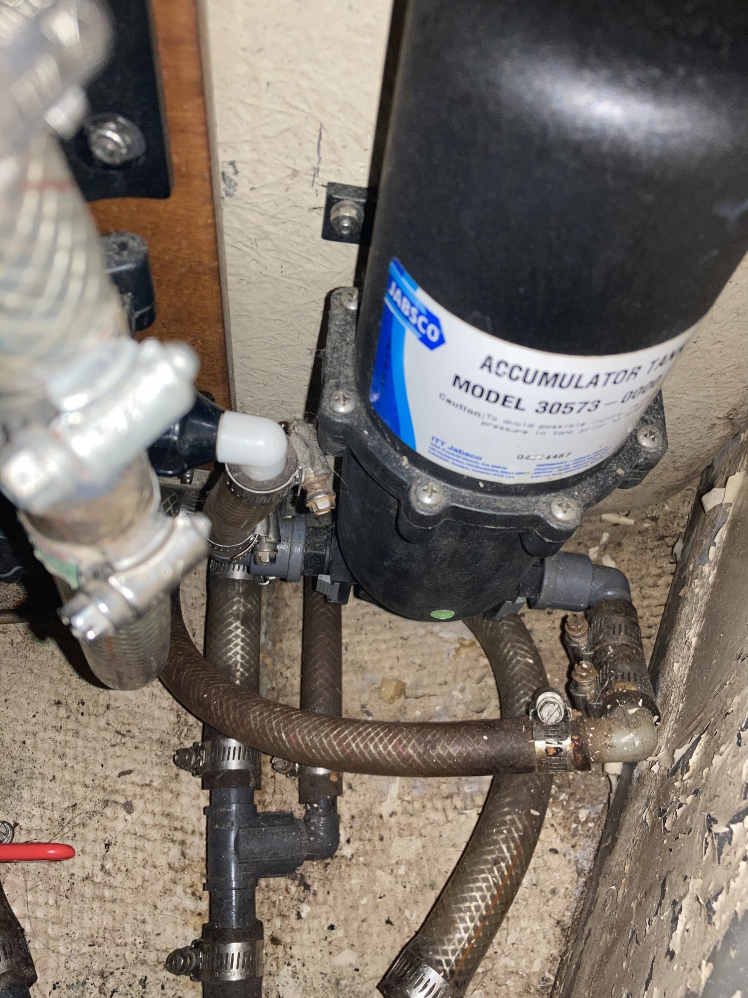

I have a Shurflo model 2088-423-344 water pump and then a Jabsco accumulator tank. (I’ve also got a hot water tank in aft storage bay behind the galley sink, unrelated but important part of water system.) Anyone have any ideas of potential fixes? And if not, any ideas of potential upgrades to make it all work again?
One idea is replace water pump with a self-priming pump. If this is a good idea, what product is compatible? And should I keep the accumulator tank with the new pump?
Advice is much appreciated. If anyone helps me fix it I’ll crew or skipper for you on my boat or yours, feed you brunch, etc. Puget Sound. Boat is Cascade 36, 1982.

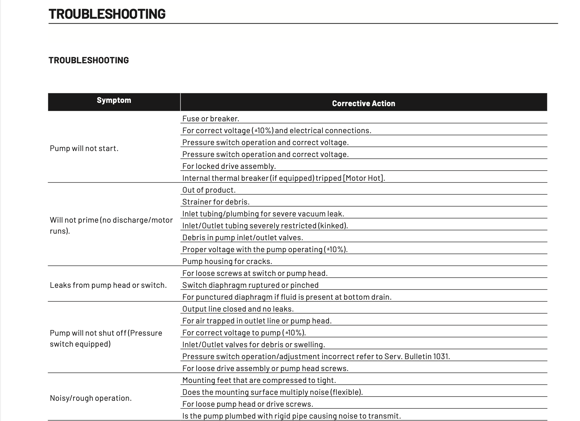

1) Your pump is self priming up to 4 feet of lift
2) Disconnect the pump inlet line to see if you have water flow.
If flow, then you have Air entering the pump suction.
Jim...
10,150
The Jabsco is a self priming pump. You may have some trash in the pump valves if it is not pumping and it is not leaking . The valves can be disassembled (not an easy job) and cleaned. Is it pumping air to the faucet? If so, it may take a bit of running the pump and venting air out the faucet to get things flowing..
Ahh Jim beat me to the note.
23,792
Disconnect out flow line and turn on pump.
Will confirm water is flowing through the pump. Then all you need to deal with is the hose to your faucet.
Open the faucet and pump water through.
