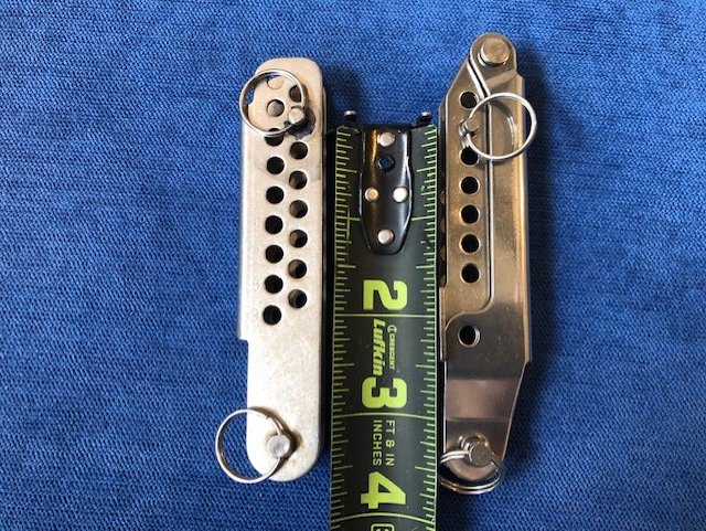

Just a question about those shroud levers. Do they require shorter shrouds? Would the factory shroud lines still work in these? Just wondering if the lever would make the shrouds too long.

They replace the existing adjusters. I measured my adjusters and they are within the range of these. Mine have 17 holes and these have 7 so fine adjustment isn't possible. I can live with that over being thrown to the cockpit floor and attacked by the mast. If you go to the link at Duckworks there is a hole-to-hole specification.
Stickinthemud may have more info.

Jeremy, my adjusters are somewhere between here and Kent WA. Delivery is scheduled for Thursday. I plan to put them on and go driveway sailing. I'll report back.

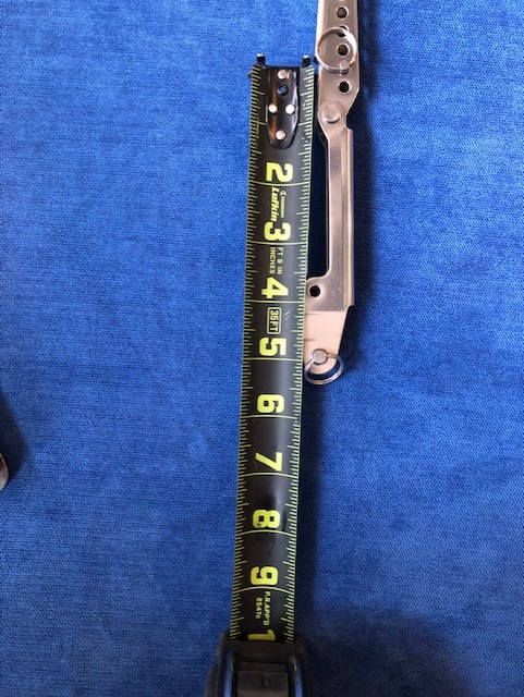

Jeremy, I have the adjusters.

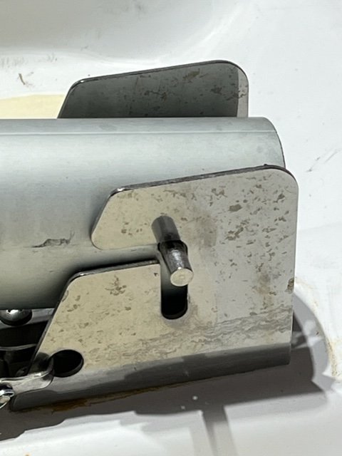

In my case, position 2 adds about 1.75 inches when open. I'll install and test. If this isn't optimal, I should be able to incline the mast partially and set in the tabernacle. (Who names this stuff?)

If my experience is any indicator, that additional length will be enough to get the base of the mast inserted at the tabernacle.
View attachment 202275View attachment 202276
Great. Thanks for the info. It looks like installing them with the existing shrouds shouldn't be a problem. In my case, I am ordering new standing rigging and wanted to make sure the standard length stays would fit the levers put in place by the previous owner. Those levers do make stepping the mast very easy.

Now with no fingernails, the adjusters are on. How I hate those rings! One of the quick release pins didn't have good retention. I found it loose in the package. DW is sending a new one.
I had 3 that hit position 2. One hit at 1. The Wx is bad until Friday. I will raise the mast and see how this works.
I am at the far end of adjustment. Is there any reason for not using the old adjusters at the mast end to add an inch or two to the shrouds? I can see an easy 4+ inches to be gained if necessary.

That makes perfect sense as long as you can get proper tension. I would try to make it work without them though, if at all possible. Those stupid rings are notorious for snagging sheets and halyards. The fewer of them the better. If you order new stays, you may want to have the length adjusted accordingly for a cleaner rig.

Stickinthemud gets 2 gold stars. I rested the top end of the mast on a 6' ladder and the base went in without a struggle. I didn't step the mast, no need. I need a ladder regardless, so I am good.

Awesome! Seriously, those quick-release shroud levers should have been standard equipment.
