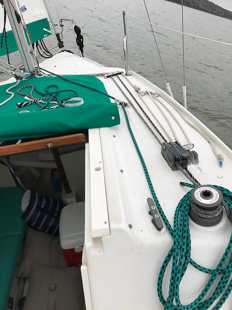

My 23.5 is a 1995 and the jib halyard goes to the cockpit. You can see in the pic it is the black line. The dirty white is the main halyard and the other is the keel haul.

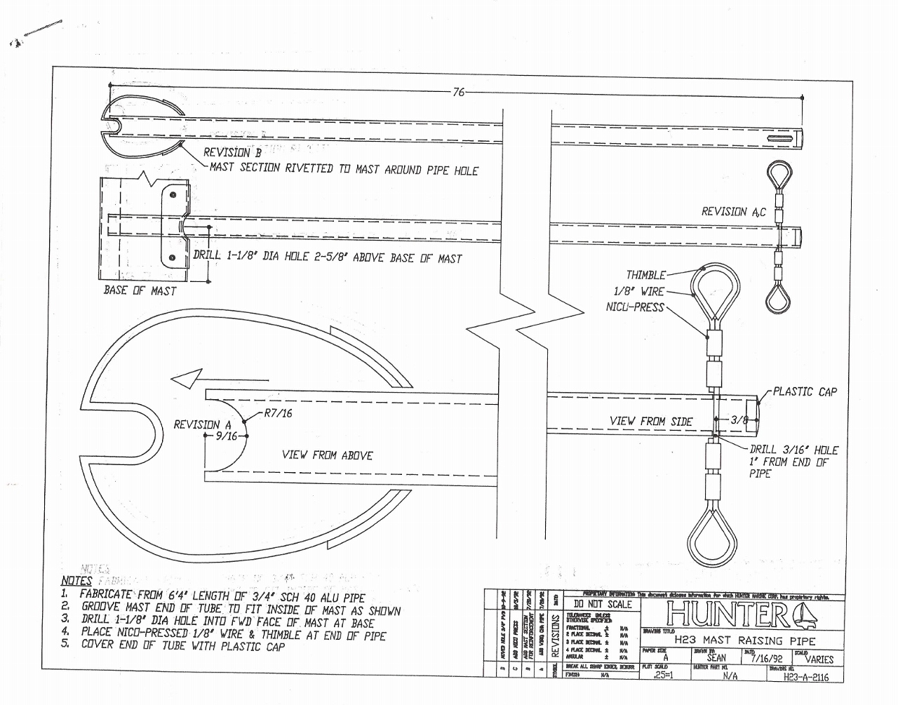

GB, I have a 23 which lacks a factory mast raising system so the PO rigged his own. He added a very robust rather thick walled aluminum tube to extend the trailer tubing that supports the bow winch, making it about as high as the deck at the bow. He put a stout screw eye that was welded to be closed through the tube maybe 6 in below the deck level. The block and tackle that pulls the mast up is shackled to that eye, not inside the anchor locker. He rigged a dedicated b and t system rather than using the main sheet tackle, with a rather long line. I run that line back along the deck to a jib sheet winch (he used to tie it to his car to pull up the mast - I'd never do that!)

I ran everything to the cockpit so I could get under the mast to give a little lift while pulling to raise. The jib halyard was originally cleated but because there was so much slack as I tried to raise her, I hoped pulling the jib simultaneously to counter might hold the tension, thus pulling from both at the same time (which I know is self defeating but the only way to try to keep tension to prevent the pole from just flopping forward and damaging the area around the hole in the mast where it is inserted).

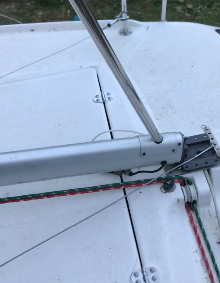

I was hoping to save those lessons for later on... CD (Crazy & WONDERFUL Dave) mentioned that it looks like I am ***missing*** something crucial to the process based on watching the videos (hardware at the base of the mast?). Which means identifying this to add it to the list as well. I could really use photos of what she's SUPPOSED to look like fully rigged (better than the ones in the manual and the McDowell manual although those have been my bibles thus far, they are still a little greek until I get more practical application. I was hoping this would happen AFTER I had her in the water a while & met some wonderful sailors in my area who might come aboard and trade their mentoring for my bbq and/or a free O'Day 22 (long story) for good measure! C'est la vie!.

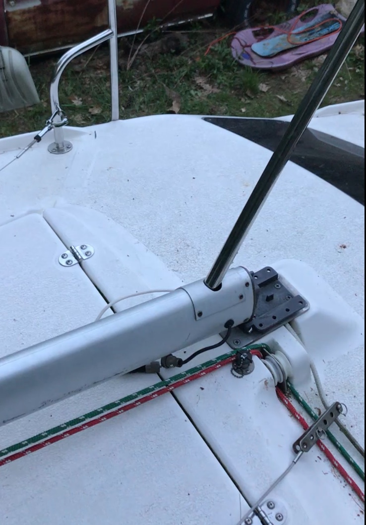

Below are the stills I sent him showing the pole inserted - it just doesn't seem to have any real "fit" to it - it doesn't "sit" like it is in it's place. Maybe that's just me? (We build our log home ourselves/no kit, so when something doesn't "fit" something's wrong - I'm not used to things not "feeling" like they are "seated").
Evidently, I have a long way to go before I set sail with her for the first time. I'd sure like to get her wet as soon as possible and work on projects as we go but safety first...

I would say photo one is the correct position in the mast to start the raise or lower.
I know exactly what you mean about a sloppy fit. I spent some time looking into mast base and scratching my head for the first time.
I don't know if it's a standard thing but my pole has two opposite sides ground out to about an inch along the pole to make a jaw but I can't see any apparent reason for this.

Just checking that your pole has the notch cut in the end to fit around the internal sail track channel in the mast? That helps stabilize it horizontally, less so vertically. Here is the gin pole drawing for the 23.5.

The pole looks right to me. It is floppy, but thats just the way it is. It does work under tension. (Side note: Do not push on it when raising the mast!) As for missing hardware on the base of the mast- there is not a lot to it. The mast has a pin and a cotter ring, and thats about it. Im not sure what Dave means.
I think you can still do this, as is, Jen G. Start with the pole secured and tipped toward the top of the mast10-20 inches. Tie off the jib halyard to the cleat on the mast. Make sure the side bridles are in place, and like mentioned before, get up on the bow of the boat and start pulling on the main sheet set-up. If you have a helper in the cockpit, have them raise the mast as far as they can reach it. After that it will be easy. Be sure you have the pin ready for the forestay. And about 3/4 of the way up, stop and check (or better, have a helper check) the side stays for binding at the chain plates.
I dont think it would have ever worked, trying to raise it from the cockpit. In the pics and vids, the main sheet and the halyard both take a few bends over an edge or corner while on the way to the cockpit. That is a huge binding factor when under tension.

I think your way over thinking this CD. Its easy to tell if the mast raising pole is right or not. Caverun posted the dimensions of one in post #53 of this thread. The only thing that is really special about it is the odd end that goes into the mast. It needs that odd cut-out so that it rides on the corresponding metal ridge that you can see when you look inside the hole in the mast. Im sure mine is a factory pole, and it flops around quite a bit until the lines are tightened up.
