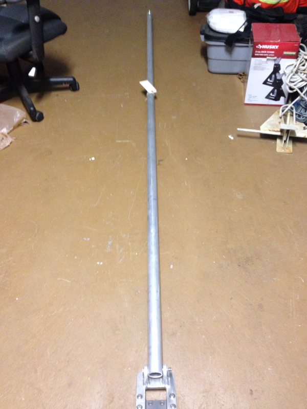

Friends absolutely Crazy D is the source of info but i wanted to share what i designed and the local sail shop fabricated for me. I will disclose a few things. 1. I picked it up today so i have not had a chance to test but the theory is the same as any gin pole design out there. 2. It is designed to fit z-spars z 140-230 as it bolts to the wings of tbe tabernacle for those mast steps. 3. Will need spring lines to prevent the mast from going sideways and causing an accident.
Hope this is helpful to anybody out here as i found this research to be quite overwhelming with all the options out there.
As you will be able to see the possibility exist for me to leave the base attached and only remove the pole.

Good morning Dave, yes i thought of that and because there is very little wiggle room i figured it will be ok. Still being a weaker metal sure is a big consideration.
