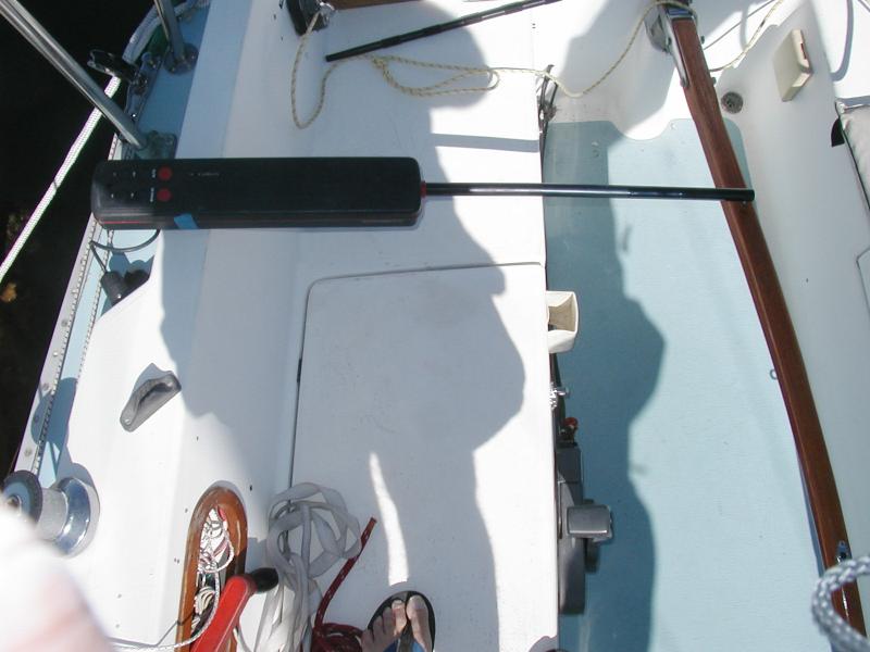

I just installed one but of course haven't been able to try it out.
What installing an AP, try and place the plug socket in a secure place, out of the way of foot traffic. The thing makes a hard connection and has NO give. Sum this will last maybe a year of solid use before someone snaps it off with their foot in a rough seaway.
Sorry but after using the boat a lot I don't agree with that,
Once the brackets are made/installed then using it is maybe a 20 second deal. It just sits on one bracket (far starboard side of laz hatch in my case) and a pin on the tiller and then plug the cable into a socket and it is there. Simple and fast. I think I'm going to enjoy it.
In my case besides sailing and motoring I hope that it helps me getting to anchor. I'm setting the trolling motor up so I can toggle it on/off from the bow. With the tiller pilot I should be able to reduce speed and set course to where I plan on putting the anchor down and toggle the trolling motor on/off to get there on course and then off and drop the anchor,

Sum, I have a remote for the ST1000 that I can control the AP from the front of the boat. It's fun to be able to stand up front and steer the boat while making way in the harbor. At MDR the motoring channel is buoyed off rather narrow. The Kayakers and SUP's think that the pedestrian traffic rules apply. When I don't use it I have to occasionally run back and make corrections, It is a wired remote and unwinding and rewinding the cord can be a pain so I don't use it that much. I am thinking of rewiring a plug near the mast to make it easier.
On the Mac26 I used to have an old Tillermaster that I installed a receiver switch and car door remote that I carried in my pocket as a buoy dodgers. I would not change the course but it had a momentary switch that changed the course as long as you held it in. As soon as it was released it would go back to the old course. The ST1000 remote changes the course by 1 and 10 degree increments. Trying to make it wireless would be a little more involved. Installing a remote receptacle should not Tb too much work and only requires 18-20 gauge wire.

But I've seem several of them snapped. And in your own words, you "just installed it and have not used it." So how would you know?? I'm simply pointing out that putting a hard, brittle plastic connector what it can be hit with your feet is not a great idea. If you want to argue with that common sense advice for that sake of arguing, so be it. But to everyone else I say, don't put it there where you can snap it.

I'm not aruguing I'm just saying I know where my feet go in my boat and don't feel it is going to be a problem there. You have a point in general about placement that is a good one, but I don't feel it applies to my situation as far as where I placed the plug.
Over 90% of the time that cup holder that is part of the cockpit bed shown above is above where that plug is located.
My comment about not using it yet was in reference to not actually using a tiller pilot to navigate.
I think there would be more people post on here if people didn't try and tear their posts apart but took them for what they were. I posted what I've done not what anyone else should do.
I removed my other posts on this as 'obviously I've done this install wrong and would not want to suggest to anyone else to screw up the same way,

I'm sorry that you took my comments as 'tearing your post apart;. That was not my intent. At all.
This is an open internet forum, where people freely express their ideas, mostly so others can learn from them. I suppose that is why you took the time to post your picture. When we do post on the internet, it is part of a large global conversation. We expect (and want) comment on our thoughts and ideas. Sometimes they agree with ours. Sometimes they do not. And sometimes they prove us wrong. As for me and this conversation, I noticed right away (from prior experience) that based on that picture and arrow, my opinion was that the plug was in a poor location due its it likelihood of breaking when brushed with a foot. That was the reason for my comment.
If it indeed works for you (after you get around to actually using it), I'm happy for you. The cup holder shown in the 2nd picture will probably help protect it. But to everyone else, I'd like to say that the connector of the Raymarine 1000/2000 tillerpilot is very brittle and will snap if mistreated. Prudent seamanship would have you mount it in a secure position as possible to reduce the chance of it breaking at the worst possible time. The footwell of a cockpit is probaly the WORST place for it. Hopefully that makes everyone happy.

Sum, let me begin by I always look forward to your post. You put Al lot of thought and work into your mods. I can see where Jackdaw would be concerned about someone breaking it before you posted the cup holder picture (BTW another nice mod). As one who is guilty of snapping off the starter key on a Cat 30 on which I was a guest. The key of all places was on the side of the cockpit seat just waiting to be kicked. I felt really bad when I did it, I don't remember now if it was before or after my shoulder bumped his drink holder that was mounted to the stern rail post. The cup holder ended up in the water floating there tempting us to retrieve it. When he tried to get it with the dock hook it filled with water and sank. Needless to say it was my first and last time ever on this guy's boat, I'm sure he still talks about the old fart that tried to tear apart his boat.
In regards to your placement, even without the cup holder in place, that big blue arrow should help to keep people from kicking your plug.. ;)

FWIW, I cut my AP plug off and used a cigarette plug.
The female plug in the engine well would get rusty, and I'd replace it, but I could always run an extension into the cabin. I try to have a backup plan!

On the St100 the cable not only carries the power lines it also has a wires for the remote control and data information from the GPS.

I think Jackdaw has a valid point. My suggestion for Sum's connection is to shorten the cord and relocate the waterproof plug as close to unit as possible. To me, the lengthy cord poses as great a potential problem as the plug location.
Not trying to be critical, just making an observation from my own experience. I've made a number of miscalculations that could have been avoided with a friendly comment or two. For instance, although my wire connection is ideal, mounting the unit on the coaming means a lot of extensions added to the control arm. Although this old TP (Autohelm 1000) has worked flawlessly for many years, it would be even more efficient with a short bracket to move the pivot mounting inboard 6-8 inches. Right.... I'll get around to that project sooner or later.

I agree... Jackdaw does have a valid point to anyone who is thinking about installing one... but then Sumner shows in a later photo how he has the plug protected by a utility/cup holder that mounts over it... it just wasnt shown that way in the first photos...:D

On my C 27 I put the autopilot plug in the back of the cubby so that it was out of the weather. I had a plug on my Mac 25 for the outboard that was always becoming corroded with the rain. I didn't want to go through that with this plug. It's pretty easy to get to and well protected I also have the plug for the remote control right next to it in the cubby.
