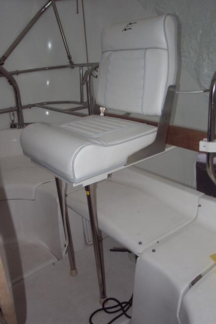

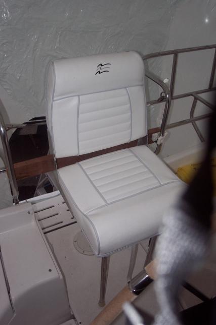

Here are some pics of a helm seat I designed and built for my 44DS. Comes apart in two pieces for stowage in the large cockpit locker. 2 minutes up and 2 down.
