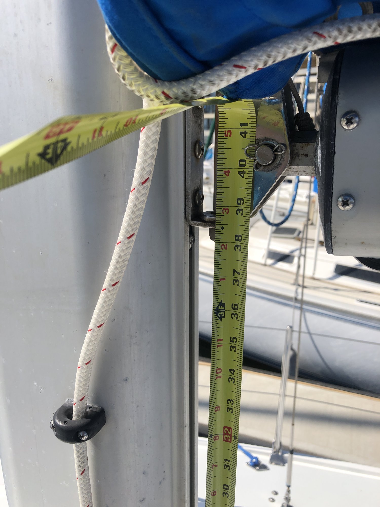

I measured my deck to boom yesterday. 40-1/2” from deck to center of boom. That’s almost 12 more than yours.
So I take back what I so confidently said. Maybe it’s not your sail. Our deck molds are different but I doubt if this measurement difference is due to that. Most of the significant changes are in the combing area I believe.
To me the key question now is: is your boom horizontal with the water when hoisted?

I checked my rig today at the boat.
My deck to top of gooseneck is 42”. Another 7” to the bottom of the slot.
The cockpit sole to bottom of the level boom is 65”.
I also have a screw and washer at the top of the slot to keep the.slugs from falling out.
