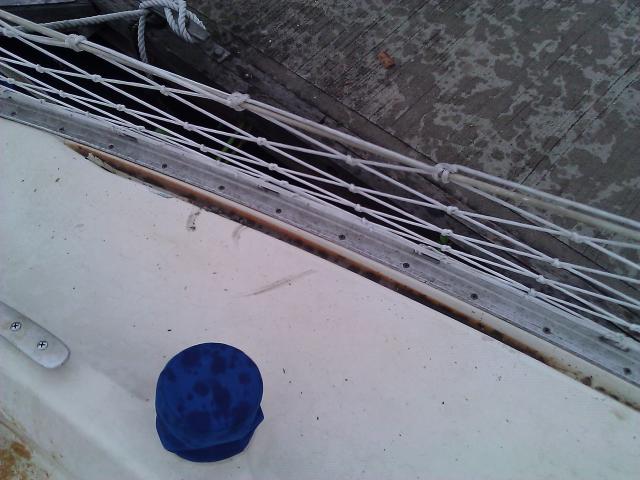

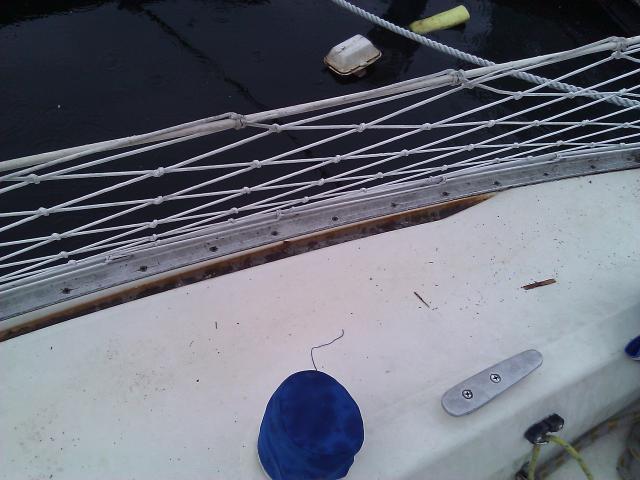

Dear Y25 owners, I’ve a new question/problem that need some help.
Probably all of us have the same problem if we live in a place with rain!
Every time after rain my boat accumulates water in the boat sides of the hull.
See the pictures for reference.
The problem is, if I’m in the marina I can just clean it or dry it with a cloth. However, if it rains and I don’t go to the boat, it will dry and looks like a mess.
I though on doing some draining holes but doesn’t seem very easy to do in that place because its too tick and not near the exterior of the hull.
Does anyone addressed this problem before and found any solutions?

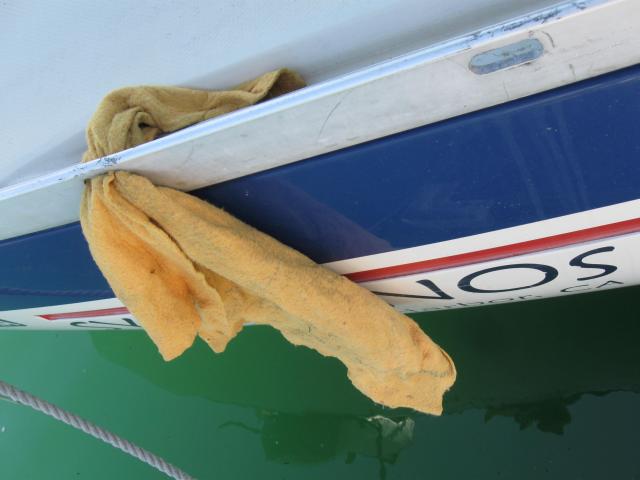

My boat has four holes carefully drilled through below the toe rail. there is usually still a bit of water left toward the stern. I experimented with Ted's suggestion. Took one of those high aborbent cloths (sham wow) and stuck it through the toe rail. Looks tacky but worked great ! I'm sure it can be cleaned up a bit to look better.
