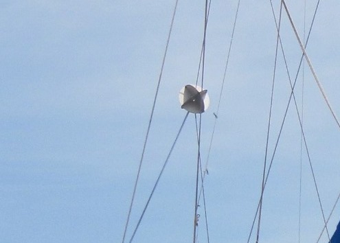

I have a Davis radar reflector hanging from the lower spreaders and have been concerned with losing it if the mounting hook fails. How do you all have these mounted? Mine is hanging by paracord tied at three points instead of one. It runs through an eye on the spreader which after 4 years has shown some wear. Looks like this one but has a three part harness instead of that single line.

I threaded mine through the backstay above where it splits. It just sits there and can't fall down.
My friend only has a single backstay. He threaded his through and tied a piece of line above and below with rolling hitches. They will only slip upwards. He pushed the reflector up with a piece of PVC pipe.

Mine's secured at three points, with the primary attachment at the upper spreader. The other two lines are to each side. The only failure I had was because a metal clip holding from the side pulled through the reflector. I reinforced the hole with a metal grommet on the new reflector and have had no issues since.

I have a small line running through the center and have it tied off on a stanchion to keep it from swinging. When we get bouncing over the waves it just seems to toss a lot. Somewhere offshore the line snapped and it had fallen into our stackpack. I found it the next morning after thinking it had gone overboard.

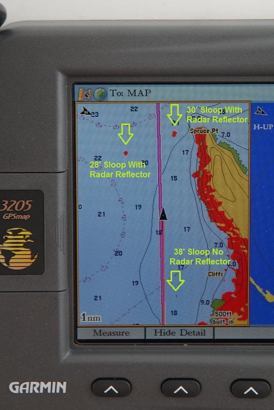

Radar Reflector tips
... BTW, companion boats w/ radar tell me that my target strength does not seem to be enhanced on their units when it is up, versus not up. So, I question the "need" for these things at all; even less to have one dangling/swinging from the spreader all the time!!
I just had to note that "it's not necessarily the size, but how you use it!" :D
Here are some things to check and not all reflectors are created equal. As I recall the Davis basic model worked as well as some of the $200-300 models. The #3 link below has some good reviews.

I think that's the question--is it? The vessels can be detected by radar w/o a radar reflector up-- so, do these things really "enhance" the target return? Sure, if you put 'em in a box and hit them with radar they'll bounce it back OK. BUT--do they significantly increase the return strength from a sailboat having a big aluminum mast and big spreaders already??
Without a reflector the only solid return you often get off a sailboat is the motor! The rig is very 'stealthy'... very few flat 90 degree surfaces to give a good return.
