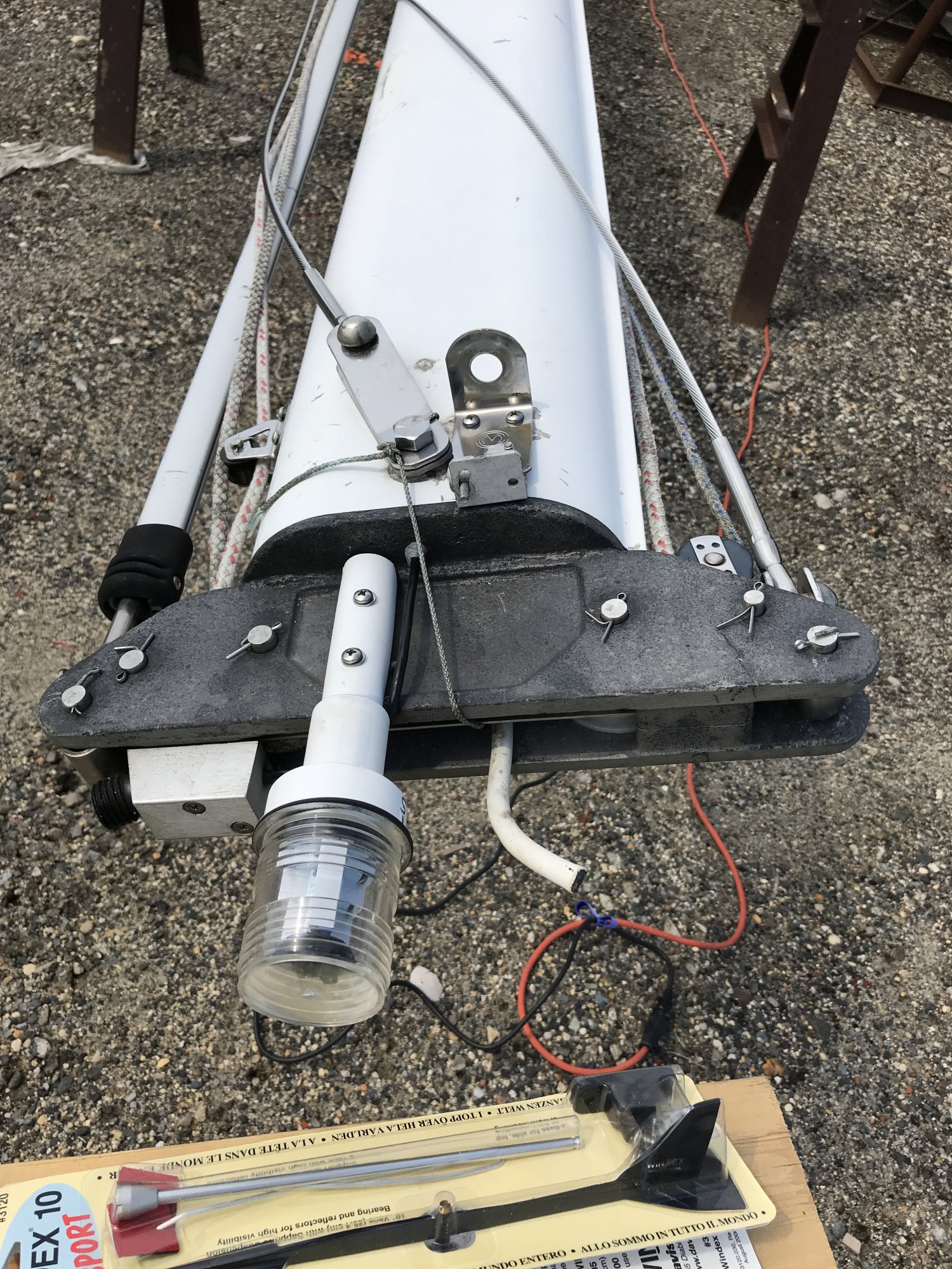

My C30 had a mouse line in place but I used the old antenna line to pull a new one up the mast. The C30 mast has conduit running up the mast. You can access all the wiring at the bottom by removing one the the halyard exit blocks. Look for the line of rivets going up the mast. Then pull the exit block that is closest.
The top of the mast may be an issue but looks like it could be done. Here is a photo.
The flat plate directly on top of the mast only has a few holes in it to allow the lines and cables through to the top of the vertical piece. If you radar cable runs to the top, your golden. If it is lower and comes out of the side it may be iffy due to the hole size.
Probably how many cables running up the conduit will dictate how easily you can pull the new cable.
