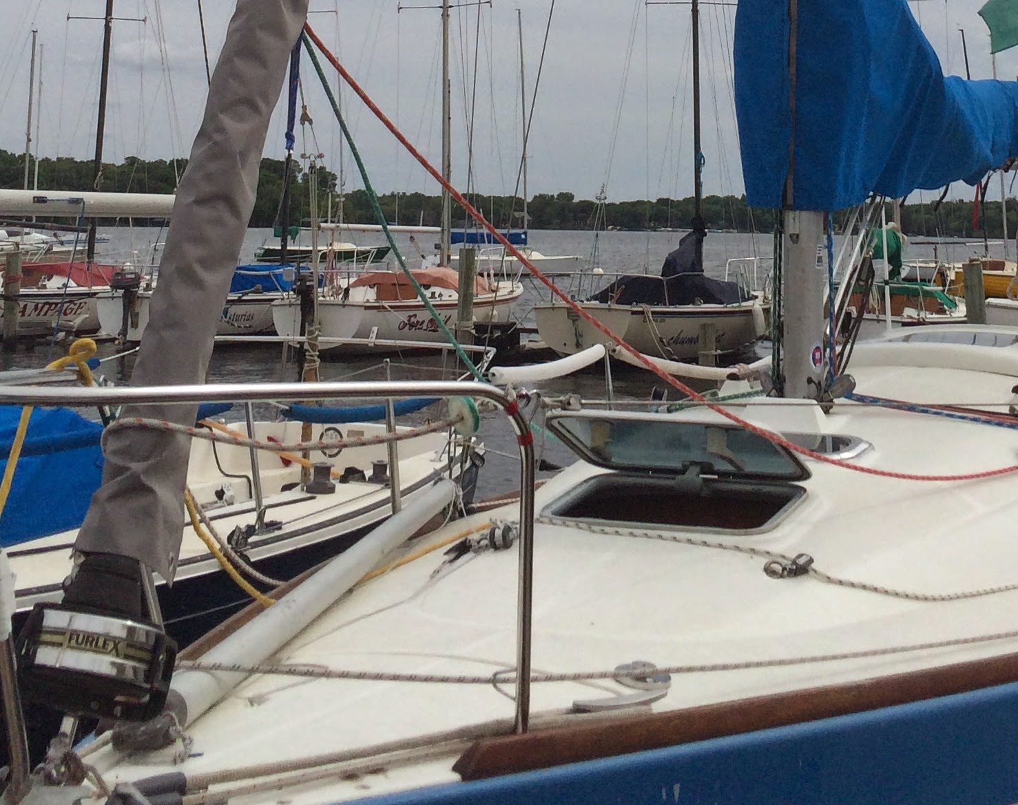

Looks kinda like this. The good ones will have intertwined drawstrings running the length that keep the thing from flapping in the breeze.

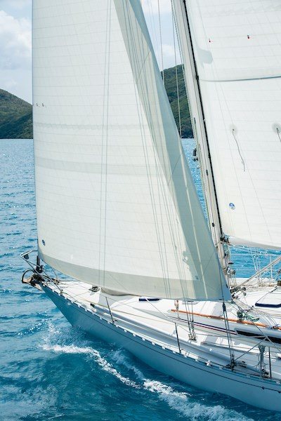

Jackdaw, I see by your picture earlier in this thread that your foresail has a very different cut (panel layout) than mine or the other boat in the photo. I think yours is a mitre cut and I am looking for input on this topic. The sail I am considering is a direct replacement of mine in either a dacron or cruising laminate from Neil Pryde but I have not considered the cut of the sail. Any input on this element?
Nov 8, 2010
11,386

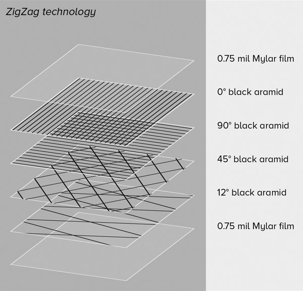

Laminated sailcloth is usual much stronger (by design) in one direction than the other, and is usually designed with narrow semi-rectangular panels that place the laminate along this loadpath, aka the direction of the load on the sails, which emanate from the corners.
Regular dacron sailcloth is not much better one way or the other, so this does not matter. Therefore, dacron sails are normally cut 'broadseamed' in large panels that minimize cutting and sewing.

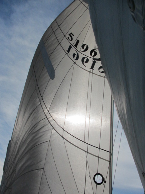

This is a laminate by Ullman, this pic shows the directionality (how's that for vocabulary) of the material and the way panels are oriented. I need to add about 18" of jib track to properly use and trim this beast, but for now it's an advantage at 10kts. and under of breeze. I use an ATN jib sleeve for UV protection, people I sail with use the same set-up, only takes a couple minutes to get the sleeve on or off and I prefer it to the weight of a Sunbrella sunband.
