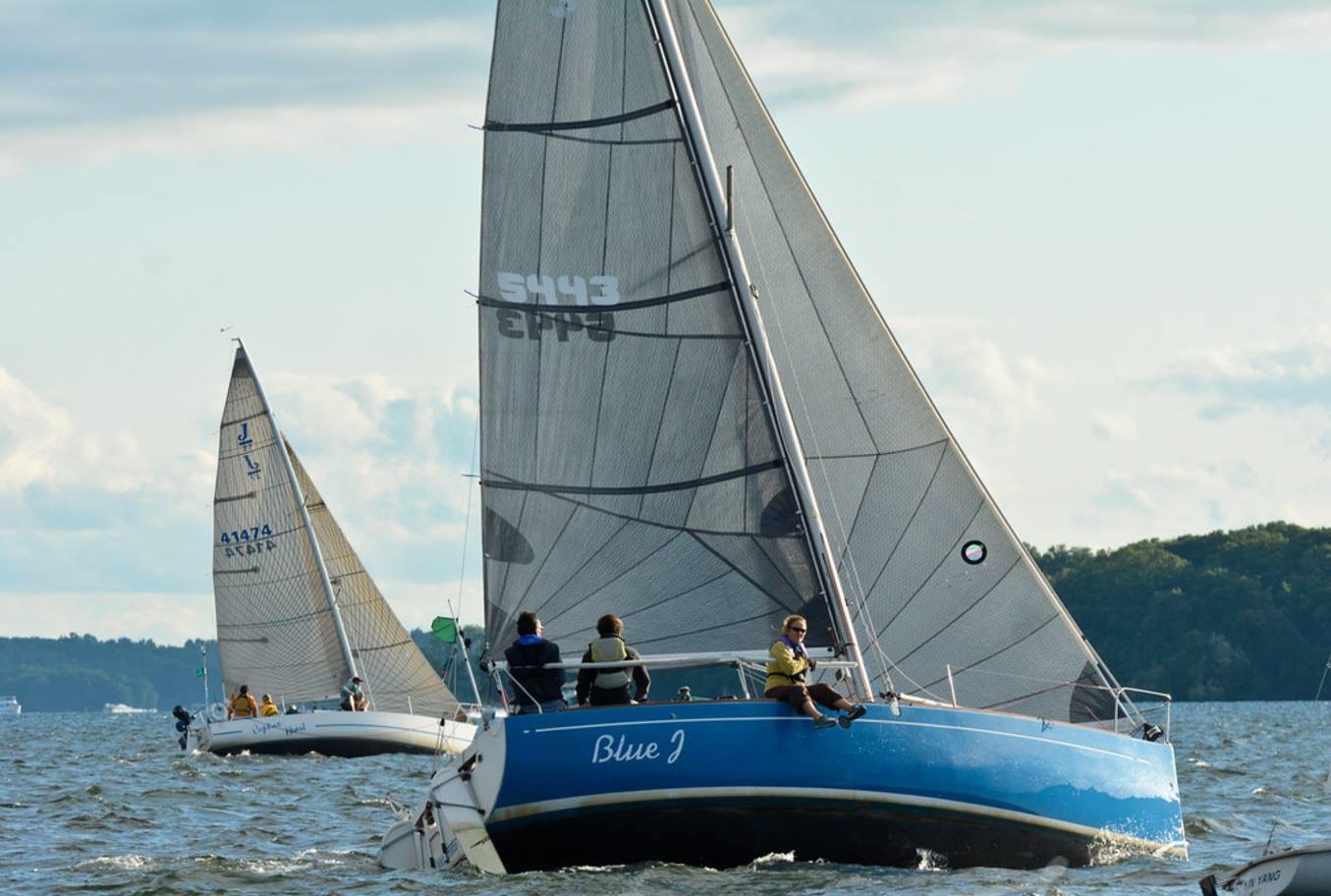

Some very high-tech One Design race boats have furlers as standard - The new J/121, Class 40, and the Volvo and Vendee boats to name some.

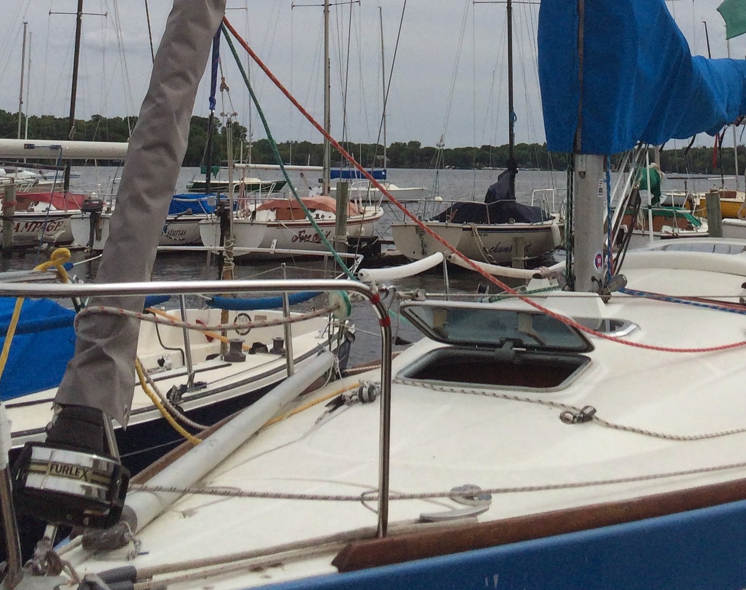

Clay: Good to know! And to see in your pic. And tell me about this "jib sock".
24,582
JRacer... A JibSock is a cover that you pull to the top of your furled fore sail. It covers the fore sail. You can use any mast halyard that will pull up along the forestay (i.e. the Spinnaker halyard) and is as tall the forestay.
As you pull the sock up you close the sock around the foresail. set it snug to the base of the sail and you have a cover for your foresail. Works great with a mast head rig. Can work with the fractional rig as long as you have a halyard that you can rig. Material is generally Sunbrella to give you UV protection. The advantage is when you remove the sock there is no additional material or weight to affect the sail for racing.
Nov 8, 2010
11,386
Looks kinda like this. The good ones will have intertwined drawstrings running the length that keep the thing from flapping in the breeze.

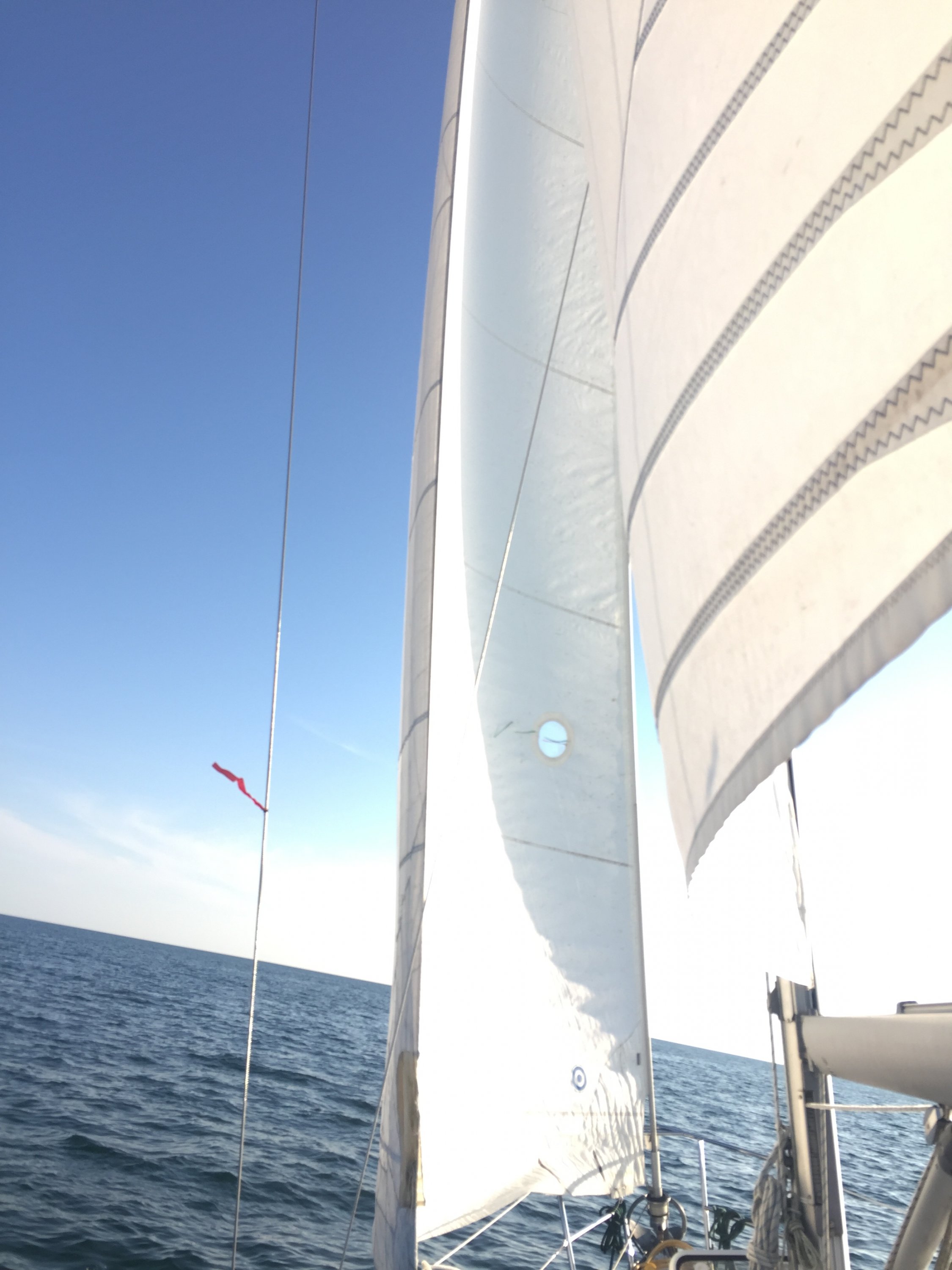

Comments on the condition of my current jib? 115 furler measuring exactly what the manual says it should and trimming with the jib leads positioned as the manual says though the angle of the sheet is nowhere near what conventional wisdom says it should be. Placed per the manual, the sheet lead causes the angle of the sheet to be way above the middle of the luff, I am guessing it would intersect 10% of the way down. Set here the telltales break evenly.
pateco
Aug 12, 2014
2,207
Based on the pic in those conditions, I think the Jib car should be farther back. (Waiting for Jackdaw to tell me if I am correct?)

Hard to say; you are not trimmed for upwind sailing that in that picture. The 'sheet bisecting the sail' is really written for that mode. Off the wind, you want all the telltales to fly, and you move the car based on lots of conditions.
When in upwind trim, forget what any 'manual' says where the car should be, and set it first so the sheet does bisect the sail. If you get a chance, mark your clew with a sharpie or tape line to show it. Then adjust (an inch at a time) to get the telltales to fly correctly. Then mark this as a default location on the track. Note that them flying will also be effected by wind shear, gradient and velocity; so there is no fixed position! That's why remotely adjustable cars are so nice. Ours get moved as much as our traveler.
