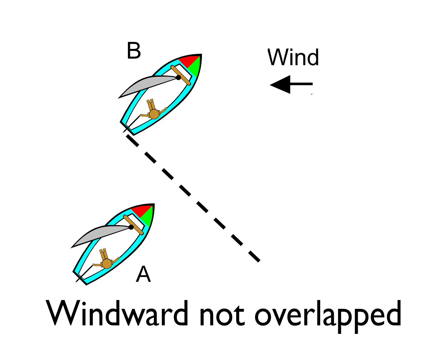

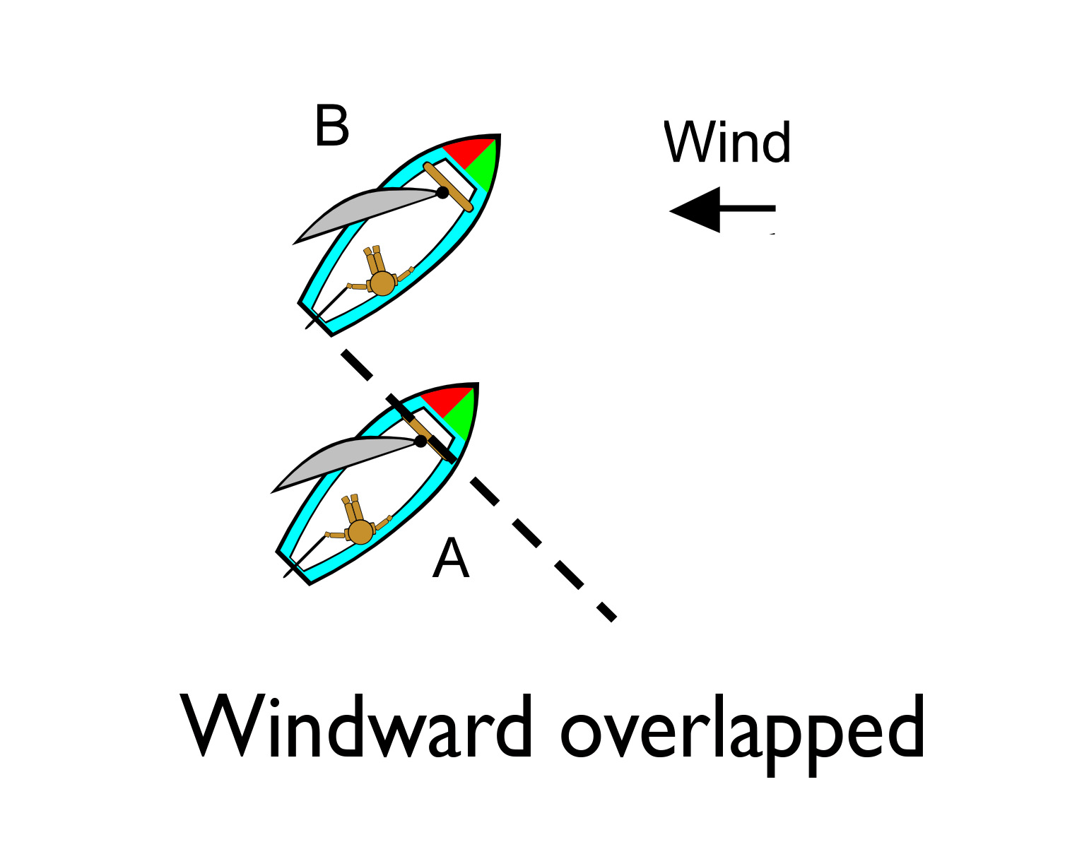

Two scenarios - both boats on same tack, not overlapped and overlapped.
Per rules 11 and 12, in both instances, the windward boat (boat A) must keep clear. Easy enough when they are not overlapped, boat A just has to be prepared to come about if boat B decides to. If overlapped, boat A still is obligated to keep clear, but if boat B were to come about, it could result in a collision.
So, when overlapped, boat A's keep clear responsibility would include staying far enough away that boat B could come about with risking imminent collision.
Correct, although for different reasons. When overlapped A must keep clear because she’s overlapped and windward (Rule 11). When not overlapped A must keep clear because she’s behind B (Rule 12), regardless of who is to windward.
Not exactly. A must keep clear of B, but B can’t change course so fast that A doesn’t have room to keep clear (Rule 16.1). So, A does not need to stay far enough away that B could turn at any time. A just needs to allow B to steer a straight line, and turn immediately to keep clear if B comes up. If B continues to tack she also has no rights at all from the time she passes head to wind until she’s on her new close-hauled course (Rule 13). Essentially that means B can’t force room to tack there, unless she’s hailing about an obstruction (Rule 19).

OK, so in theory boat A, if overlapped, could in effect prevent boat B from tacking as long as it stays clear enough that if boat B were able to sail closer to the wind on that tack that they could do so without colliding with boat A. Is this correct?
If so, it would seem that once overlapped and so close that tacking would result in a collision, boat B's only option if they want to tack is to slow down and come clear astern of boat A before tacking. Is this correct?
Correct. B can luff as far as head to wind (slowly enough that A has time to respond). A must continue to keep clear. But B can’t actually pass head to wind and complete the tack unless there’s room for her to do so without contact or causing A to tack.
B’s options are indeed pretty limited. She could scrub speed like you said. Probably a better option is to bear off and open up the gap until she has room to tack. She’ll probably still need to duck A, but at least she’ll be just below A’s stern and carrying good speed, instead of struggling to recover from a down-speed tack. If you modify your scenario and put A and B on port tack there’s the possibility of another option, especially in a crowded fleet. B could wait for a starboard tack boat to approach with rights. The starboard boat would be an obstruction and B could hail for room to tack. A would need to respond either by tacking away or hailing “you tack” and ensuring to avoid B while she tacks. That’s probably the higher risk option though as it adds more commotion to the mix.
In this diagram, both A & B are both on Stbd tack so B would be waiting a long time for a boat that could cause an obstruction! ;) (I was also thrown at first by the wind coming from the right side of the drawing, when traditionally we see it coming from the top down!) This seems like a very sticky situation that doesn't occur very often. It seems that A could chase B way past a lay line if he was so inclined to disrupt B's progress during a race. Not to mention that if B were to tack, as soon as he passes head to wind, he will be on port tack. So what is the best course of action for B?
I'd suggest that perhaps a very quick 270 degree jibe might be one answer. It might be the fastest way to clear A's stern. I've never practiced such a maneuver for the purpose of seeing if it can be done quickly. The sails are already close hauled, so there may not be very much preparation necessary. I've done it casually, just for the sake of jibing while still sailing upwind. I wonder if there is any record of anybody using such a maneuver to get out of jail, so to speak!

In the first sketch, how is boat A to windward?
Thanks for pointing out that inaccuracy. In fact, boat A is clear astern in the first sketch. It is not until it is overlapped with boat B that it can be considered to windward. Learning as I go along...
Sorta kinda... A boat can be to windward of another while still being clear astern (or clear ahead) of the other boat. A boat can be to leeward of another without being overlapped too.

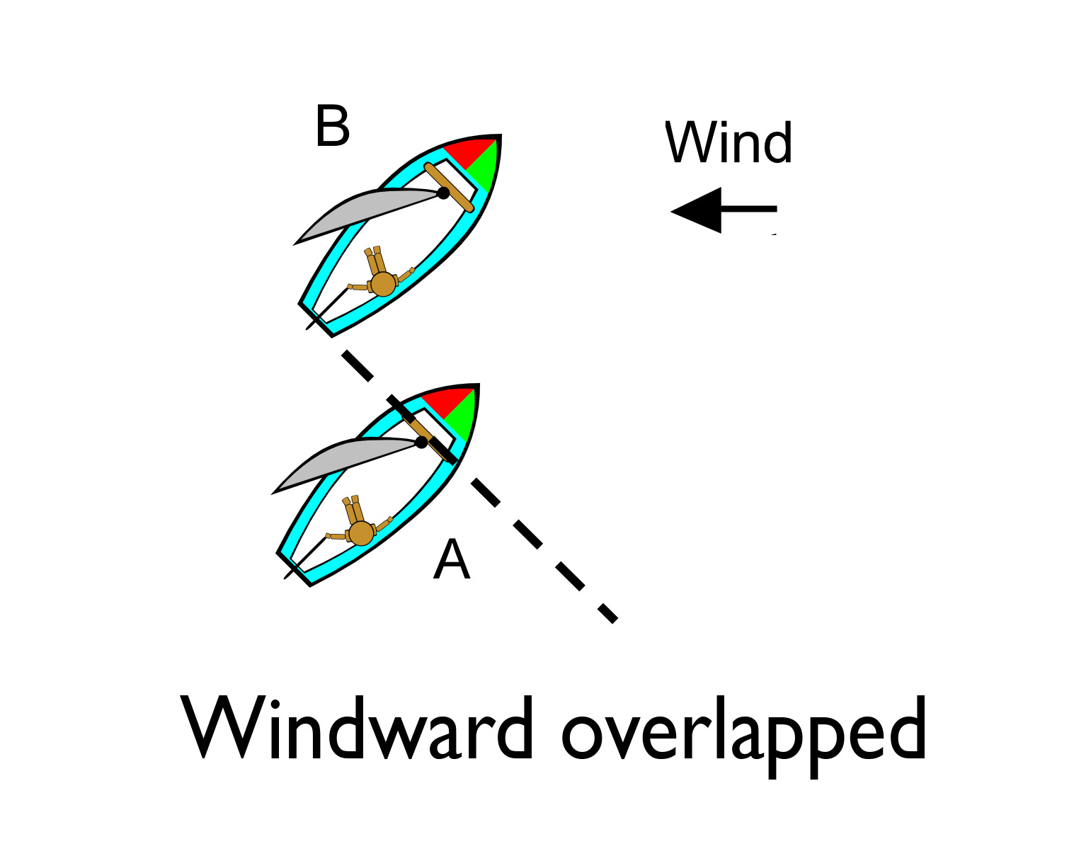

Please let me know if anything I have said is incorrect, and offer any commentary or advice you feel is appropriate.
Thanks!
The leeward boat could not tack here as they would immediately be in a port starboard situation and lose right of way.

rule 13, while tacking....after a boat passes head to wind, she shall keep clear of other boats until she is on a close-hauled course. During that time rules 10, 11, and 12 do not apply. If two boats are subject to this rule at the same time, the one on the other's port side or the one astern shall keep clear.
