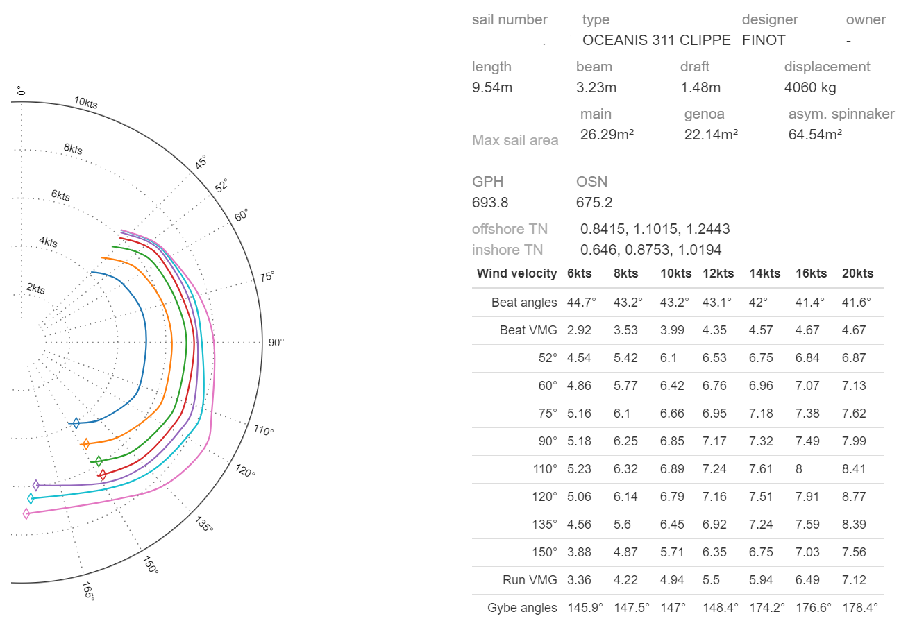

Jackdaw,
With my genoa track arrangement, it looks like the sheet lead angles would be about the same for the standard 116% jib and the proposed 142% genoa, 14-15 degrees or so, so equally bad with both sails. In light winds the larger sail might actually do a little better because the faster speed would help reduce leeway for this boat with a smaller keel surface area. That polar diagram you posted shows pretty tight tacking angles for a cruising boat, but I can't see how it's possible with such a wide sheeting angle. The tacking angles at 10-12 knots works out to about 30 deg apparent, which I think are fairly standard on boats with 8 deg sheeting angles. The speeds and angles otherwise look plausible.

Jackdaw,
Remember that if your sail must go around your shrouds, THAT shroud point determines your headsails AOA. Your jib track is several feet inboard. That makes for a tighter AOA and better pointing. I agree (by a quick look) that your tracks give about a 13 degree sheeting angle. Remember that polars do NOT factor where the tracks are, and they assume optimal trim. As a general rule for boats with non-overlapping rigs, if the tracks are BELOW the cabin windows, you need inhaulers to hit your angles.
The opposite is also true; if the tracks are ABOVE the window (like on BlueJ) we point fine but need out-haulers the second we crack off more than 10 degrees.
