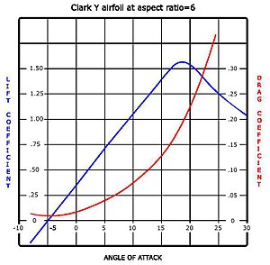

A pilot with a stalled airfoil would probably not agree that 95% of his lift is still being generated (as he falls from the sky). Airfoils, by their design, are unlike blocks. They use the shape of their upper / leeward side to generate significant lift. When the airflow over that side separates the reduction of lift is dramatic.
Here’s an interesting picture from the Wikipedia page on airfoils:
Notice that even when the angle of attack is 0, meaning no downward deflection from the lower side of the wing, lift is being produced.

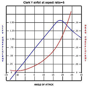

Which suggests a discussion of fishtail rudders.
Foils deflect fluid. If the flow is attached on both sides, they both work. If the flow detaches, only the windward side works (that blue line will only drop to about 50% of the attached flow values).
If you add flaps to a wing or rudder, a foil will deflect more fluid, particularly when stalling. If the back side is stalled, the fish tail "flap" does not actually harm the lift, because it is in the separation bubble (eddy).
Thus, fish tail rudders are often speced for ships that need very high angle of attack for maneuvering. Lots of research can be found. Most trawlers would benefit. Some sailboats would benefit under power, depending on the keel-rudder configuration.
[The flow acceleration thing was written by the marketing department and is complete nonsense, but several German associations and universities did the basic research, and the high angle lift plots make sence.]
