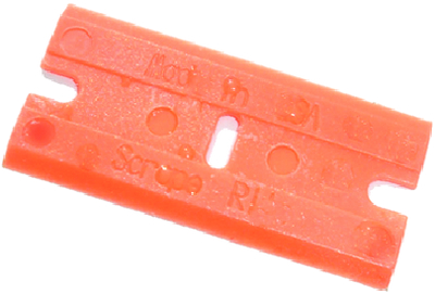

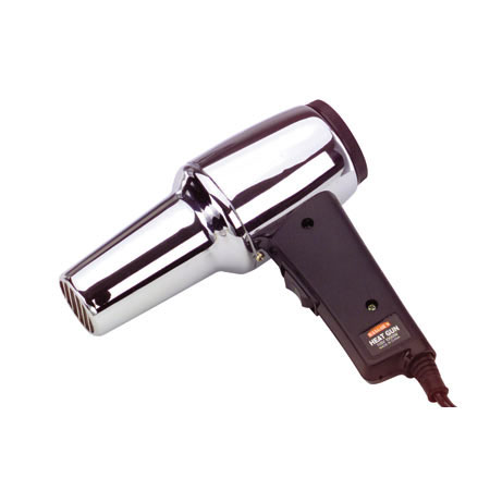

A combination of the there products below works great.
