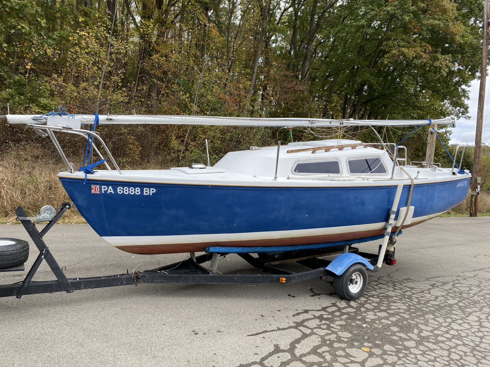

2. In the photo below you can tell that there is a white strip in between the bottom of the boat (red) and the topside (blue). I want to paint over that. Do I bring up the bottom paint to that or bring down the blue paint to it?
Fielder's Choice on that. If the boat is heavier than design weight the waterline will be higher. Perhaps split the difference.

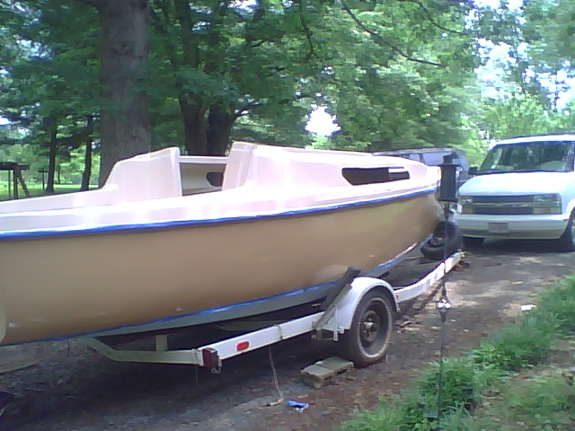

I did a similar restoration on a Mac 22. Like @jssailem said... I'd remove all of the hardware before painting. Rebed all hardware with butyl tape. Fill in any holes you don't need anymore and I'd recommend you bring the bottom paint up instead of the topsides down.
Here is are some pics of my Mac 22 before I reinstalled all of the hardware.... and a before shot
