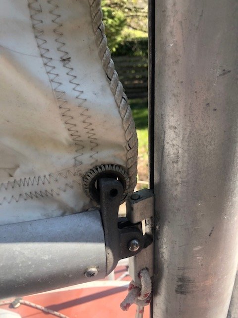

Hey Ho. sorry to barge in here... long time reader, first time typer.
I need help, just bought a Catalina 22 (1974), shes a beaut but i have a couple of minor pins and things i am sourcing... im stumped on the name of the shackle/pin thing that would secure my main tack grommet to the boom. ive attahed a picture... ive ordered a couple of items on Catalina direct but havent a clue what the thingy is called to secure this badboy. Anyone have any idea of what i need here?
Much obliged.
HotPotato.

I'd use a SS bolt.

"Mainsail tack pin for gooseneck " .
It has a slight bend in it to be installed/removed without tools.
Catalina direct has em or if you're crafty you can make your own from the proper sized bolt.

Here's the CD link, with a picture to make it clear.
