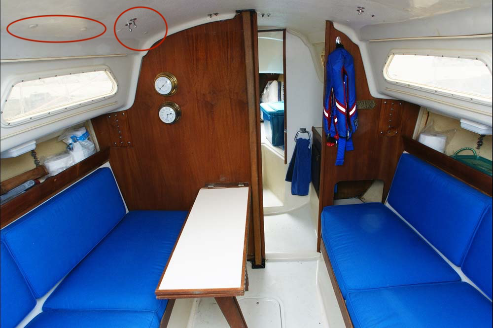

Looking at that photo you referenced, but not of your specific boat, I would say that boat has no liner, and we are looking at finished fiberglass. The main reason I say that is that the deck fittings are thru-bolted through it. On my boat, with a rigid liner, there are holes in the liner to access the nuts on the thru-bolts.
However, where the bulkheads are held in place it looks a lot like my liner.
So, your only option may be to drill a core sample and know for sure.
These are likely after market installed by a prior owner. The tell is the length of the bolts on the port side. No builder would leave those long bolts like that, they would be trimmed and covered with cap nuts (which they do have). If you look closely you will see several plastic plugs in the headliner probably for the handrail on the cabin top.
You could be right Dave.
I can confirm that those caps are for handrails as my boat had the same ones. I agree that the bolts are likely installed by a PO

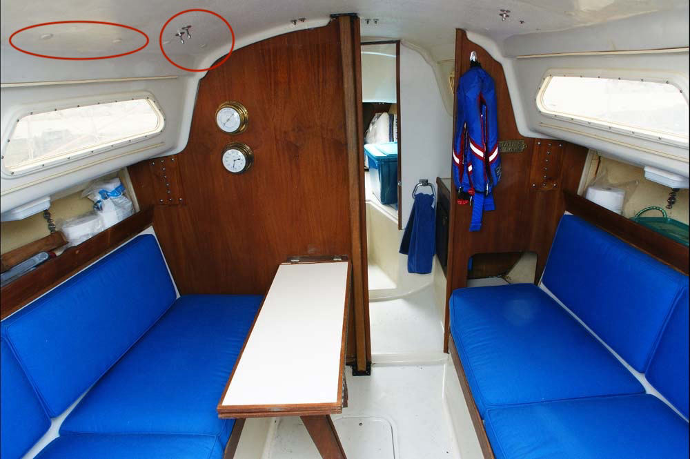

Looking at some O’Day 27 images (this one from a 1978 O’Day 27) show what appears to be to be a solid interior fiberglass ceiling to the salon.
Let us not confuse the situation.
Dave annotated the image I posted in # 11. This image is not the OP's boat. It is just an image of an O'Day 27 manufactured in the approximate timeframe identified by the OP, as I noted above in my post. The OP posted an exterior photo of his boat (post # 1).
You may ask why I posted an image, so the OP could use it to compare his boat with the image and see if we are understanding the same issue. I wanted to reduce the confusion that appeared to be happening.
