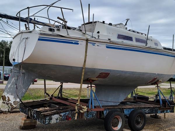

My boat below. Don't laugh. I wanted a sailboat and this one came up. They had to move it and I got the boat and trailer for $500. Better me have it than to have it cut up in the land fill. I pounded around a little on the roof and it seems fine. I assume it will have a little rot somewhere. Maybe by the stanchions but I don't know that yet. It will likely take me a long time to do this but it's something to really look forward to sailing around.
BTW some parts I'm going to let go. I don't want to go into detail because you're not supposed to sell here but it seems to me the classified is all boats and not specific Oday so I'll straddle the line and hope it's not troublesome. If this is offensive, my humble apologies.

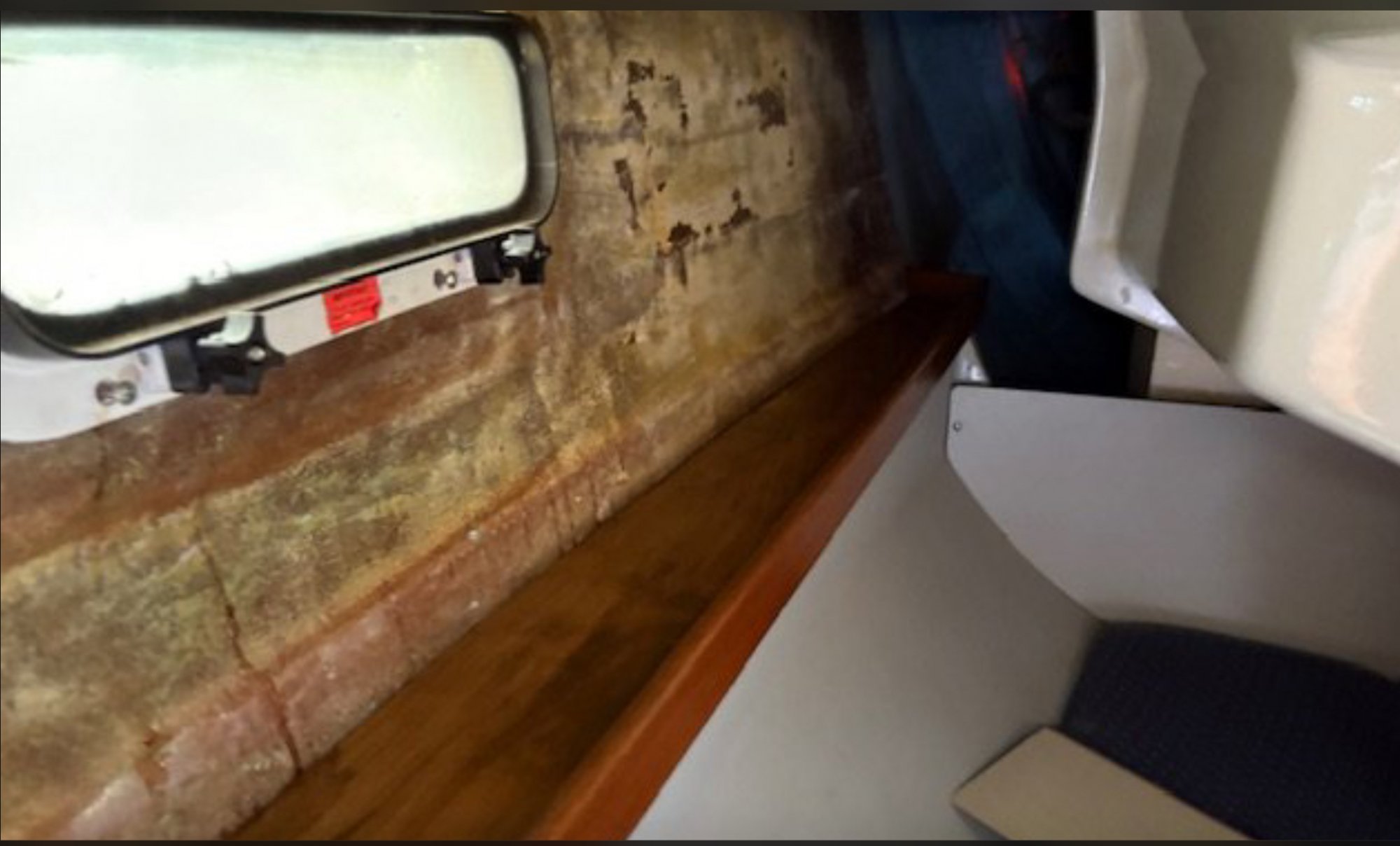

Carpet can be pulled down (it is glued on). Here I removed the “carpet” liner from the hull in my aft berth…that is the unfinished fiberglass hull. And you can see the fiberglass liner on the lower part of the hull (Below the teak shelf).

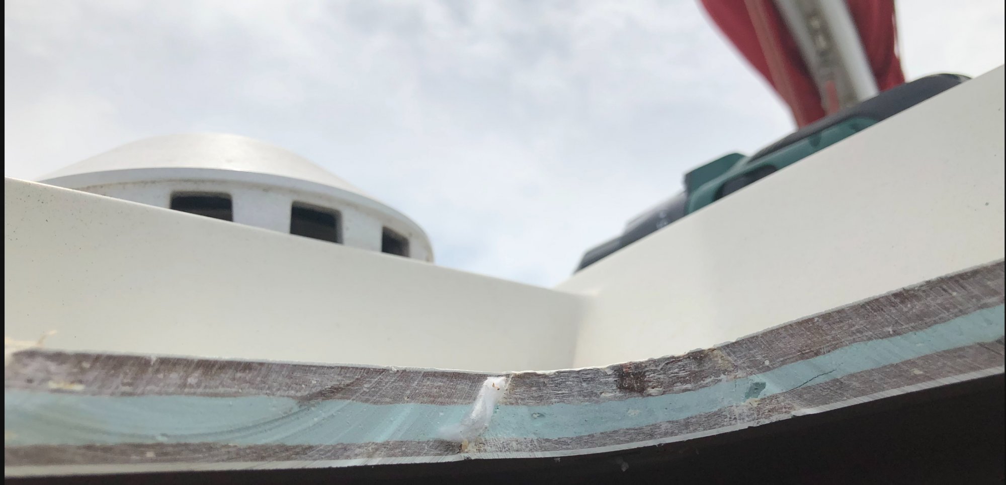

My O’Day 322 has some foam core around the hatches…I found this when I pulled the main hatch out to rebed it…
This photo helps explain the sandwich construction. You can see the fiberglass liner (very thin) at the bottom, then a layer of fiberglass, a layer of foam (the green layer) and then the top fiberglass layer.

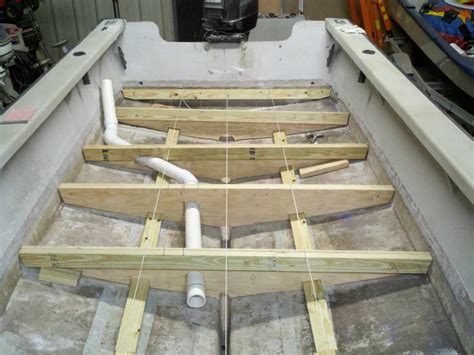

First you might want to understand the way and why your boat was designed. At a basic level is a hull structure that functions as a skin over a skeleton.
In this image the skeleton are the wooden stringers holding the hull skin in shape.
Your O’Day uses some fiberglass ribs attached to the interior of the hull then an interior liner is secured over the hull. This provides strength and interior design function. To the liner are fitted bulkheads and decorative wood / cushions / coverings.
