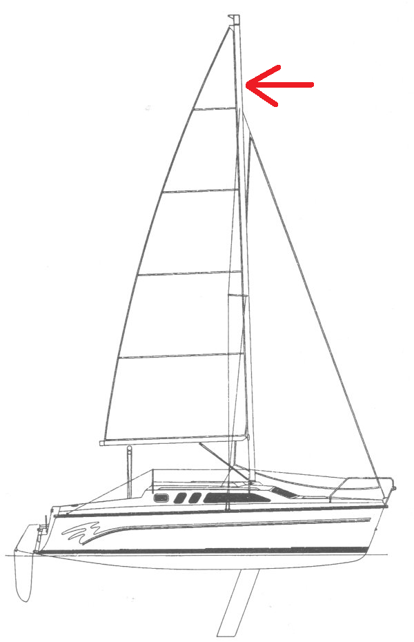

This ad got me thinking, why do you almost never see a radar dome on the smaller pocket cruisers. I do a lot of coastal cruising (plan to do a lot more in the near future) and I have been caught out in fog. I would have loved to have had radar in those conditions.
So here are two basic questions.
1) Why don't you see more RADAR on smaller cruising boats
- Does the dome add to much weight aloft? (you could put it on a pole on the stern)
- Do they draw too much power ( I think I know the answer to this already [ ~25W])
- Other reasons?
and...
2) If you have Radar on your smaller boat...
- Where did you mount it?
- Why did you want it?
-What model did you go with and do you like it?
It seems to me that for the fractional rigged Hunter 26, a dome would make sense....right about here...

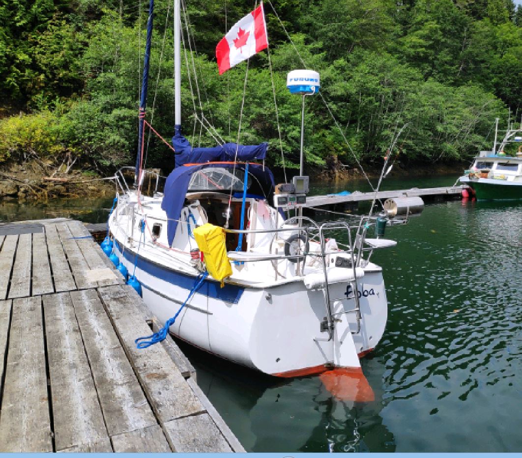

My Seaward's radar is ancient, bought new with the boat in 2000. It is a Furuno 1622 with a neat small dome. Works fine and is useful. The dome is mounted 7' above the cockpit sole, clear of the boom (good idea!), on the helm binnacle.
