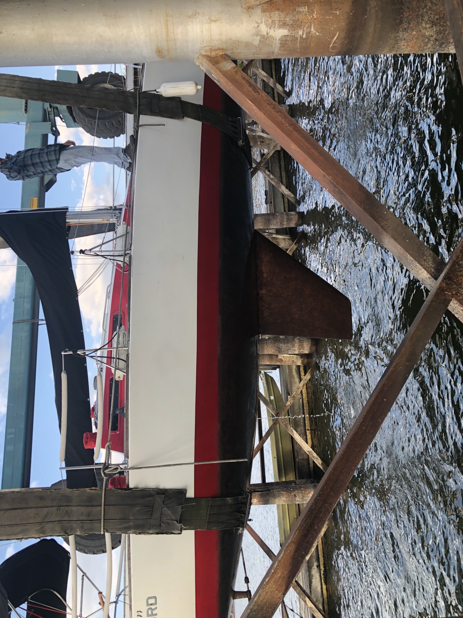

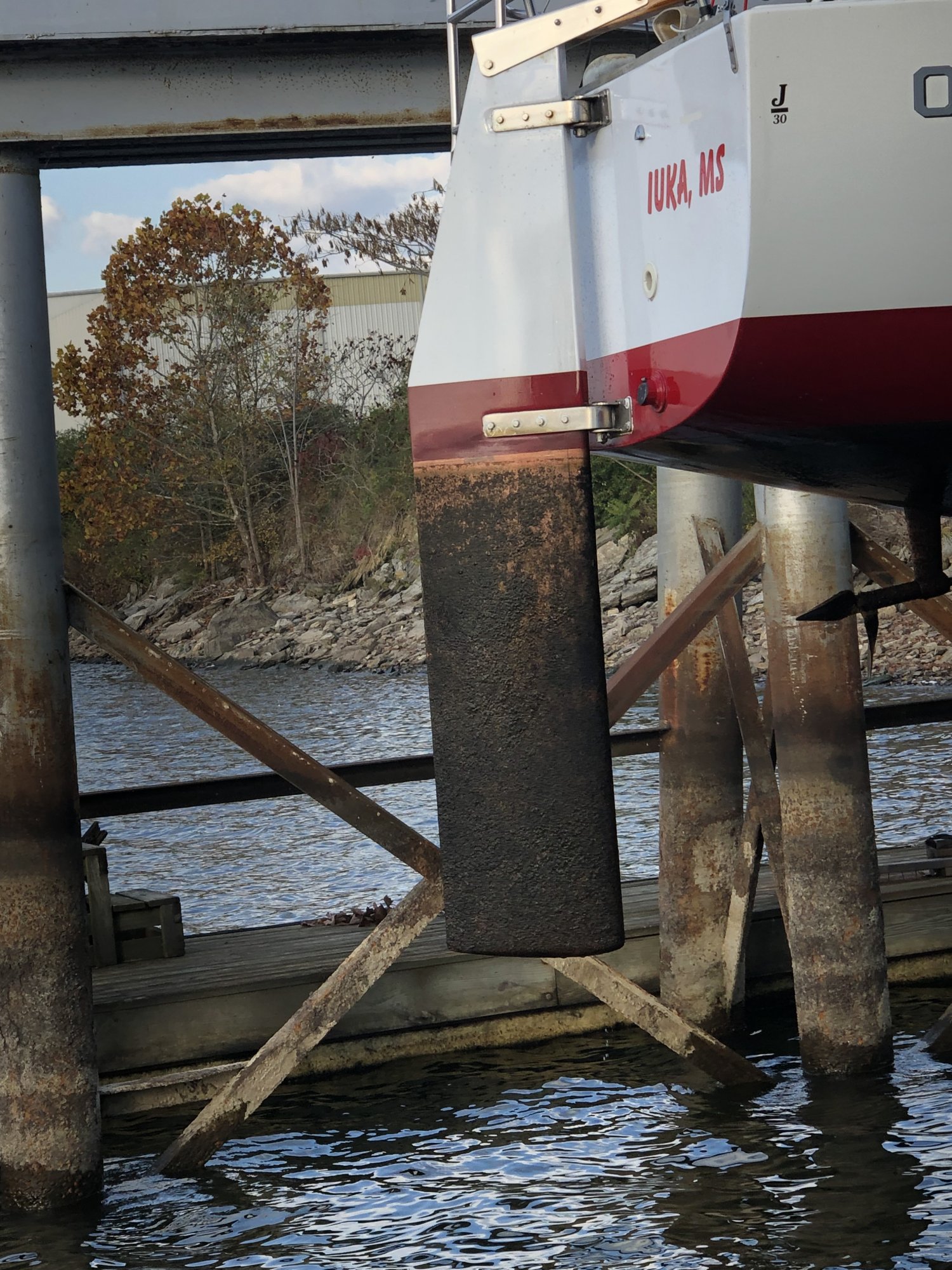

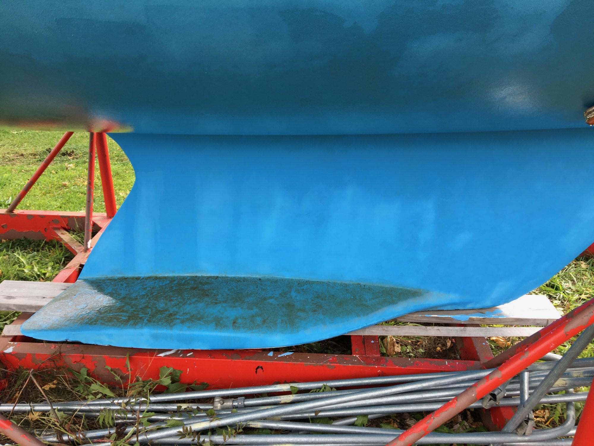

Good information. I good visually see slime growth 1 month after the last bottom job with the bottom kote racing bronze. I was horrified. But it was on the hard 30 days before launch. So brushed every two weeks. I would brush it until I couldn’t see debris coming loose. But, when I pulled it 2 years later after continuous brushing, I couldn’t believe what I saw. So, needed to do something different, switched to ablative. I sail about 15 times a year, about 4 hours each time. I think I will pull it this summer again and check it.
13,527
Sunlight is your enemy. Transom hung rudders are the worst for bottom growth because they get lots of sun. There is no bottom paint that will prevent this. The side of the boat away from the dock will always have more growth than the dock side. On my boat, the top of the wings on the keel will get growth even when the rest of the keel is pretty clean. Likewise there is usually more growth right at the waterline.

You should note you sail in Fresh Water, In Iuka, Mississippi.
Different bottom paints needed.
_________
Nope. Water Temperatures are cold there. Slime loves to grow any where.
Without Sunlight, no winds. Sailing often is your friend.
Ask houseboat owners on the Pickwick Lake what they use.
Jim...
PS: You bottom does not look too bad.
