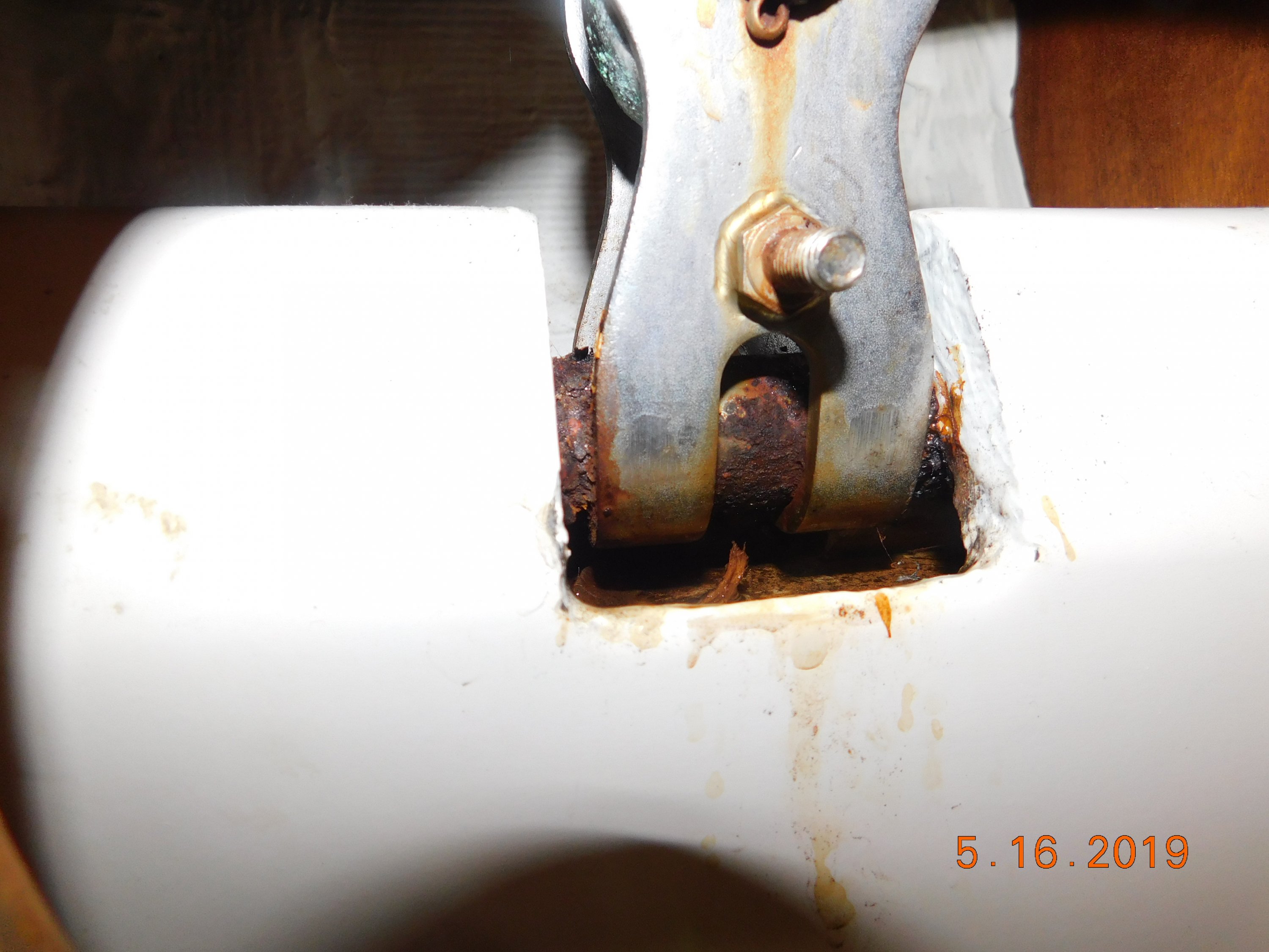

Hi Mechone, quite right that the leak must have been there for a long time, but the corroded part is the horizontal bar embedded in the glass at the bottom. Looks like it is impossible to replace without a major repair, see link to photo:

Wow that's nasty, make sure the deck hasn't gone soft around the chain plate also. Anything with glass is repairable ,looks like it needs to be cut out replaced with new 316 That is the strongest part of the hull where the matrix is glassed to the hull ,everywhere else it's glued. Bring your wallet and have it done by a good shop, like I said earlier anything can be repaired with glass in fact made stronger than factory Kevlar / Carbon fiber Matt more bridging of the glass etc ...good luck

Thanks Bluenose, running my finger on the surface on the bottom left and right caused flakes of rust to come off. Seems to have penetrated quite a bit

It is hard to tell from the picture how much space/access you have at the fore/aft "ends" of that fiberglass, but if it were me, I'd try drilling a hole at both fore and aft ends, just a bit larger than the diameter of that rod, such that (after you take tension off the shrouds/chainplate) you could tap the rod out from one end. Even beyond that rod, I'd inspect the rest of the attached hardware there as well, replacing anything else suspect under the "while I'm in there" approach. Presumably you've inspected the rest of the chainplates on your boat and they're not all in similar condition. Besides the obvious suggestion of fixing the leak/source, I'd also see if I could figure out where else the water went (downstream) from there... presumably into the bilge, but did it pool/corrode anywhere else along its journey? Electrical connections? Keel bolts? wherever it went before leaving the boat. It should be easy enough to follow the trail of rust it would have left behind. Good luck!

Flakes of rust would be OK, may not impact the structure. Disassemble and investigate further, may not be as bad as you think.

It appears the stainless piece is around a non stainless rod or bar. That does not look right. Perhaps a previous owner inserted a non stainless piece doing a repair. If this is structural it will require repair.
Sounds like your in the middle of a purchase. Your Survey should be enlightening. It might be a boat to walk away from.
Does not look like a Beneteau manufacturer repair to me.
I agree. Stainless may get crevice corrosion and ooze some rust, but that looks like all out rusting of a more mild steel. My guess is it's not OEM and should be replaced. Of course, once you have it out cleaning or replacing are the easy parts - it's getting it out that seems to be your problem, and for that I don't have an answer.

I just looked at mine it is not that big of a job .Remove the chainplate and attaching hardware off the pin.
The Glass is very thick on top where the load would be and very thin underneath. Use a dremel with a flex attachment and a sanding drum. Grind the bottom of the thin epoxy coating(its not glass)underneath ,then hit the pin straight down and it will come out .Feel the under side of the pin and you will know what im talking about. Put new pin in ,mix up some thickened epoxy ,hold the pin up and epoxy back in

Thanks Mechone - so the pin is smaller than that support so it can be maneuvered out of that hole?
