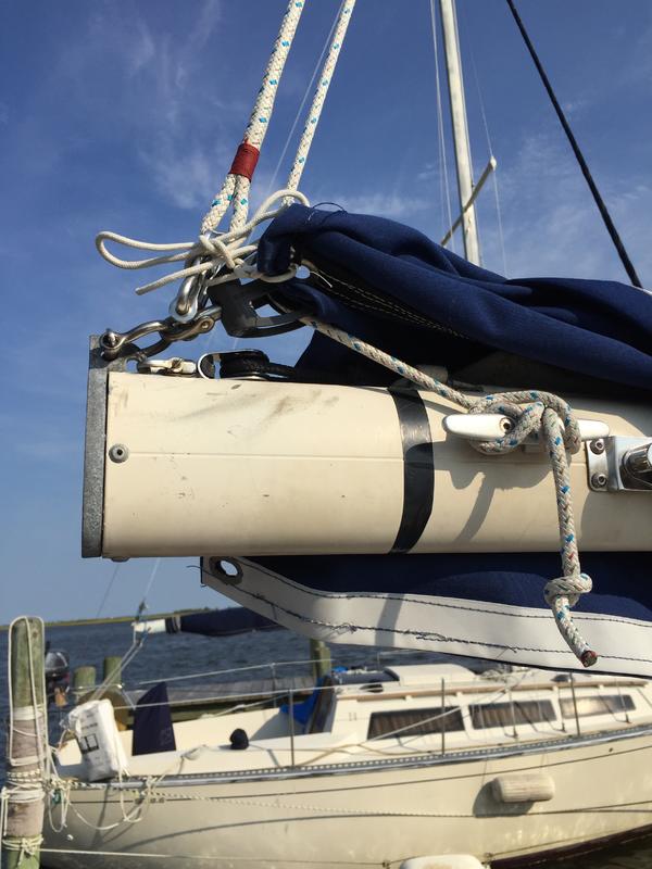

mine had a cleat on the rear starboard side of the boom and i changed that with a cam cleat and fairlead mounted on the end of the boom ...i have a three part line revved up to two single blocks attached to the topping lift 1/8 cable to raise and lower the boom and cleat it where i want it to be i have end boom sheeting on a six part line with a ratchet block and cam cleat if this info helps

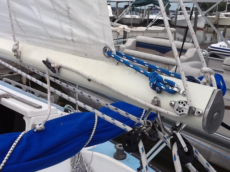

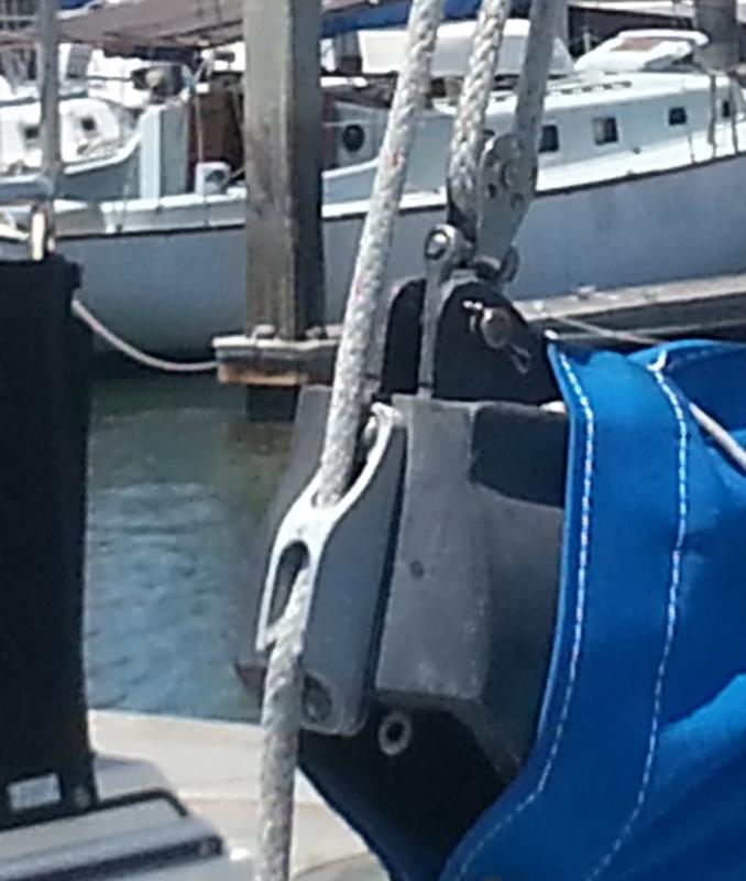

Here is a better view of the problem. The out haul strap will go around the boom between the black stripe and the cheek block for the clew reef line. The cleat will be in the way.
Maybe just moving the cleat to between the end cap and stripe will work.

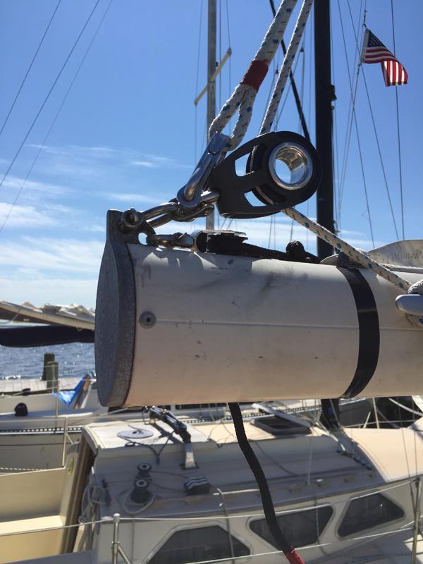

This was a concern of mine when I did the cam-cleat mod for my topping lift attachment/adjustment at the boom end. Here are pictures of my current arrangement. I pull down on the line between the cam cleat's jaws on the starboard side of the boom, then route the line under the boom and tie off on the cleat mounted on the port side. You probably will think of something else!

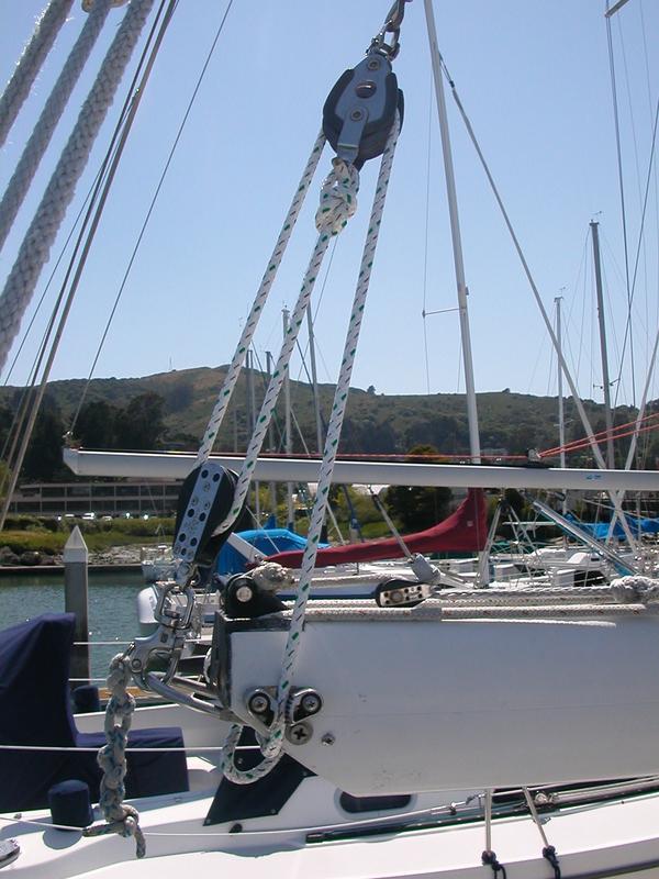

Add a cheek block to your boom and keep the cleat. Bad use of a cam cleat, if it pops open when the sail is down, the boom could hit you on the head. My topping lift line is fed through the center of the cleat and has a stopper knot at the end, even if it would come uncleated, the knot will jam and keep the boom from falling. I also have a knot in the line for the preferred sail up position.
Joe
Jun 1, 2004
8,346

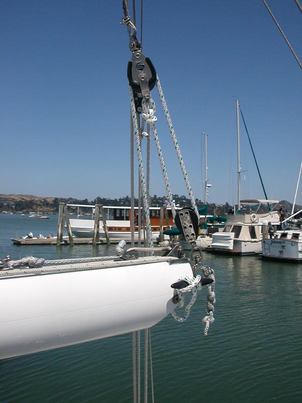

Ward, if you re rig it this way you will remove the clutter around the clew. When I had a topping lift it was rigged in a similar way. The topping lift would terminate a foot or two above the boom with a small bullet block at the end. The control line is anchored to an eye strap on one side, run up through the TL block and back down to a cheek block on the other side.. similar to the "THECUSCUS" pic. Then mount a vee or clam cleat with fairlead a few feet in front of the cheek block. Running the cleat nearer the middle of the boom will enable you to adjust the TL from the cockpit in most instances, except when the boom is all the way out.
The control line can be smaller diameter... 5/16 or 1/4 " is more than enough... there will be no cumbersome block in the way such as you have it now. You can still tie off your halyard as usual.
The whole idea is to get that big block you have there now out of the way... A cam cleat takes up a lot of room and may not fit properly or look appropriate on a curved boom... but it you do really want it.. think about the smallest one, or get one of those nifty spinlock snap cleats. Instead, though, I would consider this type:

So many different end caps on the booms it really frees up the options. Mine is loaded up with four turning blocks. One for each of the outhaul, two reefs, and the topping lift. Add the stack pack and there is a bit of clutter at that end.
Ward the block that looks to be rubbing the shackle at the end of the boom could be A problem. Some of the other comments show a cleaner set-up plus 3:1 advantage. I'm not a fan of metal on metal because they rattle and squeak when one drops the hook unless overly tightened. Sometimes it is unavoidable to have just one shackle, That's where a soft shackle would be a fine solution.
