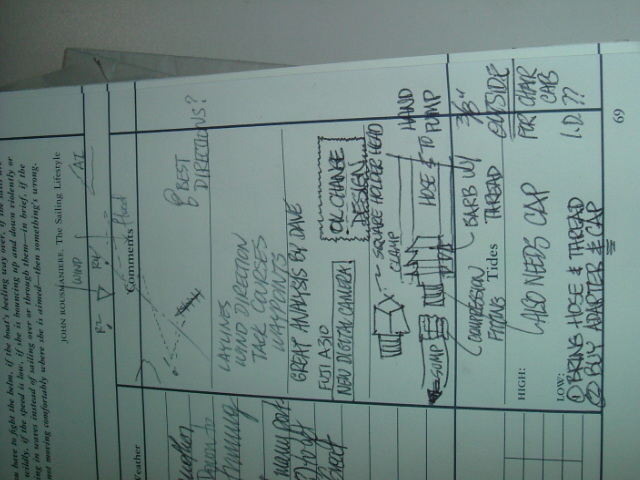

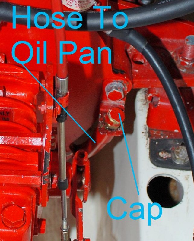

I built a connector from the oil drain hose to the hand pump I use for oil changes. See the picture.
Instead of Ron's electric pump (see below), I use a simple Par Jabsco hand pump.

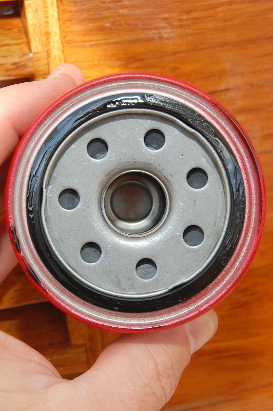

hoses so they don't leak. As far as removal of the oil filter, I
unscrew the oil filter until it is just loose. Then I drill a hole on
the out board topside of the filter and I mark the port side of the
filter with a marker. Then I take a medium size empty coffee can, hold
it under the filter, unscrew the filter so the mark is at the bottom and
then drill another hole in the top side of the filter. This allows all
the oil in the filter to drain into the coffee can. I previously had

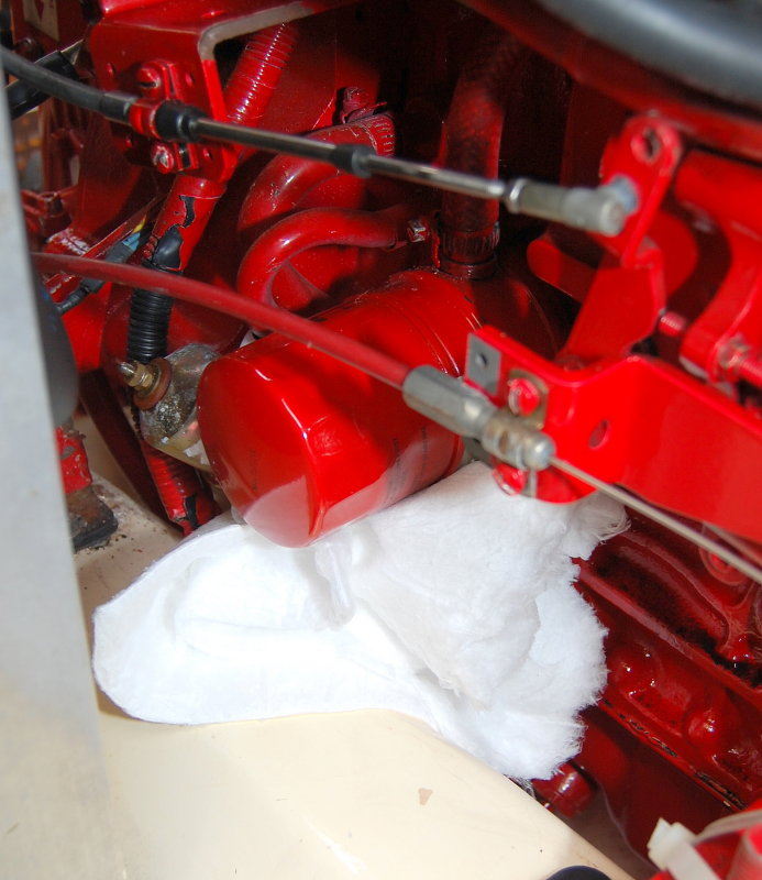

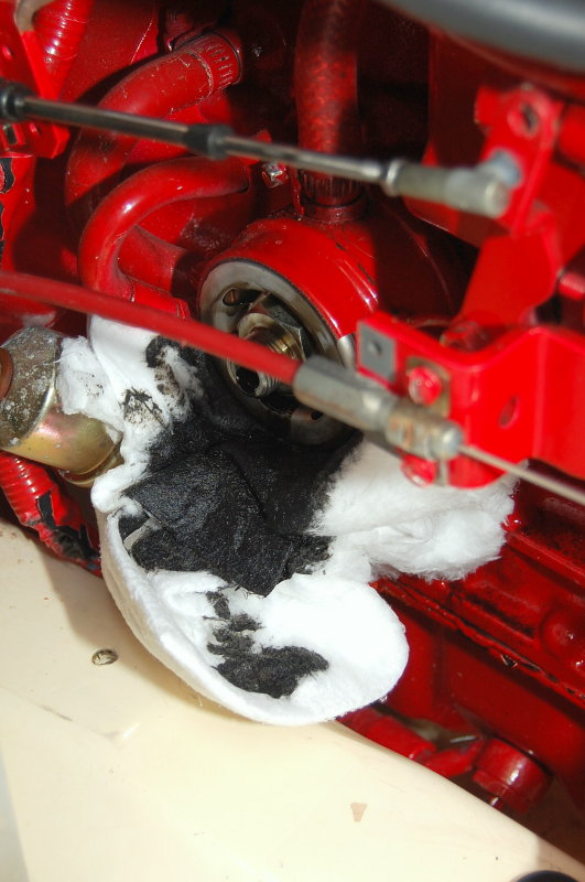

stuffed a number of paper towels underneath the area where the filter
joins the engine. When the oil stops dripping from the filter, I
unscrew the filter, let it fall into the coffee can, clean up with the
paper towels, put the dirty paper towels in the coffee can, put the cap
on and dispose. There are no dirty gloves involved and no mess.
