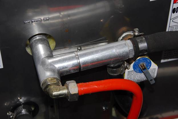

Here's why I'm asking... my old tank has the Kuuma valve that regulates engine coolant flow into the heater when the engine is running, to stop hot water temps getting too high.
That valve is no longer made and there doesn't appear to be any substitute.
Has anyone who used to have the old valve shown above removed it when installing a new water heater? Did you have any issues or do anything special to accommodate the higher water temps and water expansion in the water heater?

Are you sure that 's regulating coolant flow? That sounds odd - because if you restrict the coolant flow there - it's one loop thru the engine- you restrict flow thru the engine. Since that valve is installed on the "hot out" connection, I'm betting it's a non-adjustable tempering valve that blends cold water (the red tube??) with the hot water to moderate the temperature on the faucets. I didn't have anything like that, so I added a tempering valve to protect the grandkids. about $35 for the valve on amazon and it works great; I could adjust the hot water down from 180 degrees to 120
One loop is through the engine and a parallel loop is through the HEX so no problem.
That was my guess as well. Mighty fine SS casing on the heater tank.

You need a mixing valve at the hot water outlet to regulate output temperature and prevent scalding. I use a Honeywell AM-1 equipped with unions and threaded fittings on all three ports. There are also models of the AM-1 with pex or sweat fittings, so be careful with your selection. Reasonably priced, adjustable temperature setting, and reliable.

Can you just swap that from the old heater to the new one?
If it is indeed a thermal regulating valve, here's how I added one to mine. Rather than trying to regulate the engine coolant into the water heater, I chose to regulate the output into the rest of the fresh water system. Plus the added bonus was that it seemed like we had more heated water available when away from shore power. Not as much was purged from the water heater while we were trying to dial in the appropriate temperature.

Thanks for all the feedback. Some answers:
- I did buy the Jabsco plastic accumulator tank shown above. Now I have to find a location to install and get the correct connectors. We have the 15mm red and blue plastic piping and it's not so easy to find fittings. It is also less flexible than normal hose, so that doesn't help because some locations would require too much bending so that either means a different location or adding more right-angled connectors (and I always prefer to use the minimum number of connectors).
- I will try to reuse the existing valve from the water heater but I want to be prepared with options if that fails.
- The valves that mix cold into the outgoing hot seem to be the only solution now so that may be the way I go unless I can reuse the old valve.
- The more changes I have to make, the more the hot and cold water pipe routing changes and, as mentioned, these plastic pipes are less forgiving of significant changes in location or direction.
- I am still working out how to get the engine coolant to drain without making a mess when I remove those pipes, plus how to avoid air when I reconnect them. I'm sure it's not rocket science :)
