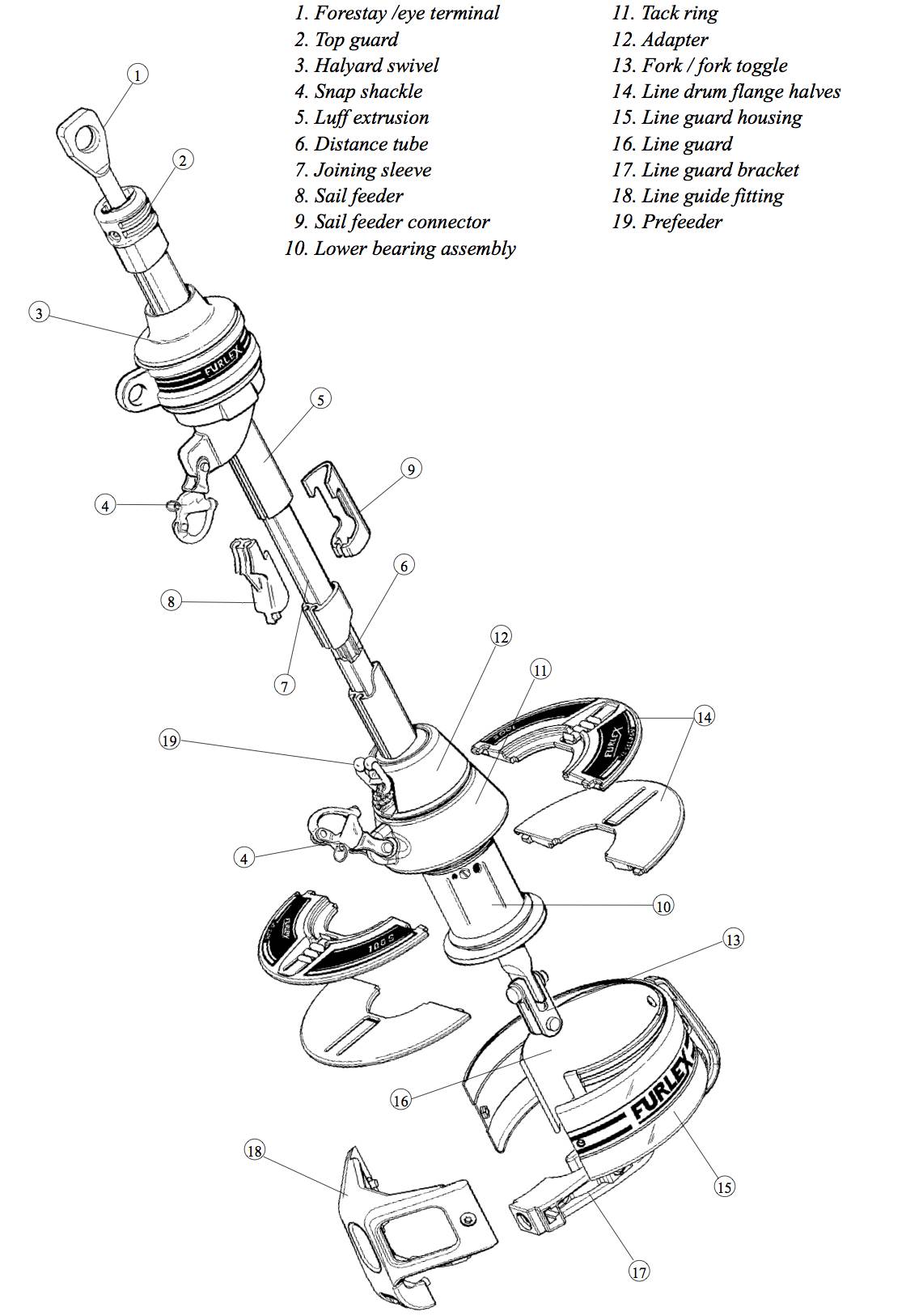

I'm not sure how the system you are describing works but normal roller furling has a forestay inside the foil, the luff tape slides up the foil. The foil spins around the forestay and the sail furls around the forestay.
In this image, Item 1 is the top of the forestay and item 13 is the bottom.

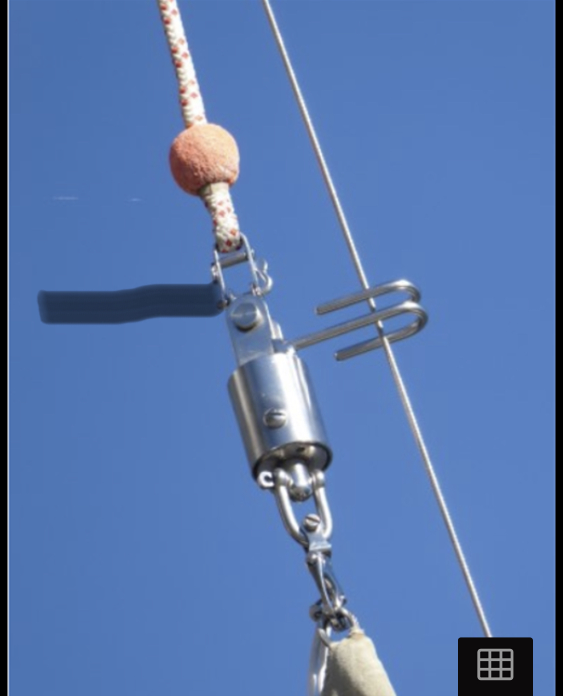

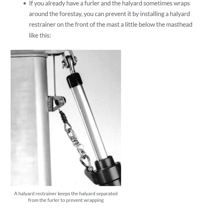

Thanks very much for the replies. This is a picture of the system I have. I know it is a bit outdated but it has advantages I appreciate. I can install my genoa which also has a wire luff in minutes. The problem I am having is that the "bail" that hooks to the fore stay sometimes wraps around it. There is very little clearance at the top of the mast for the jib halyard and the fore stay. They converge too close to keep the upper bearing assembly from wrapping. It's kind of like what people describe as halyard wrap but somewhat different as it is not the halyard that wraps around the fore stay but the entire assembly. The second picture describes a way of preventing halyard wrap and perhaps it would work in my situation. Does anyone have any experience with this? Thanks.

I have never seen this type of set-up (which means little) however I can see how the top would wrap along with the sail when furling/unfurling the head sail. If there were a line pulling it towards the mast if would keep it in place, but that does not seem possible. maybe this issue is why I've never seen these before. Or maybe the system was designed for a hank on sail only and not made for furling.

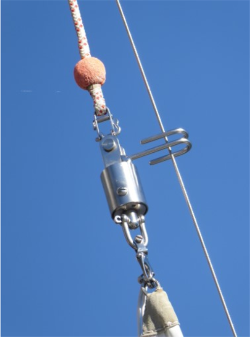

Is it possible to connect a bar as in the altered photo below? The bar would contact the mast and prevent the wrap.

My thinking is you attach a short piece of material to the actual bearing. When you hoist the sail to the top where it is close to the mast it is long enough to touch the mast. If it rotates the bar would prevent it.

I think the idea you mention in the second photo would work. It does not even have to be that elaborate. Any block on a short pendant attached at the top of the mast should keep your halyard from wrapping.

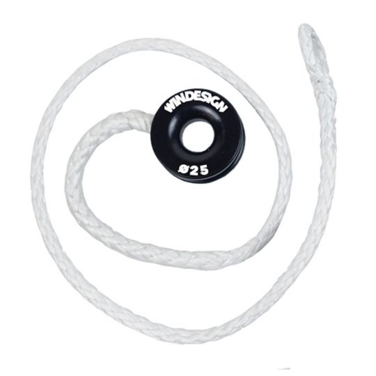

Or maybe one of these low friction rings... just use a shorter pendant than seen in this photo and tie it off at the top of the mast. Run the halyard through the ring.

I have seen a V attachment on the top bearing that cradles the mast when raised and prevents halyard wrap. This would be very similar to what @Hunter216 is suggesting. It should work for this setup and could be clamped around the bearing or welded on the opposite side of the hooks.

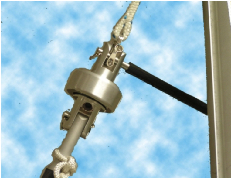

That’s a wonderful offer from Dr Judy.
I finally found the picture of what I was suggesting. Comes from the CDI furler manual attached.

Yes crazy Dave it is very smooth. I mentioned that in my original post because that would obviously cause this problem. Thanks. No Judy I am in Richmond VA. I do a lot of my sailing in the Chesapeake bay and down to the outer banks. I am moored at a place called Lewisetta not far from Tappahannock. You are welcome to come and visit. I'm sorry I can't send an actual picture right now since I am two hours from the marina. Mine doesn't have the extra shackle. That is a stock photo I found. My upper bearing goes all the way to the top. I think that is one of the problems. The jib stay and the halyard converge at the masthead and that's where the problem is. I can't shorten the wire luff however so I am pretty much stuck with that geometry. I really like the idea of a V shaped thingy that would hit the mast when furling or unfurling and keep the upper bearing from wrapping around the fore stay.

The second picture in your original post shows the solution. Most furler recommend a minimum angle between the halyard and the forest a of 15°(I think). The guide is mounted on the mast to provide the proper angle for the halyard.
