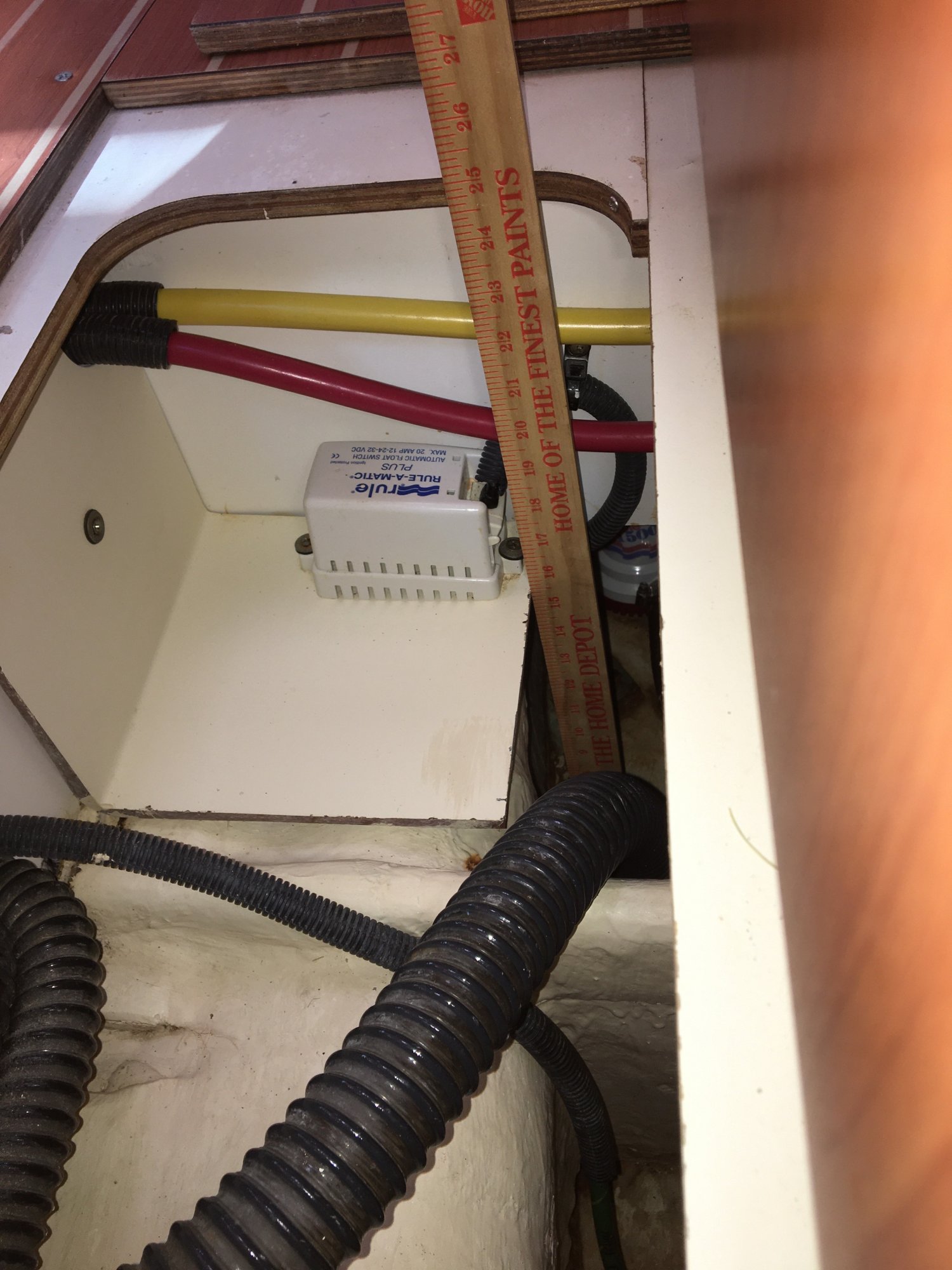

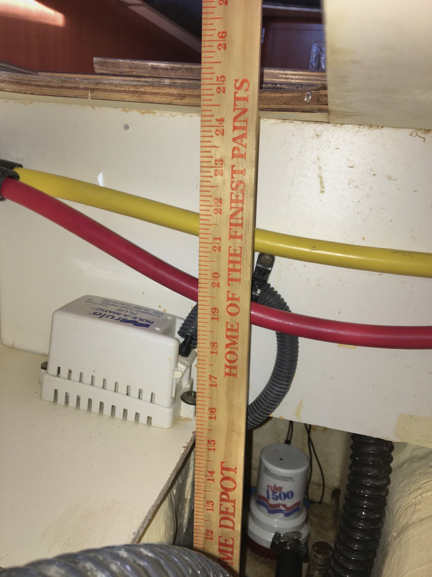

For reference, check the “2008 H36 Manual” in the Hunter archives here. Our 2008 was prewired from the factory with the high water alarm. There is a standard bilge pump float switch mounted on the shoulder of the hull where it first drops toward the keel - about a foot above the lower bilge pump/switch. There is a small alarm panel at the instrument panel in the cockpit. I occasionally lift the float switch to test the alarm. There is a wire terminal strip above the high water float switch where you simply connect the pump and the pump hose hose is preinstalled. Mounting the pump is on my to do list.

Dan, is the high water float switch mounted in the lower hull or in the keel sump pit?
Already have the high water alarm but not sure where/how to mount switch. Would like it just slightly above the bilge pump float switch.

My apologies for responding late. The float switch is mounted about 11” below the cabin sole, so the high water switch is about 15” above the bilge float switch/bottom of bilge . It sits on a piece of starboard. Photos in next post.
Dan

Glad I took these photos...reminded me I still needed to secure my house bank cables where they cross the bilge!
