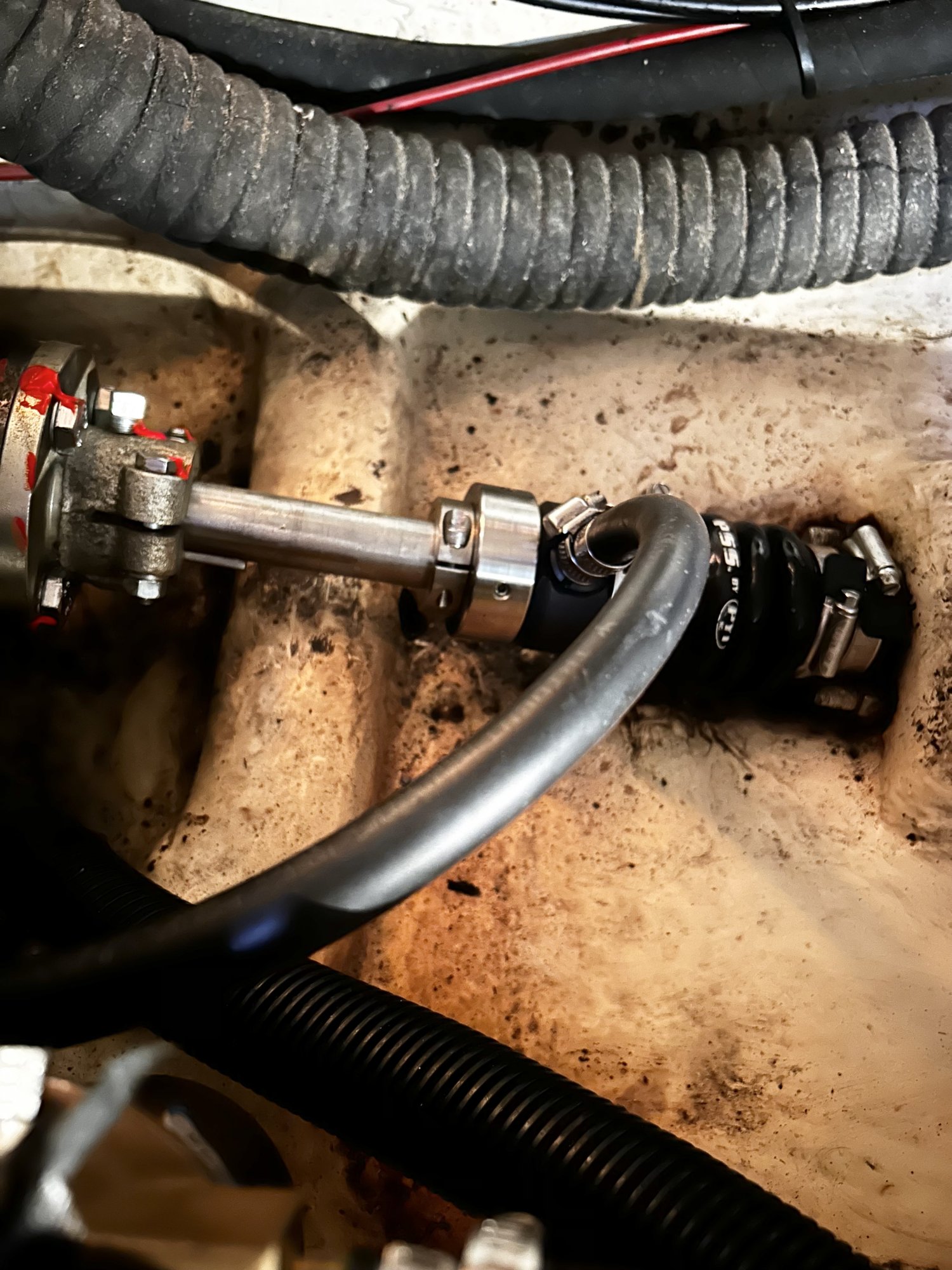

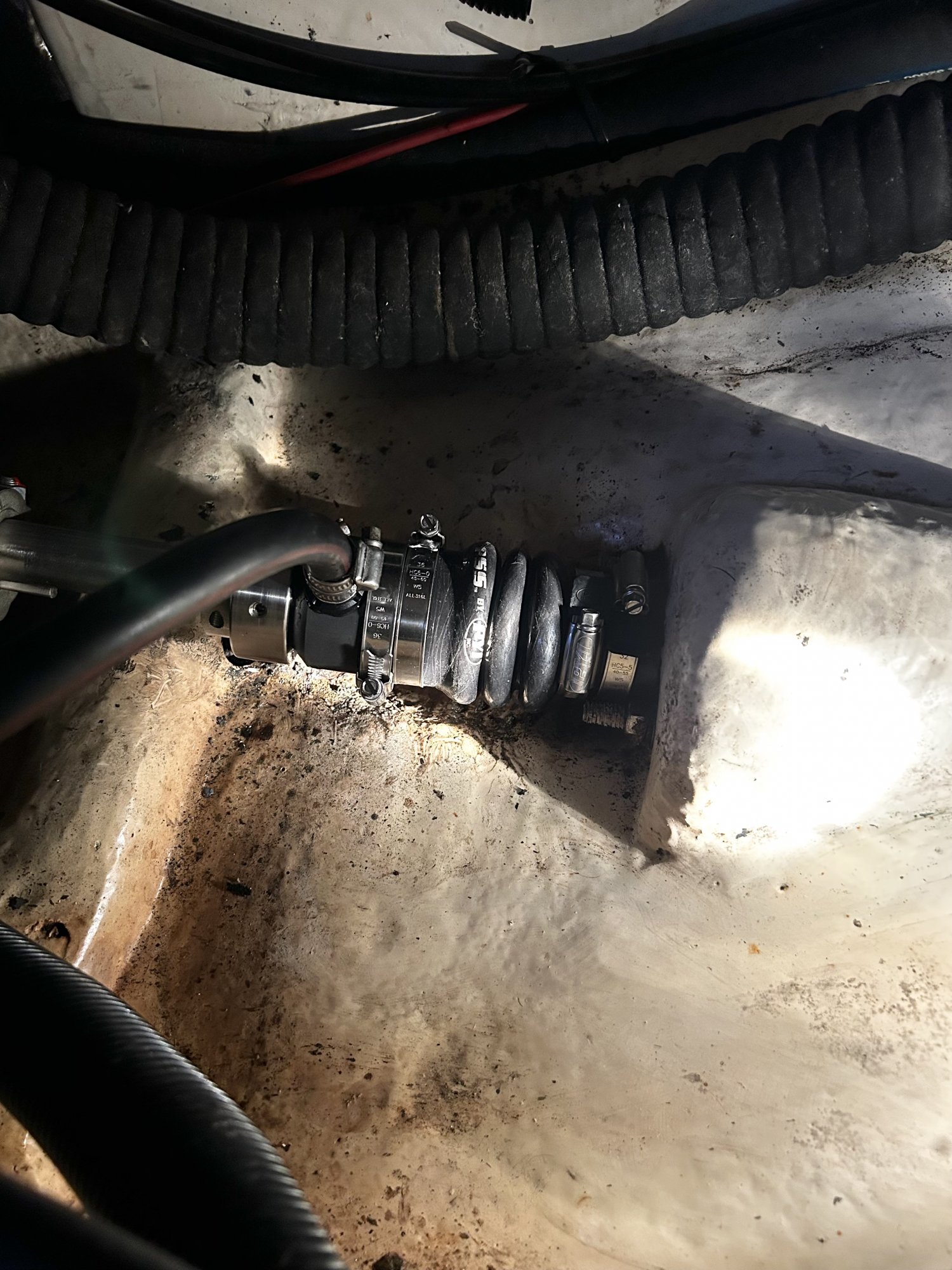

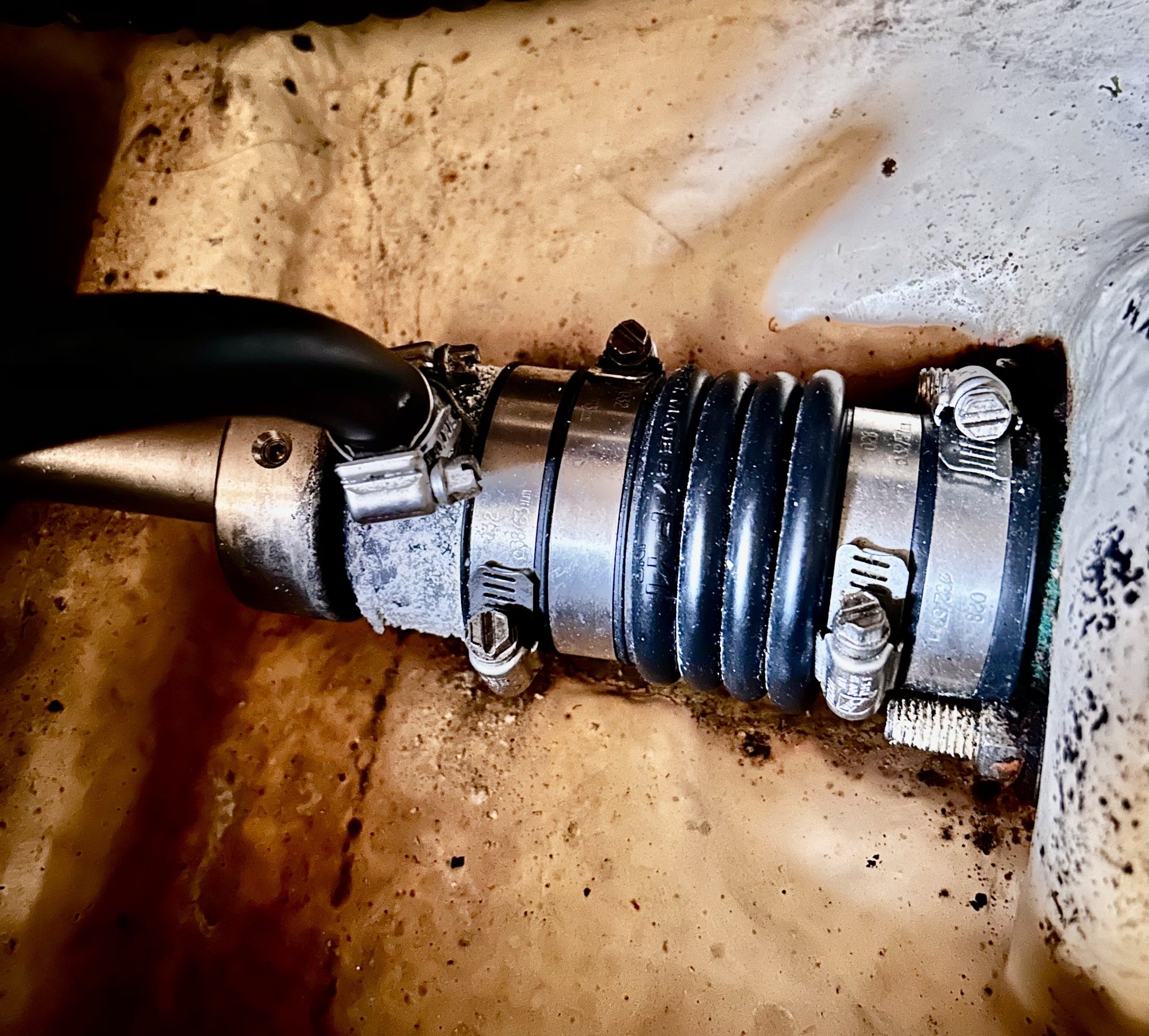

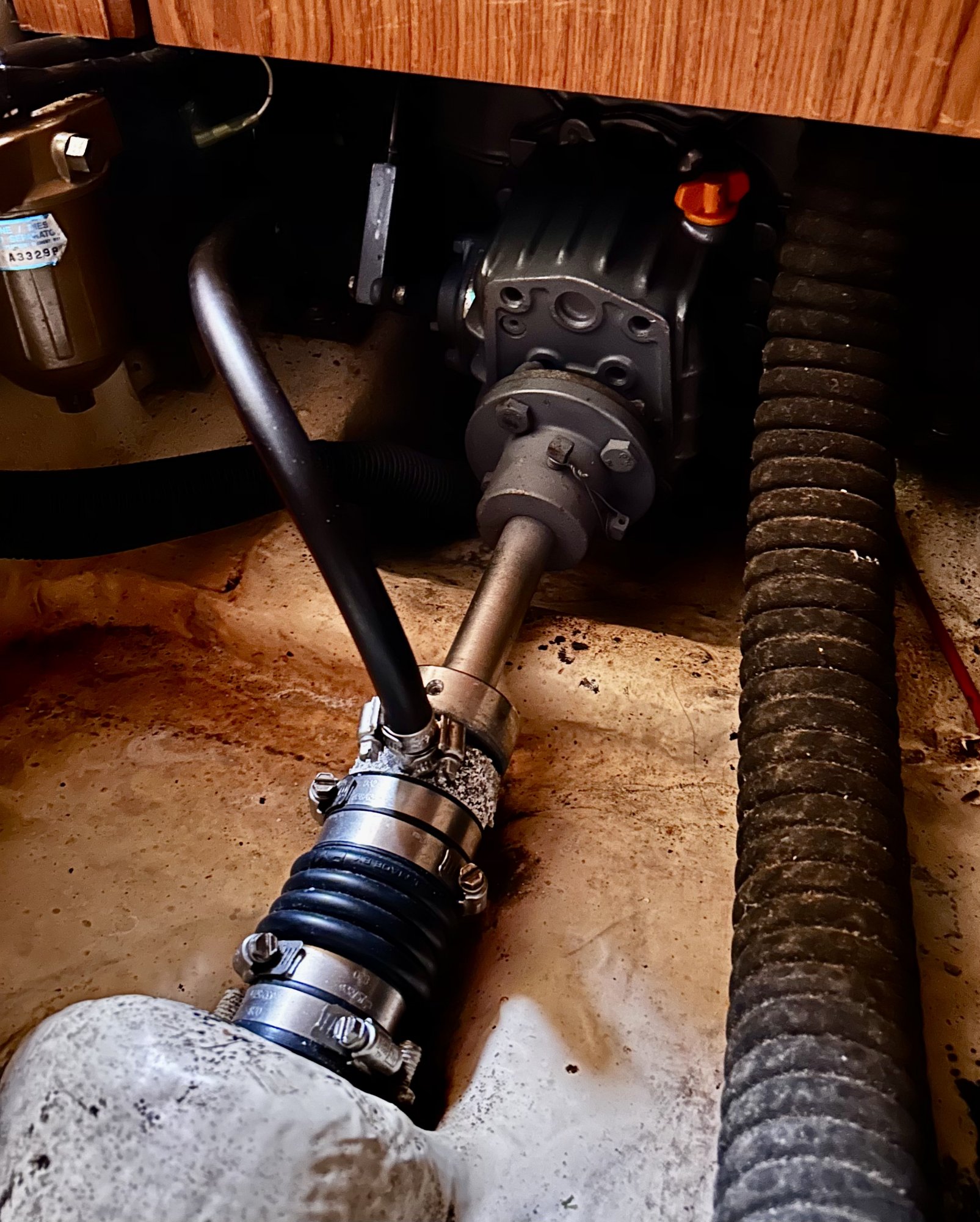

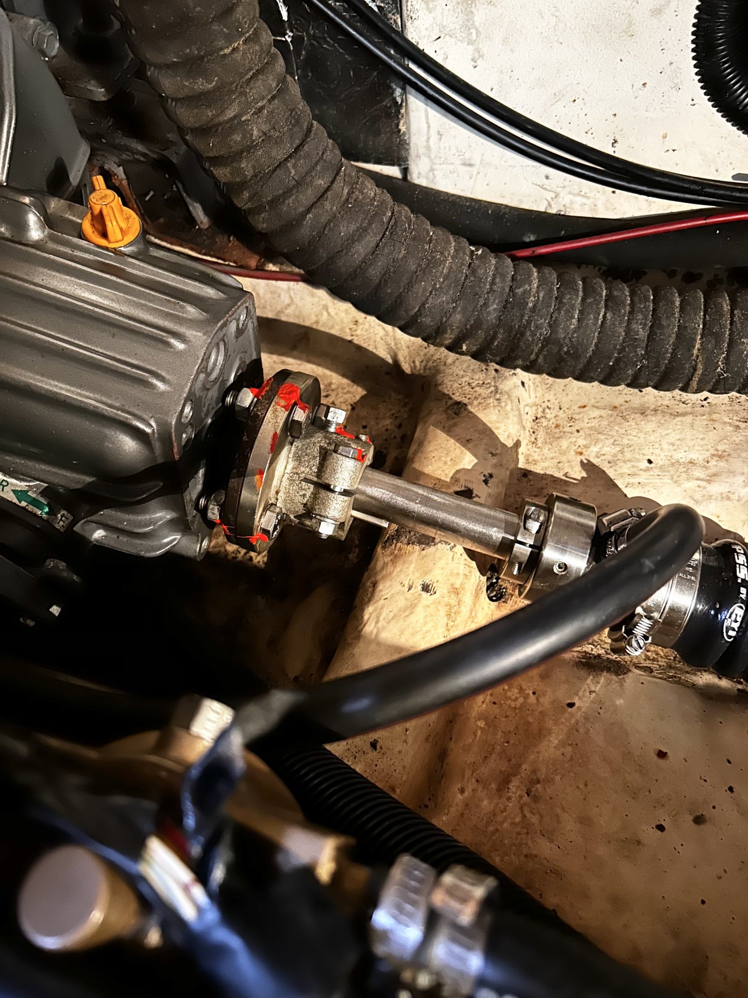

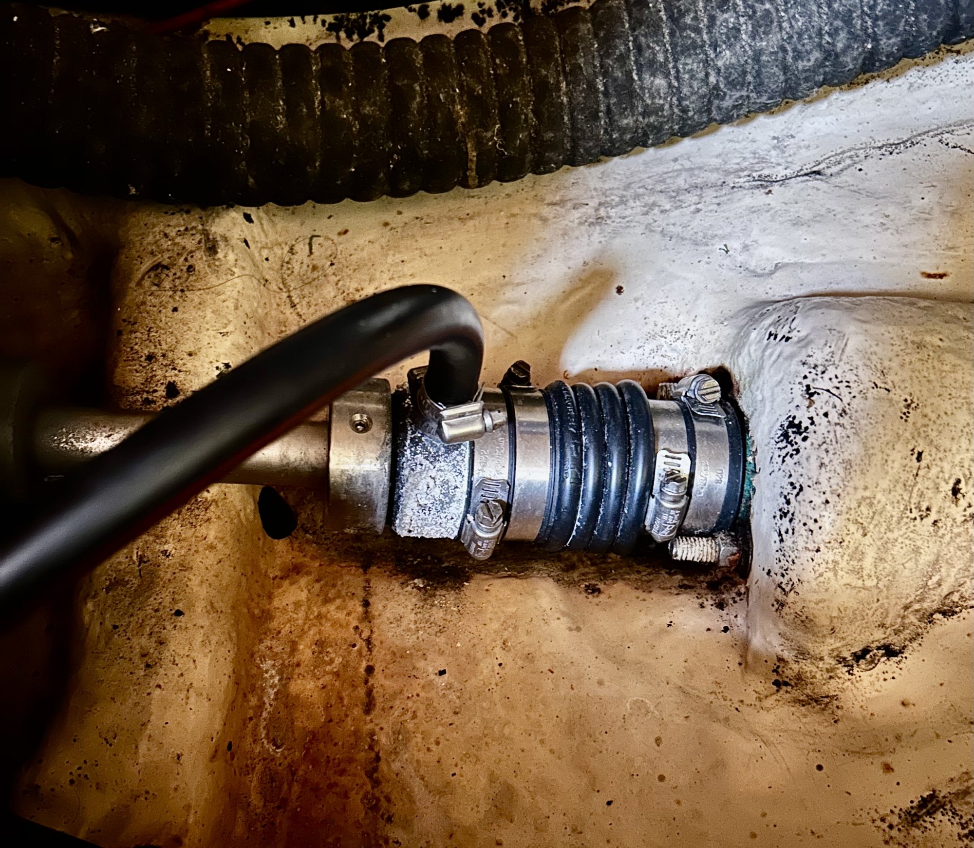

What John has just detailed perfectly is 100% what you should see and not see. I just installed a new PSS system on my Hunter 340 last month. I have only had a 30 minute +/- run and have no water. I can share some before and after photos of the finished project as a reference. I replaced my seal after 8 years because I saw some signs of the bellows drying out and didn’t trust it going forward.
I have the PSS with the Silicone bellows now. It states a 10+ year life span.
First 3 are the before….
