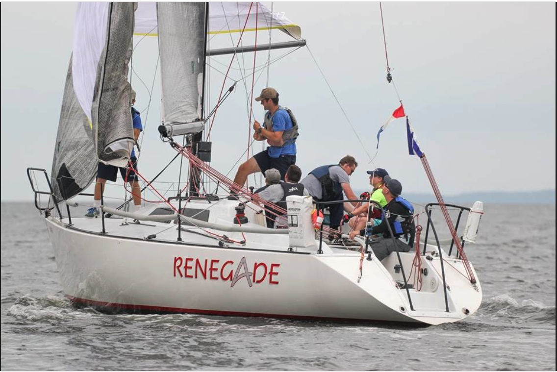

Your boat looks great. I just purchased Renegade and will be bringing her back to the Long Island Sound for racing. Will be training my kids (my son and several young people that wok for me) how to sail this coming spring.

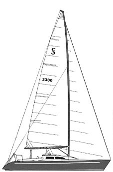

Which of the rigs? What year and where produced?
Looking at images the mast and rig look to be slim, flexible (tune-able). This would lead to the need for the runners. The below link observes the stress placed on the inner shrouds affects the inner chain-plates and how the deck is designed. One of the builders decided the need for increasing the strength of the deck design.
I can admire the lines and power designed into the Soverel 33. She looks like she would take to the SF Bay waters more like a thoroughbred than a quarter horse.

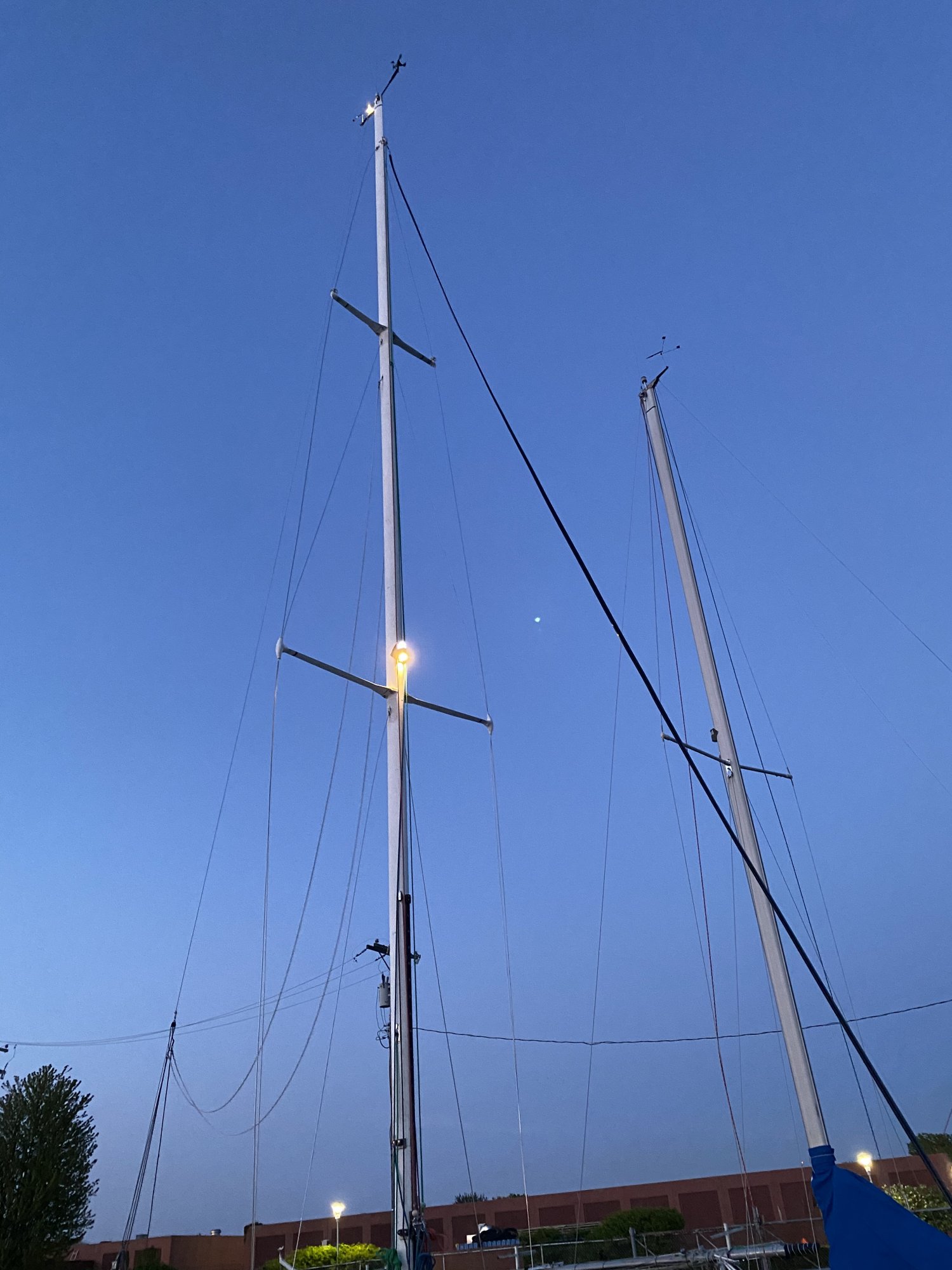

As far as I know all the second gen 33’s had a similar rig. They have straight spreaders with zero rake. Its also a very bendy mast which is great for controlling shape. These things (particularly the straight spreaders) are why the check stays are required. They are actually quite simple to manage the way they are set up on my boat and can be a powerful draft control tool on a light air day. There are a lot of strings to pull but if you know how to pull them the boat absolutely flys.

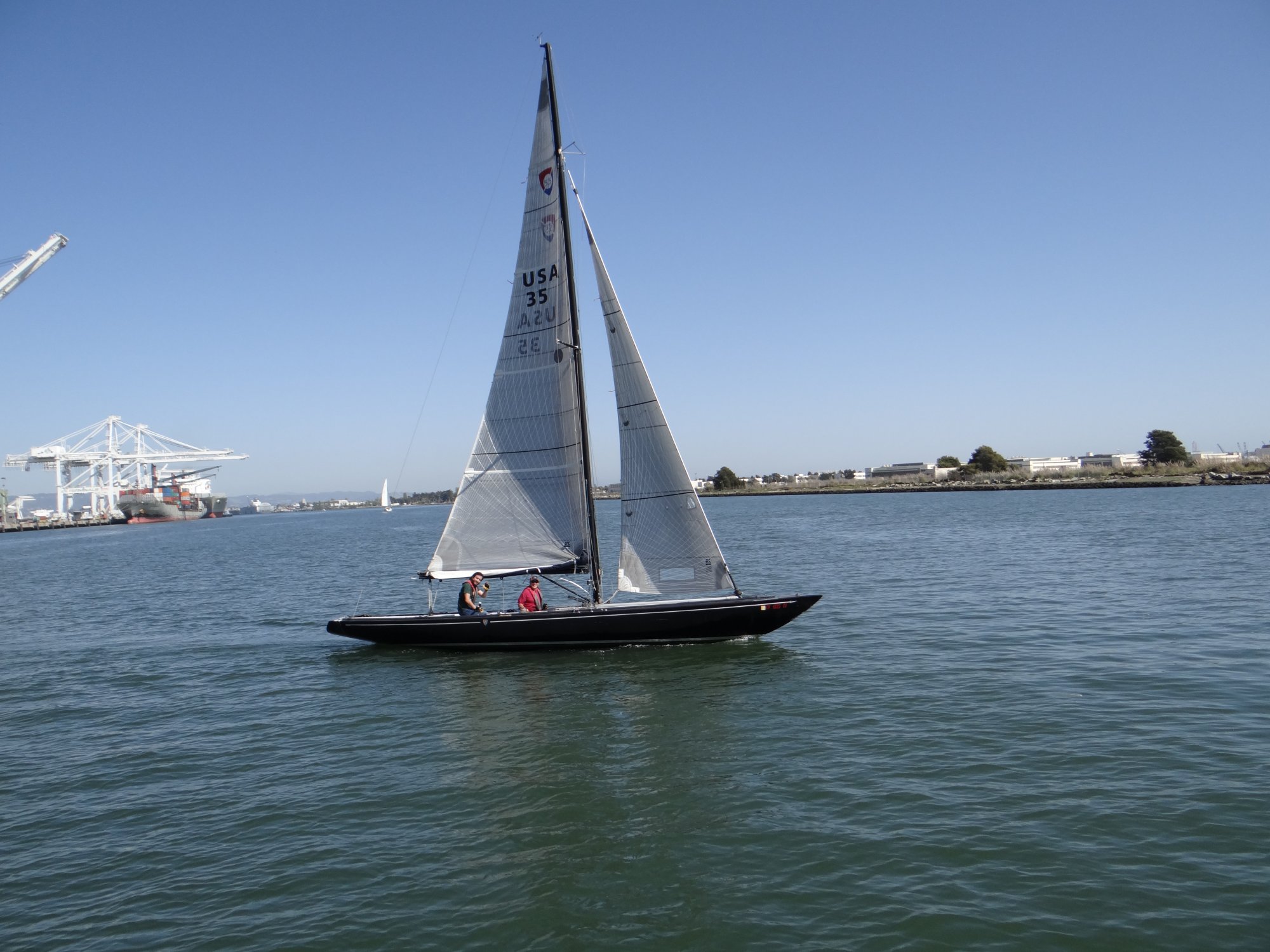

Just one point to clarify is that I am not looking for a cruiser, but only wanting a fast daysailor. My current boat is a Columbia 5.5 Meter, which we daysail always, instead of racing.

Is it going to break at the slightest mistake? Probably not. But without the check stays it’s going to pump and would eventually lead to issues. As I mentioned, the way it’s rigged it pretty much requires the check stays. That was fairly common for boats like that of that vintage. Side note, that’s a beautiful boat you posted by the way cheers. It reminds me of an old 30 square

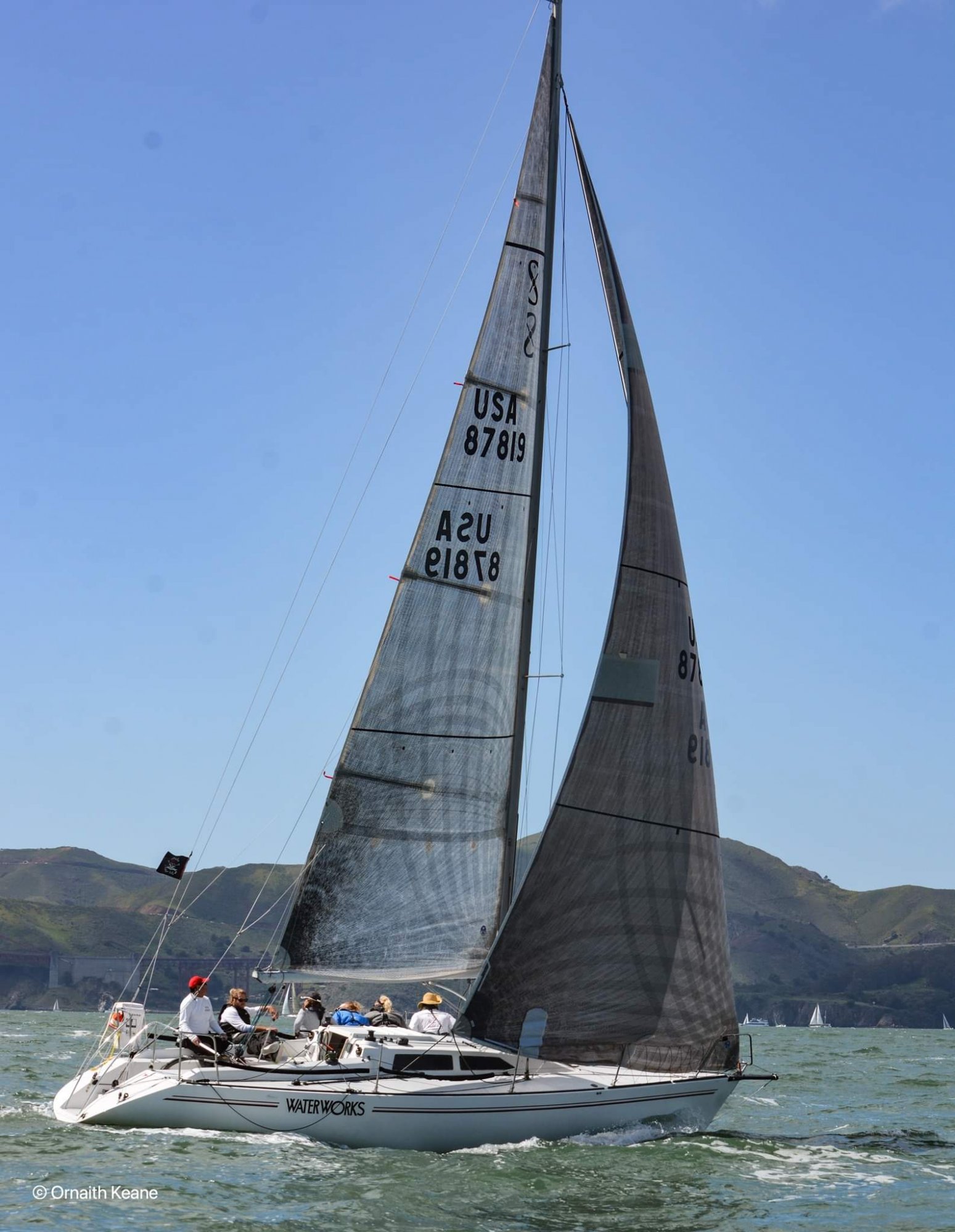

This boat has both running backstays/checkstays (connects to mast near the top of the headstay, and again halfway down the mast), as well as a babystay in front. We certainly will use them to keep the mast from pumping. Our fear is what happens if we are suddenly needing to do an emergency tack and don't get to the runners?
Here is the boat I will trial sail on tomorrow, and hopefully purchase.
Aug 21, 2020
13
Soverel 33 mkII Port Huron
Looks like a nice boat. I see a bow sprit on it which is a nice touch. Every time we tack there is a period of time the check stays are off. We also let the main fall down during that switch so the rig isn’t powered up. That gives us a chance to get boat under control on the new tack. If done quickly little speed is lost and what is lost is quickly recovered quickly once the main comes back up. My check stay are set up a little different in that the have a bungee that pulls them up out of the when you release them which is nice. My back stay is also set up very different but it’s easily adjusted from either side of the cockpit. I would be happy to come out and give you a hand if you do purchase it (I’m an airline pilot and can fly for free). I’ll also add a couple pictures of my set up if you feel it would make it easier.
23,072
Perhaps what happened to Americas Magic.
