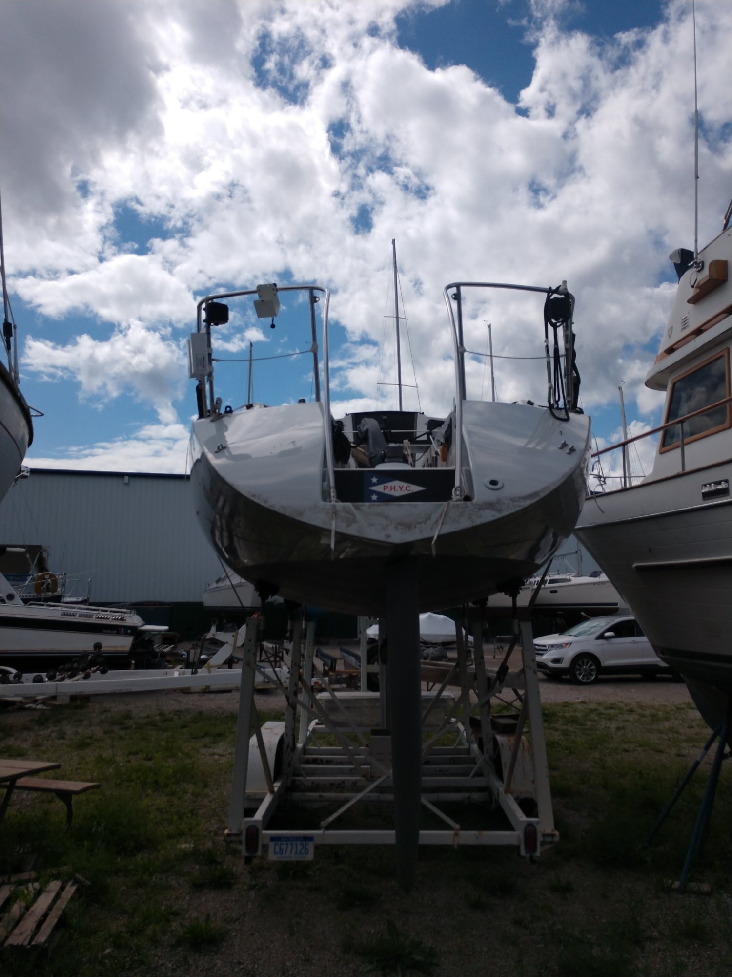

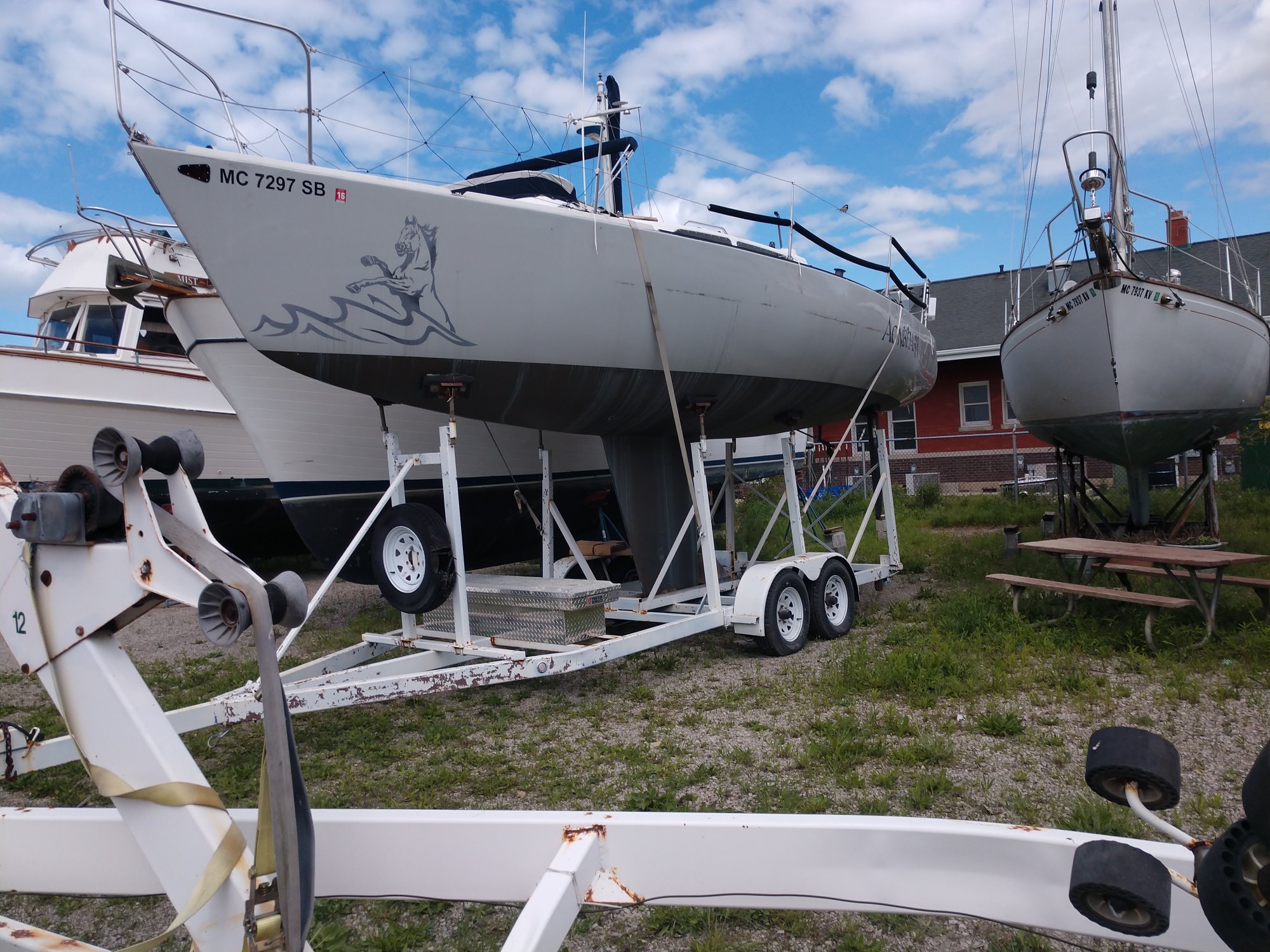

Should get some tomorrow will be at the yard where it is right now and will shoot a couple to post. She is dirty but has some nice graphics on the bow, this boat is well ahead of its time, with the open transom and rod rigging that you see on boats of more current birth dates. My sons and I are planning to refurbish and race the heck out of it, I believe that it has a PHRF of 90.
Forgot to mention her name is ARION taken from Greek mythology

This particular Soverel was manufactured as stated by the previous owner in 1983 in Florida by Soverel Marine, it has already had the stiffeners installed to help prevent the deck from flexing as caused by the stanchions being placed so far inboard. While this design was intended to allow the boat to point higher given its ability to sheet in the head sail closer to the center line, it did impart some structural challenges. Marc Soverel actually designed the stiffeners for these boats and issued them to owners as a recommended repair.
There is no interior per say on this boat, but it does have newer cushions for the berths, the head has been removed but can be reinstalled, there is an obvious leak in a fuel line, evidenced by diesel fuel laying in the bilge, the main winches (lewmar 43's 2 speed self tailing) mounted on the deck top have been removed to repair the structure they are mounted to, the hull has no blisters, the bottom was prepped and painted in 2016 with VC-17 and never put back in the water, there has been some water intrusion in the deck, but the deck core is foam which will allow for rather easy repair.
