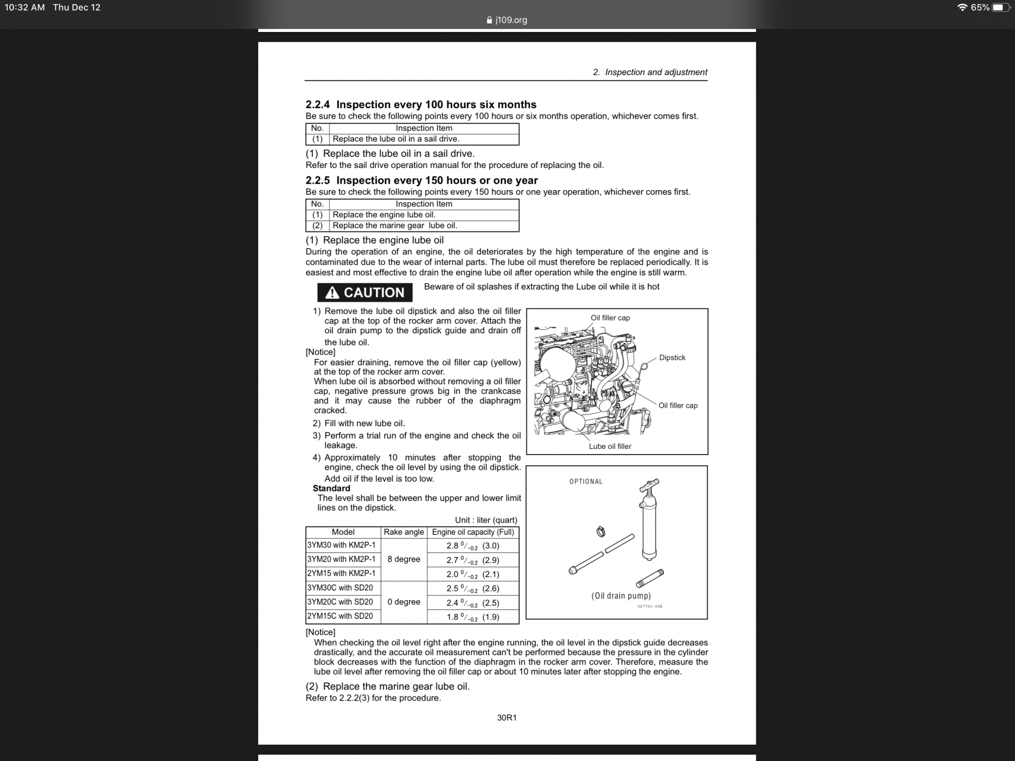

In attempting to remove some excess oil from our Yanmar 3YM30 through the dip stick hole, I was unable to get very much out. I tried several times and chalked it up to the cold engine and/or ineffective pump.
However, when reading the manual for the 3YM30, it specifically states that the oil filler cap should be removed before pumping out oil through the dip stick hole - which I did not do! It goes on to say that failure to do so can cause significant negative pressure inside the crankcase and damage to the diaphragm.
Should I be concerned that I have actually damaged the diaphragm? Is there an ’easy’ way to check?
Thanks in advance for any feedback. I anticipate a sleepless night ahead...

Interesting... I've only had my boat (with 3YM30) for two seasons... thus two oil changes for me... and never saw/read that. It does make sense to open the cap, I just never thought of it... I use a manual (not motorized) pump, and never noticed a problem sucking the oil out, as some air leaks in around dipstick. There's admittedly not a lot of clearance/space there though as the hose fills nearly all the dipstick tube. I'll have to open the oil filler cap next time and see if that makes any difference. I wouldn't lose a ton of sleep over what you did though. Diaphragms are inherently pretty good at resisting damage from suction/vacuum... that is, after all, EXACTLY the job they're designed for. I'm not saying it's impossible to damage it... just that the warning may have been overly cautious.

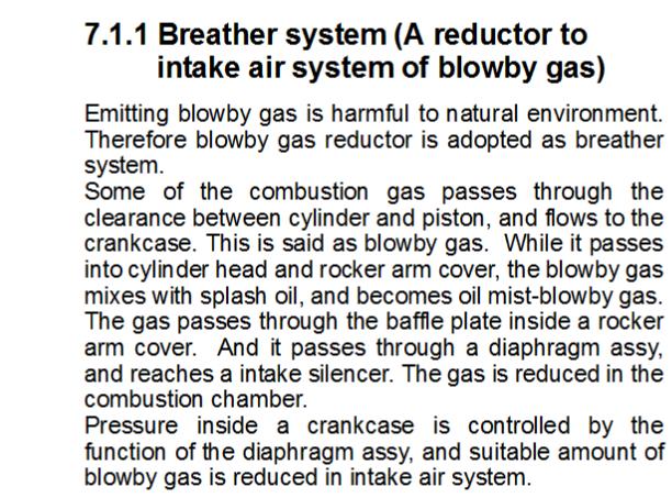

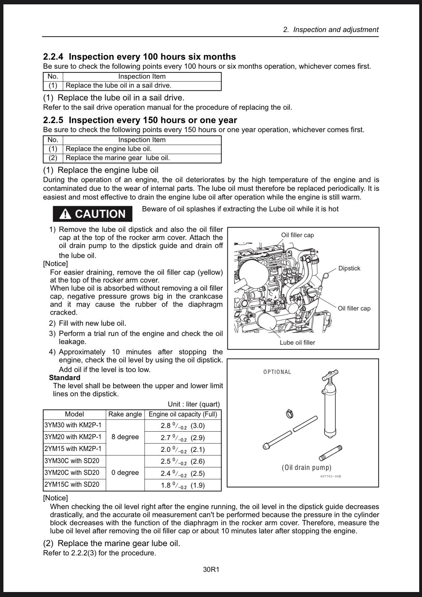

The Service Manual I’ve seen for the 3YM series is at https://j109.org/docs/yanmar_3ym-2ym-service-manual.pdf. It does have The diaphragm warning in sections 2.2.2 and 2.2.4. The diaphragm in question seems to be at the top of the rocker arm cover, in section 2.2.7 (5). The wording is a little broken so it’s hard to tell exactly.

@Davidasailor26 you are so right about the diaphragm mentioned in 2.2.7(5). Looks like a control for the release of blowby gasses rather than simply releasing them through the crankcase vent and back into the air intake as is more commonly done on their other engines. What's even more interesting is that they seem to control the crankcase pressure to something above atmospheric.
@LVGS even with the above information, I would be extremely doubtful that you have exposed this diaphragm to excessive vacuum due to air ingress around the oil pump tube and the very slow rate of removal of the oil.

What type of oil extraction pump did you use. From the pic in the manual it appears to be a type that seals the top of the dipstick tube. The one I use inserts into the tube and down into the oil. The type I use would not cause enough pressure to damage the diaphram as it would not build up pressure in the cranckcase and rather uses suction to pump the oil. I run the engine for several minutes prior to doing the oil to warm it up and flow easier.
