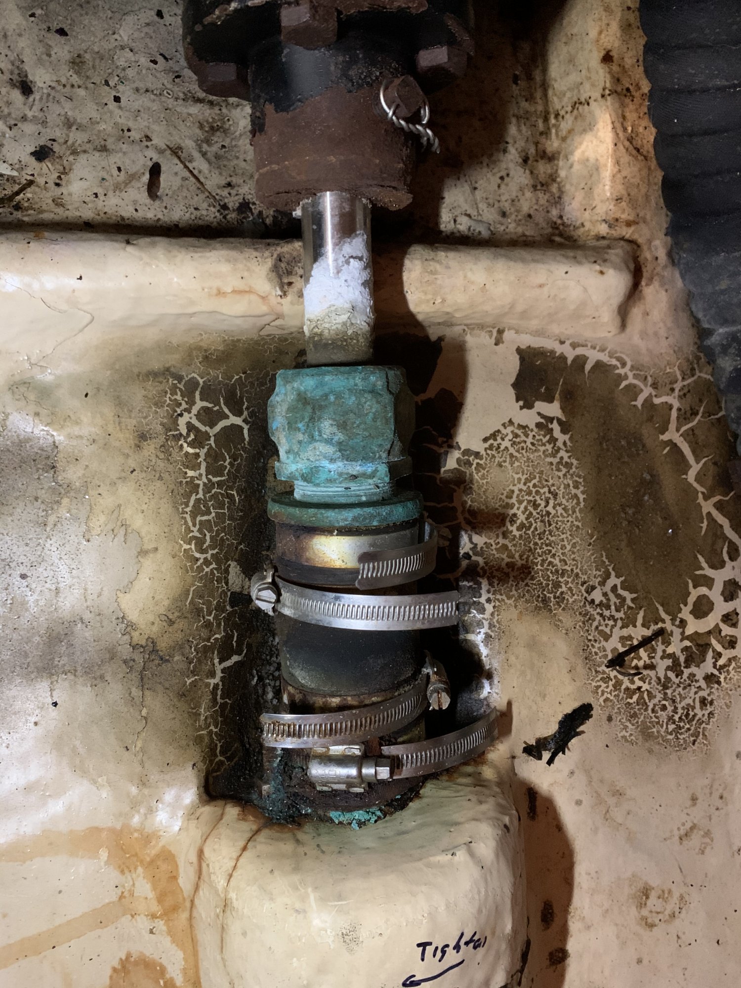

We are getting ready to replace the stuffing box and the shaft log rubber tube. What should we anticipate to remove the shaft from coupler at the engine?

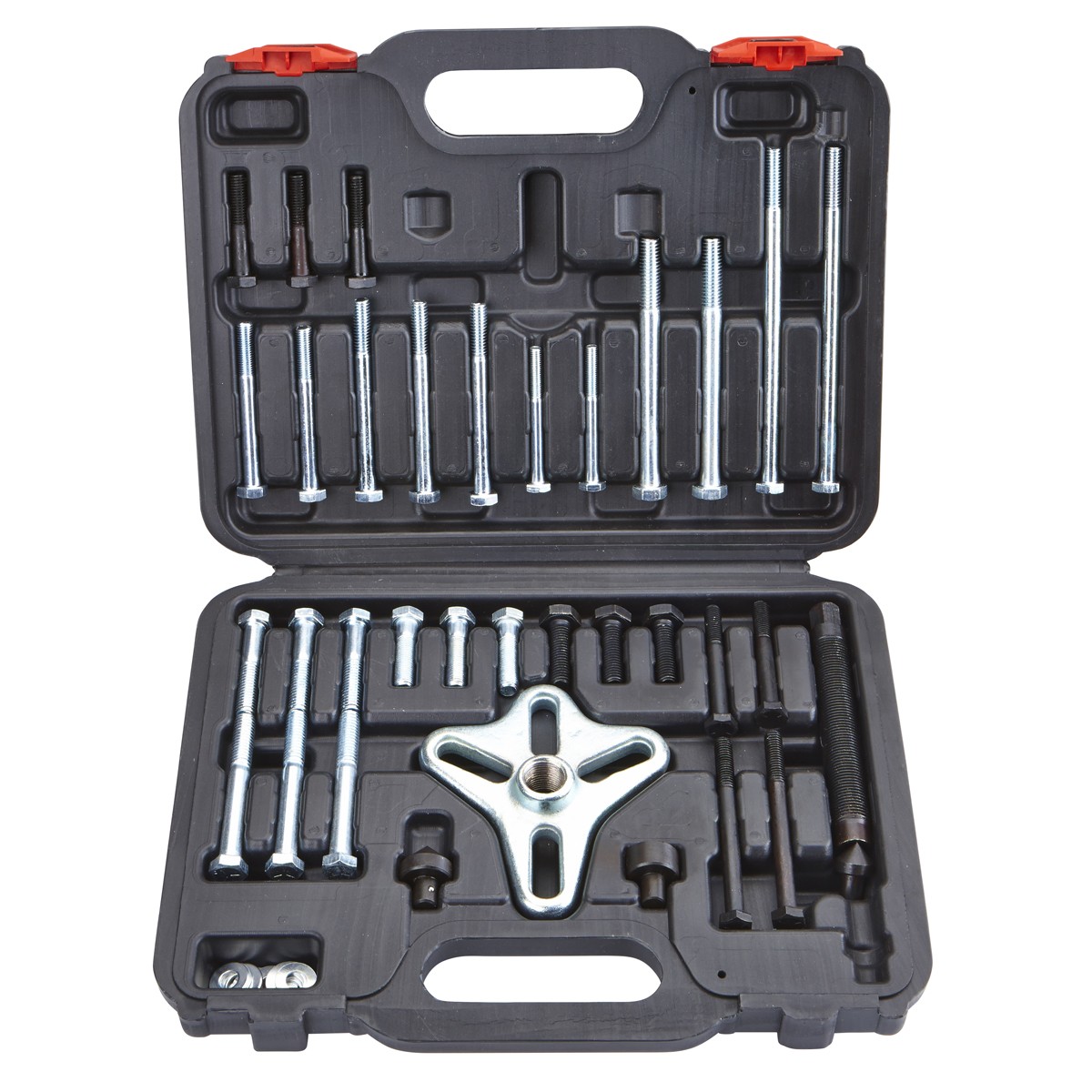

I had to use a homemade press to get my old coupling off. A steering wheel type puller might work. $15 at Harbor Freight

No room for the above puller. Idea... Use the existing coupler for a puller. Separate coupling halves and slide prop shaft back. Tap thru middle of 1" x 4" x 1/4" thick steel strap for 3/8" bolt. Insert short bolt then saw the threaded end off flush. Slip this between the coupling halves with head facing prop. Position so the bolt head is on the shaft, not the flange. Draw flange halves together with 2 bolts, pressing the shaft rearwards from the coupling half. Undo & repeat using a longer 3/8 bolt and washers or spacers under the head. After maybe 2 iterations you will not be able to insert a long enough 3/8 bolt and get it in the spacing because of the stupid bump in the hull. Fill the cavity in front of the shaft with 7/16 or 1/2" hex nuts and use them to press against. Was this understandable?
