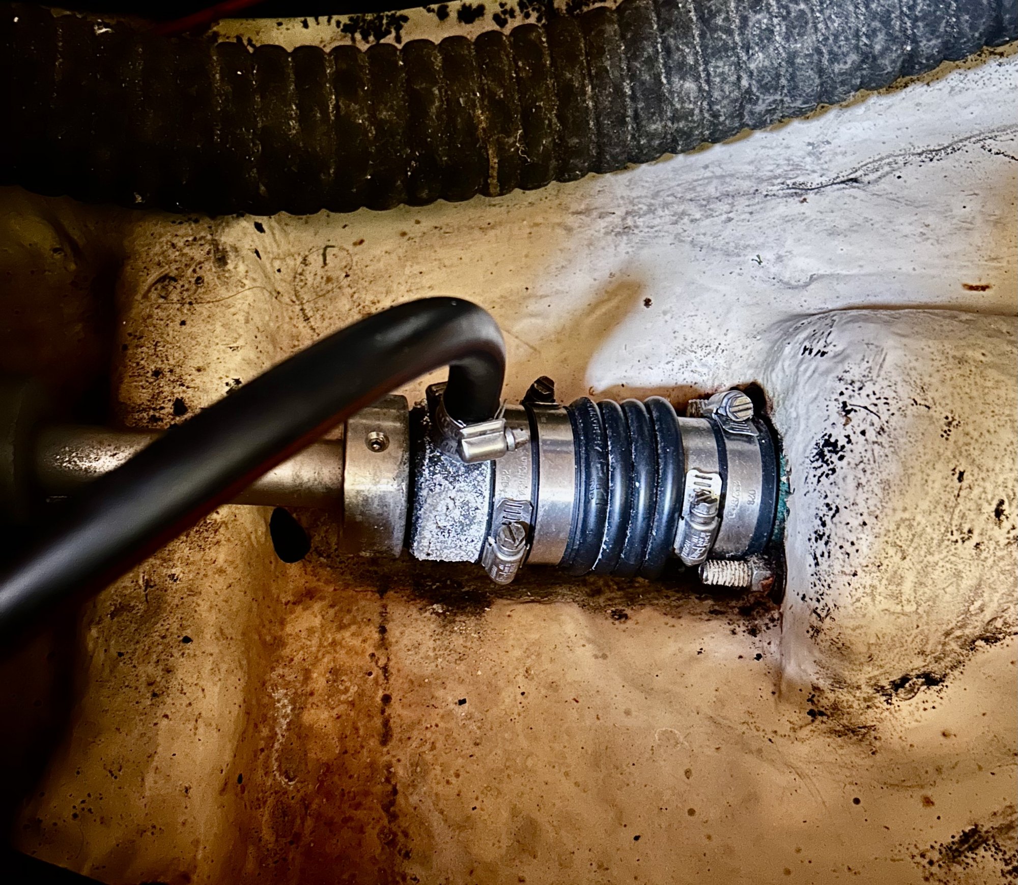

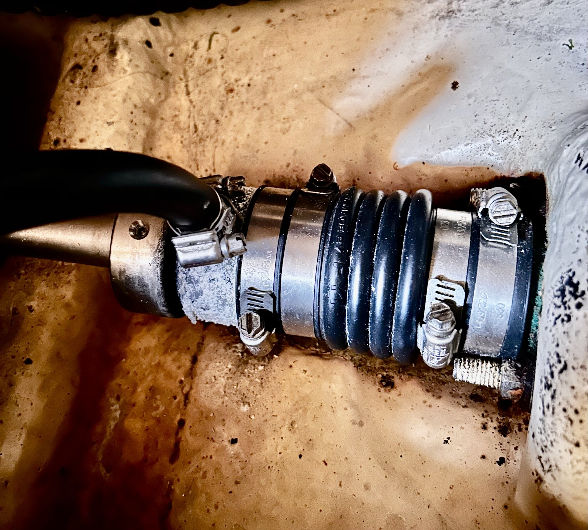

I’ll be replacing my 7 year old PSS Shaft Seal when I get hauled out at the end of this season. It doesn’t leak and what I can see of the bellows looks and feels solid. What I have is a salt scale forming on the seal.
I have checked it while motoring and never see or feel any spray but yet the scale is forming.

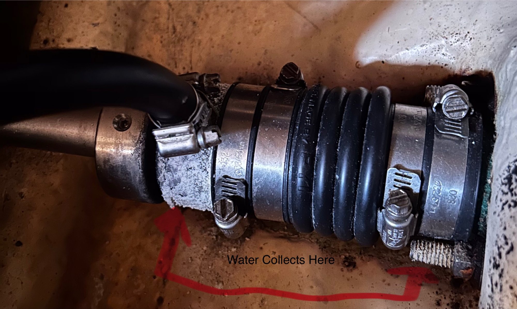

The only sea water that comes in contact with the seal is from when I remove the Sherwood Strainer filter to clean it out and that gives me less than a 1/4 cup of salt water. That water collects just under the bellows and stays there until the boat heels and tips enough for it to drain through the weep hole.
Tough call but do you think this is what is causing the salt scale to form like I have? Either way it’s coming out of there but it’s unnerving to see the scale and why its forming.

The vent hose has a seeping leak, or more likely the seal is leaking when motoring and allowing a little water to spray between the seal. This could be caused by the bellows not being strong enough to form a tight seal or a slightly damaged seal, i.e, the graphite collar could be scratched or marred.

Just a slight drip on the outside.
Wash it off and all should be good

Thank you all. I did try to clean it up a bit. Admittedly it was a half hearted effort, as I am at 7 years in with this unit and right in the middle of the 6 -8 year suggested interval, I plan to replace it next month. That salt crust is pretty solid and doesn’t give up easily.
