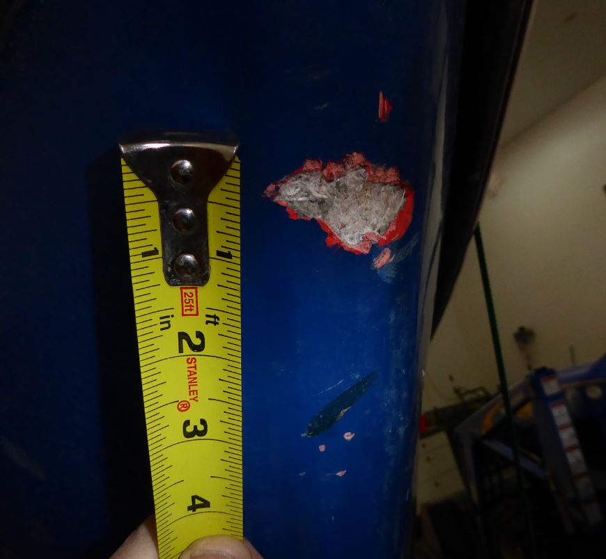

The damage is not great. Here are pictures.
I have searched the forum on the topic of repair, and have seen Marine-Tex recommended. I do not have any of that, yet anyway, but do have automotive Bondo on the shelf. I am wondering if Bondo would work, or should I buy a marine filler like the Marine-Tex?
Also, how much sanding back or chipping away should I do on the damaged area? It is well above the waterline.
Thanks in advance for your thoughts.
Bob

Bob, I would "grind" it back till I found solid material. No loose, crushed chunks. Does not look like it will be much. Then I'd get some thickened epoxy and some cloth and start filling in the hole. Once I had a solid surface again and mostly shaped as before, I would grind it back to shape. Once recovered the proper shape I would get some epoxy filler and fill/shape the bow removing the imperfections from the surface. Sand to finished shape and then paint as before. It will possibly be stronger than original, the epoxy will adhere to the boat material and is less likely to suck up water.
I do not like "bondo" for this repair.
Check out the folks at Jamestown Distributors. Jamestown Distributors
They carry the type of product that will serve your needs, and they have a lot of DIY instruction to help you use the products.

It is my understanding that Bondo is harder than the surrounding gelcoat. This means, when you try to sand your repair patch smooth and flush, the gelcoat will sand away before the Bondo does. Hard to get a good shape that way. It also absorbs water and doesn't stick as well.
To fill your gouge, chop up the glass and mix it into the epoxy, that way you won't get folds and wrinkles in the cloth that could create air bubbles. Then cover the sanded area with woven glass cloth for strength.

Oh.. What @Will Gilmore said reminds me. Use cloth and cut it up. Do not use "chopped Mat" with epoxy. The chopped mat you buy has a binder on it. It is designed for Polyester Resin not epoxy.
You can take a piece of fiberglass cloth and cut it up to enhance the strength of the repair. Or you can cut small pieces of cloth to fit inside the hole, wet them down and layer them. Just be sure to compress the layers and get the bubbles out of the mix. Check out the "BoatToday" YouTube videos. Andy is a great teacher of boat repair.

:plus: for Andy, but the channel name is BoatworksToday. I don’t know if glass would be necessary. Just thickened epoxy and/or something like the Total Boat fairing compound might be good enough, though I suppose adding some glass would be stronger.

Thanks for the detailed recommendations, js and Will. Some excellent tips. I've got everything except the epoxy, so will proceed along those lines once I've bought some. Great idea on the cut cloth.

Epoxy adheres better than polyester and does not shrink. Polyester, which Bondo uses does not adhere as well and does shrink over time.
Check the West System website for advice, they have a manual you can download, read online or purchase. Westsystem.com

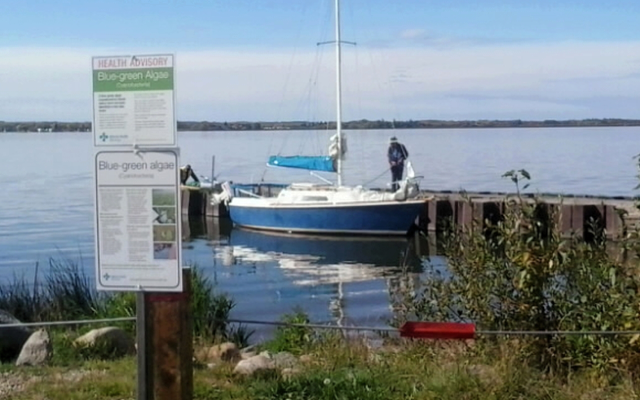

To defend myself just a wee bit: the dock was built by B.L.Zebub & Sons to a design initially used by the Wehrmacht in constructing defences on the Normandy coast against an Allied beach landing. It's as bad a dock as you could find. More just a breakwater built out of heavy steel sections smacked into the lakebed then hacked off kind of even using a torch. Not a good picture, but here we are:
You might note that there is no-thing, nae sae much as a wee bollard, to put a line around.....
I would say that the way we carried would have been just fine on any normal dock with even timber edging, let alone the rubber or plastic dock buffers that many of you would be accustomed to. We have 4 fenders out, but they play Russian roulette with the \/ \/ \/ section of the dock edge, and of course are useless at the prow. Long term the solution is to avoid that boat launch, which we shall from now on. I shall also work on my docking skills, or lack thereof.
Bob

Another anti-bondo aficionado here. It absorbs water (Look up hydroscopic.). After it does that all season, what happens to it in a January freeze? It pops off as the expanding ice blows it apart!!
As others suggest, epoxy is the way to go. It looks small enough that one MarineTex box would be sufficient. That would avoid having to spend more on larger kits of epoxy and filler than you need.

That’s not really that deep. I might just gelcoat and paint
I like John's "grind back to solid stuff" idea in the first reply. The damaged area probably never got really wet after this happened, but it does look as if some delamination occurred. I am open to all suggestions. Well, maybe not quite all .....
