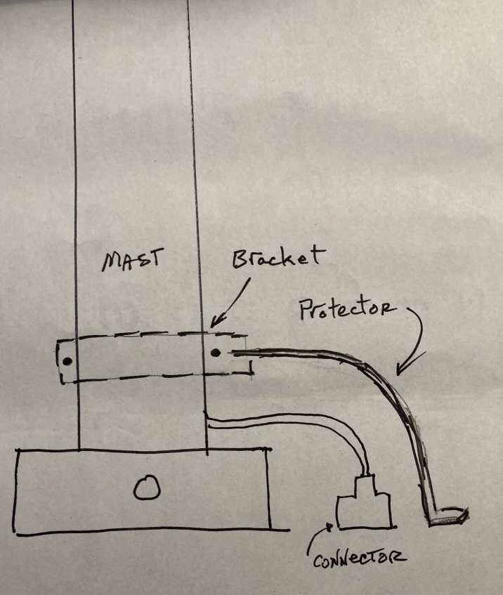

I'm replacing both connectors, but I would like to make some kind of frame or cage that protects the connectors from being stepped on.
Has anyone built something similar? Or is there something out there that can be bought?
One worry I have is that the foresail sheets will snag on the contraption during a tack.
Here's a rough sketch of what I have in mind ...

Can’t run cables through the mast step and put connectors inside protected from weather? Alternatively, use right angle connectors placed flush with the deck.
What you depicted looks like a tripping hazard.

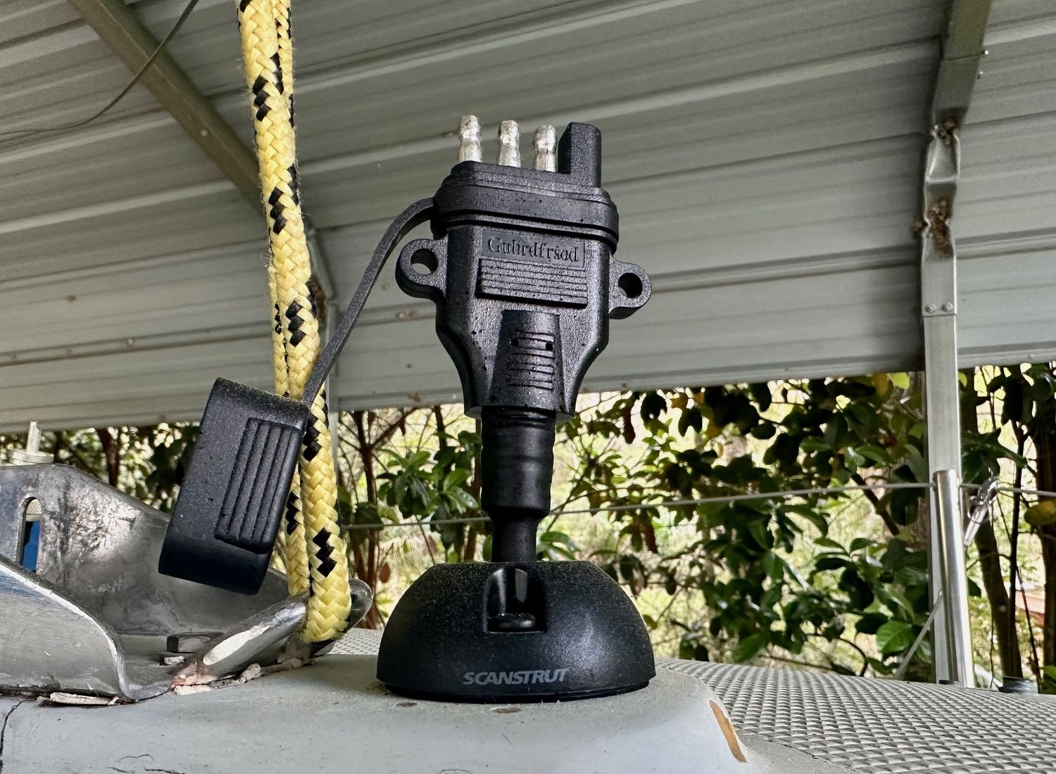

Side note. In my most recent re-wiring project, I finally gave up on four-pin connectors like the one in your pic. It seems dumb the way the female side always faces up, where it inevitably collects water and rapidly corrodes. This time I used trailer-style wiring connectors, the beefiest I could find, and a cable gland to pass the wire through. It's still pretty new, but I like it so far.

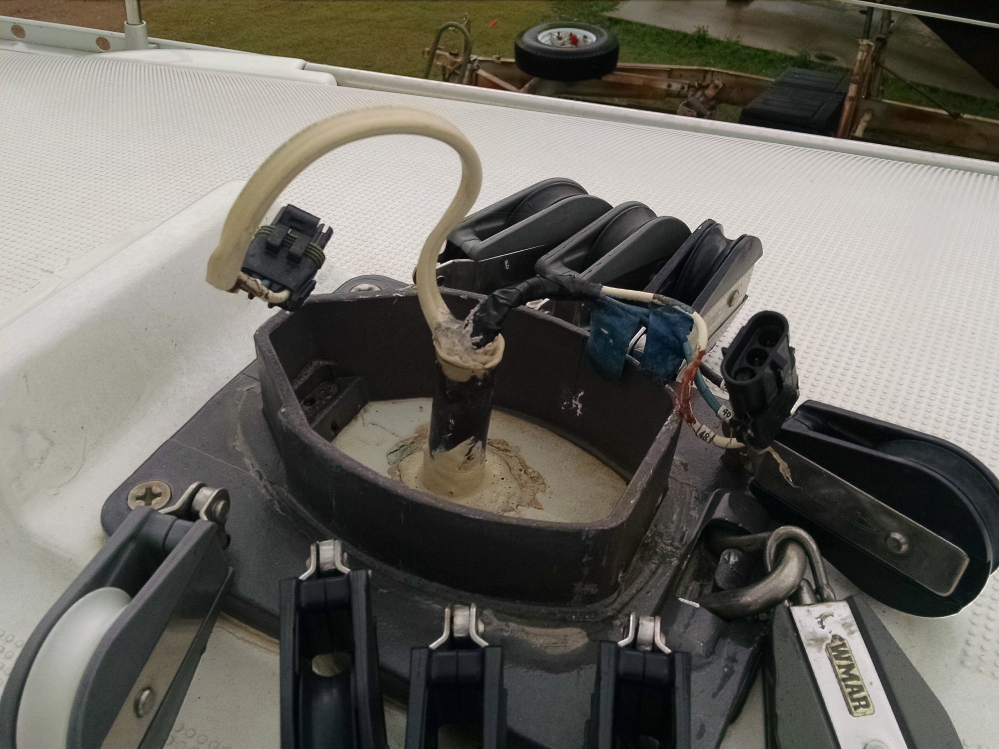

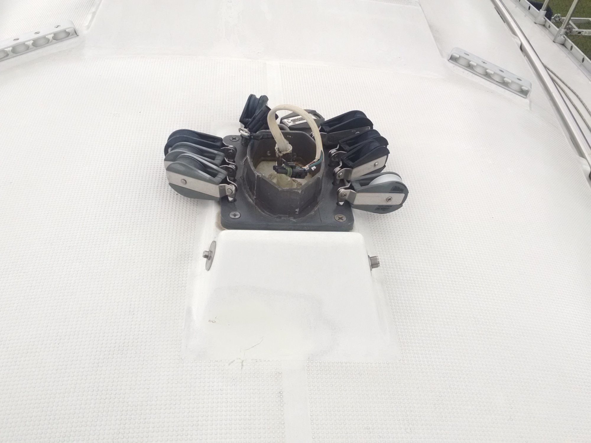

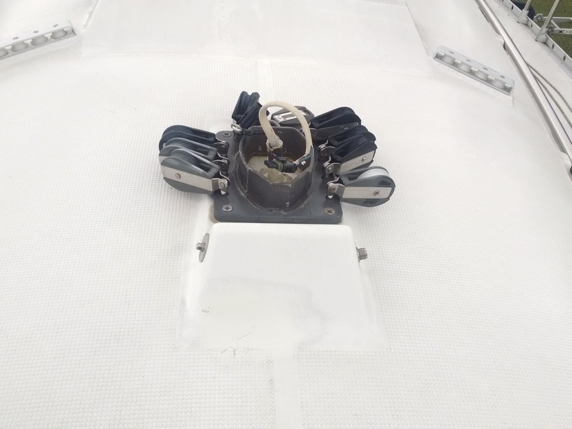

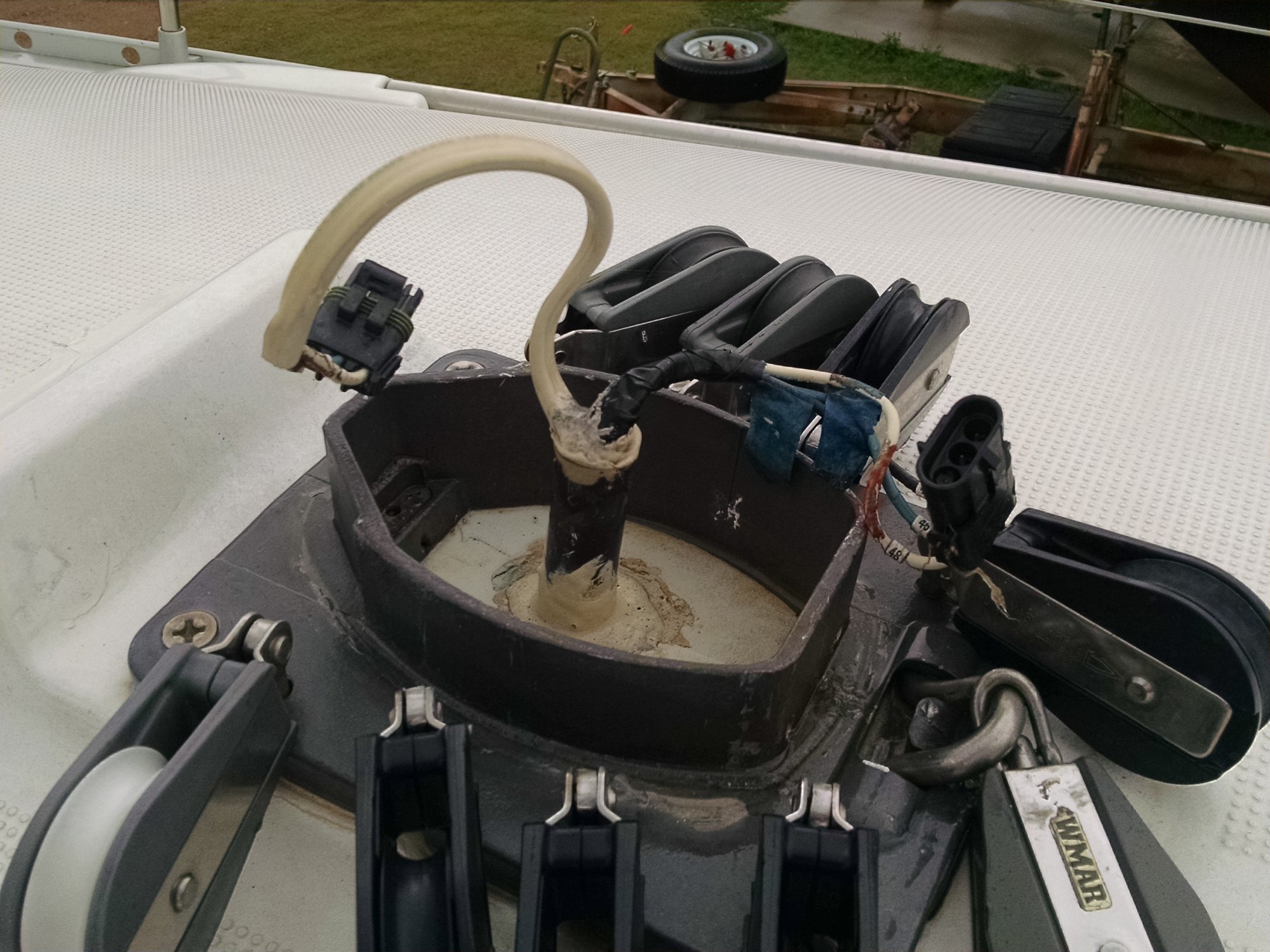

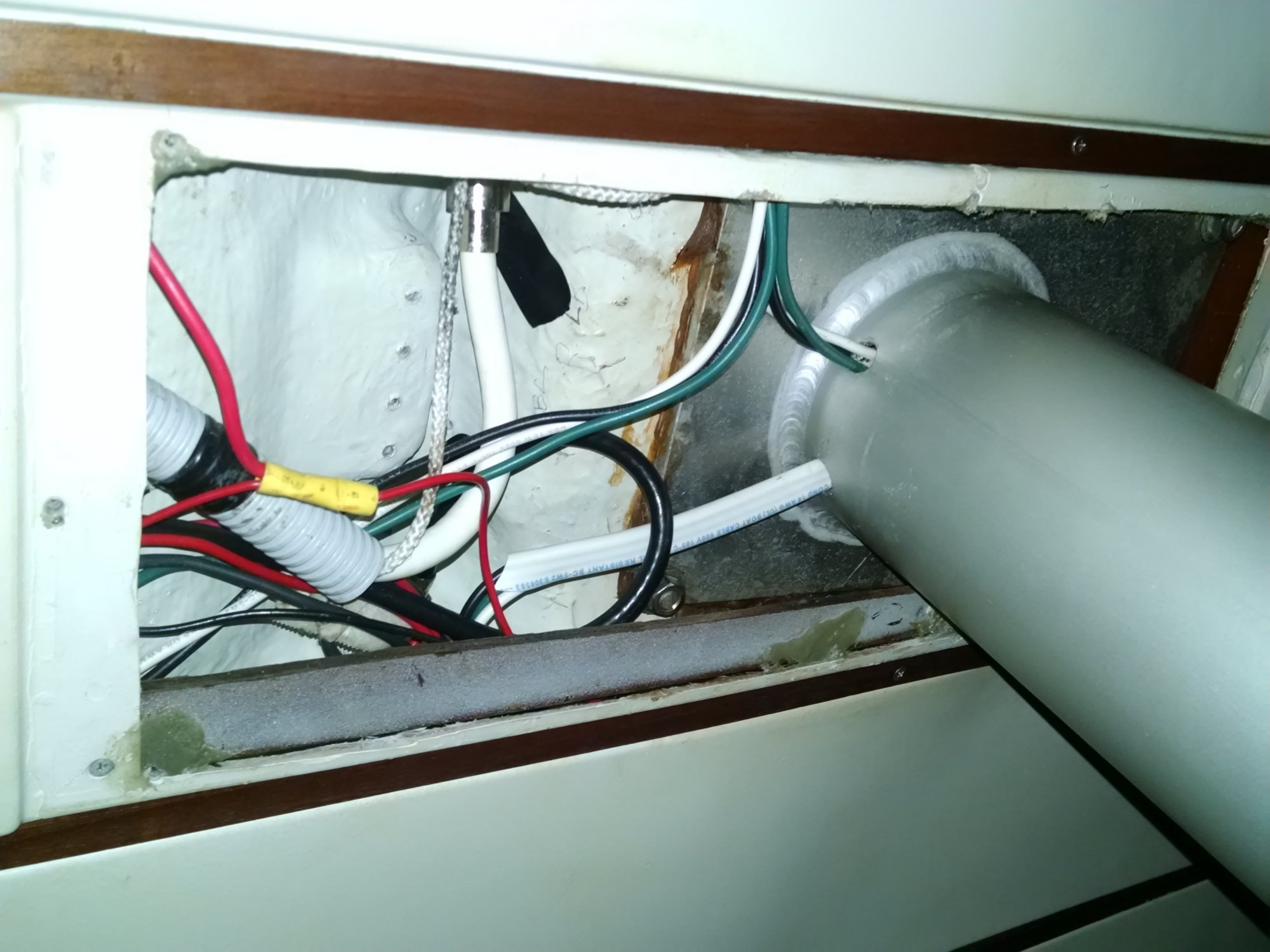

My boat originally had the wiring coming out through a hole in the front of the mast and connecting to connectors that were mounted to the fiberglass "bump" in front of the mast. Always leaked and were not ideal. I elected to expand the hole that the wires ran through in the mast base, made a copper tube that was taller than the sides of the mast base so in case water pooled up in the mast base it could not overtop the copper pipe. 5200'd the copper pipe in place as a conduit for the wires to run down into the boat and sealed up the top of that after running the wires. Used automotive "weatherpack" waterproof connectors. Then I glassed and faired the places where the old connectors ran through the "bump" in front of the mast. Now all my electrical wiring going up the mast is run inside the mast. Should have done the same with the VHF and TV antenna wires. Pics attached.

...This time I used trailer-style wiring connectors, the beefiest I could find, and a cable gland to pass the wire through...
:plus:
I've been using a 4-pin (and the same Scanstrut through-deck gland) for years with no complaints. If the boat is going to be in the water for awhile, I sometimes heat-shrink the connection or wrap it with self-amalgamating tape (and cut it off at the end of the season). But most years I don't even bother with that.

Just a standard 4-wire flat trailer plug - maybe this one - I bought one of these once, not sure if that's the one that ended up on the boat or if it's on one of our trailers, but something like that. Either a cable harness set that has both vehicle and trailer ends, or a 4-wire extension cable (cut it and use one end on the deck and one on the mast). And they're cheap and easy to source if you ever need to replace.
There's a picture in this thread.
