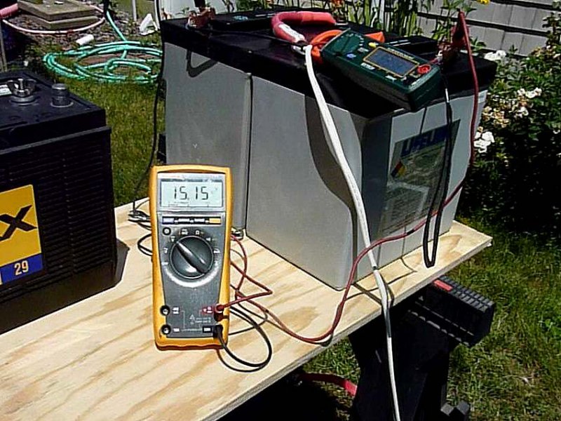

MaineSail did a study of lead-acid batteries stored in cold weather for months, and found that they lose very little charge. Top them up before storage and then disconnect them to remove them from small-load discharge.
This article has more authoritative information on proper storage than you probably want to know: Winter Battery Storage & Self Discharge Characteristics - Marine How To
