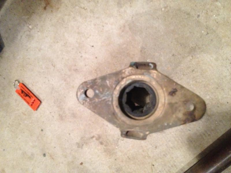

Prop thru hull 1 is a picture looking down at the cutlass bearing and the flange that is bolted to the hull, there is no 8" tube

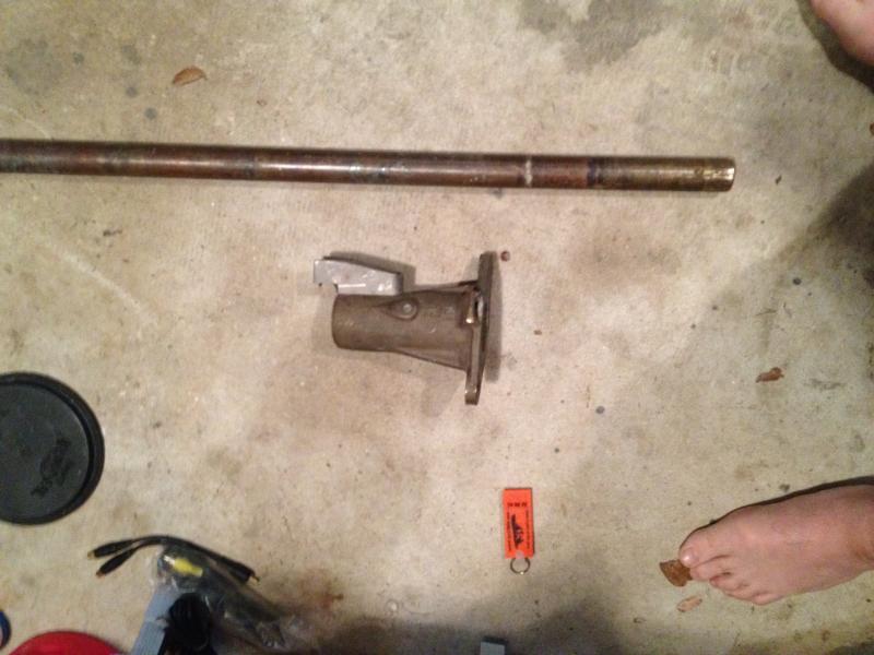

Prop thru hull 5 is a picture of the piece on its side, it bolts to the back of the fin keel - more or less. there is supposed to be a 8" or so tube attached to it that goes through the hole and allows the PSS or standard packing gland/stuffing box to be attached.
