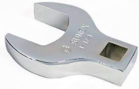

They work with a conventional 3/8" or 1/2" socket extension bar and ratchet. They are great for tight places. I never had enough space to get a conventional wrench on the nuts.

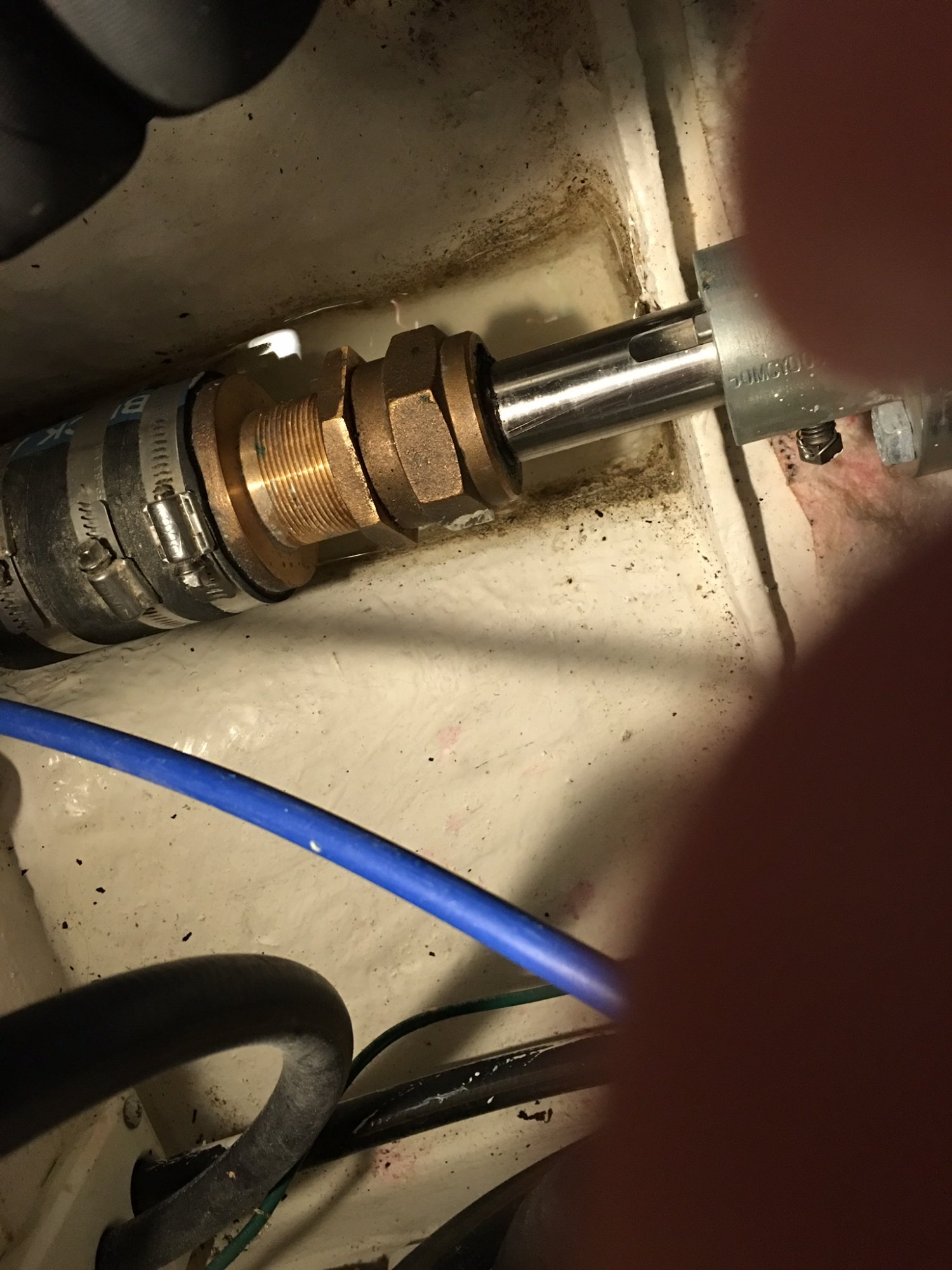

Do you think I’d be able to navigate two 2.25” crowfoot wrenches down into this area? I have to hang over the top where I've taken the picture ... there is no direct lateral access ... its about a 1.5 ft to 2 ft drop from the top edge of the covering cabinet down to the stuffing box.
It’s literally the only maintenance item that wasn’t brilliantly engineered by Catalina (not to mention I’ve got to lose 40lbs).

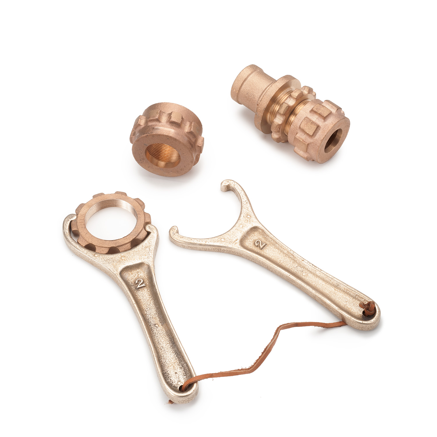

It appears you have a Spartan Marine stuffing box. They make specific wrenches for this box....

Short open end service wrenches with appropriate pipe extensions and a two pound hammer should work. Even short feeble swings on a hammer should loosen that lock nut. The threads will likely not be binding. Once you break that locknut free with the wrench, pipe extension, and a few hammer blows to the pipe extension everything should turn freely with your fingers. Most likely when the assembly was last serviced it was tightened by hand with difficulty and probably without much torque. Hammer wins that contest. Lastly schedule an appointment with a chiropractor.
Edit: I forgot to mention that you will need to apply a counter torque when you are hammering to loosen. Maybe brace the counter wrench with a wooden block against the hull. Patience.
Well, I learn something every day!
I am not sure I want to spend $72 for the wrenches, but it looks like a nice set.
I'd buy the spanners and save myself the grief.
For regular nuts, I made my own, but it was a bit of a personal challenge I had time to do (plus the idea of getting that monkey wrench and adjustable spanner off my boat was key). The adjustable spanner like any adjustable wrench was piss poor to use.
I have seen some of these stuffing box wrenches for $59 a set which is pretty decent, IMHO. Some even have 3/8" square openings so you can get a ratchet or breaker bar on them if need be. The only one you really need the wrench for is the lock nut.
