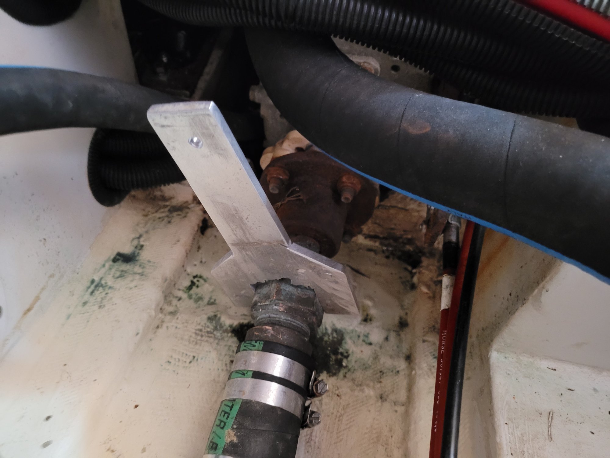

I use the above tools. Most helpful in my boat is the plumbers straight wrench.

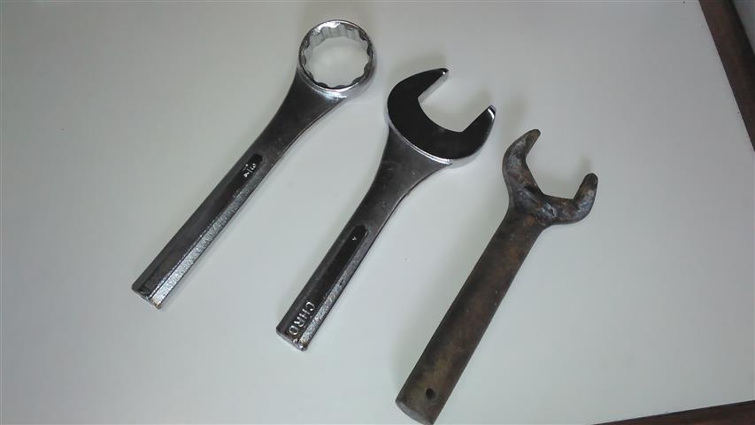

After too long suffering with the tools Terry mentioned, I went to a tool shop, bought the right size for my lock nut and had the tools shop cut it in half. Works great. I still use the adjustable on the box itself which turns easily once the lock nut is backed off. Photo shows the cut long combo wrench and the old fixed jaw which never seemed to fit the lock nut.
Stu is 100% correct. Having the correctly sized open end wrenches is the only way to go. Those adjustable plumbers' wrenches that you get from places like Home Depot are especially useless.

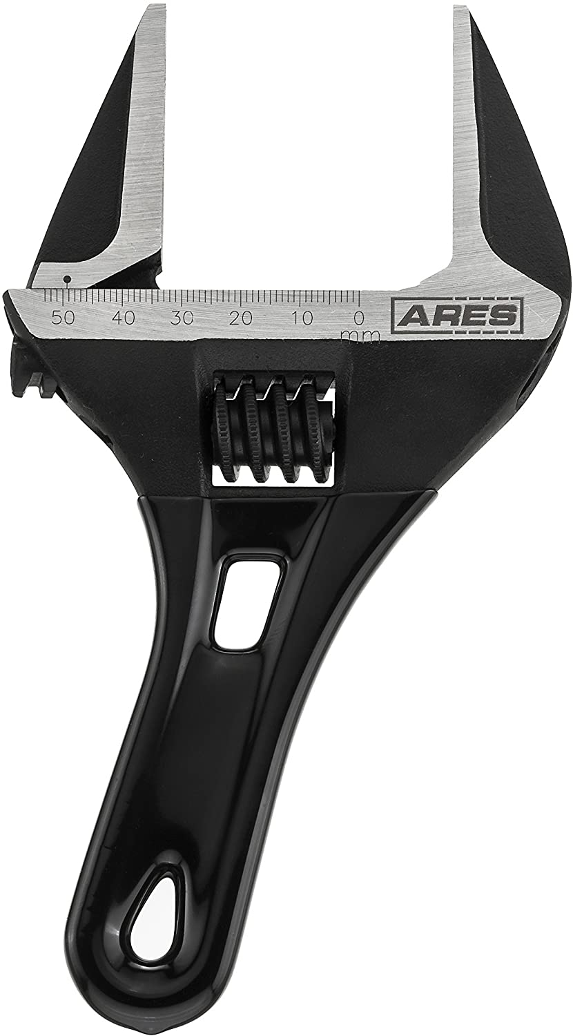

I bought the following from Amazon last year: it's great if you have limited room:
It's the ARES 70303 - 53mm Stubby Adjustable Wrench:
This is a really nicely machined adjustable that I use on the thin lock nut. I hated the cheap pot-metal plumber's wrenches. Still need a really big one for the large (non-lock) nut: that's on my to-buy list.
