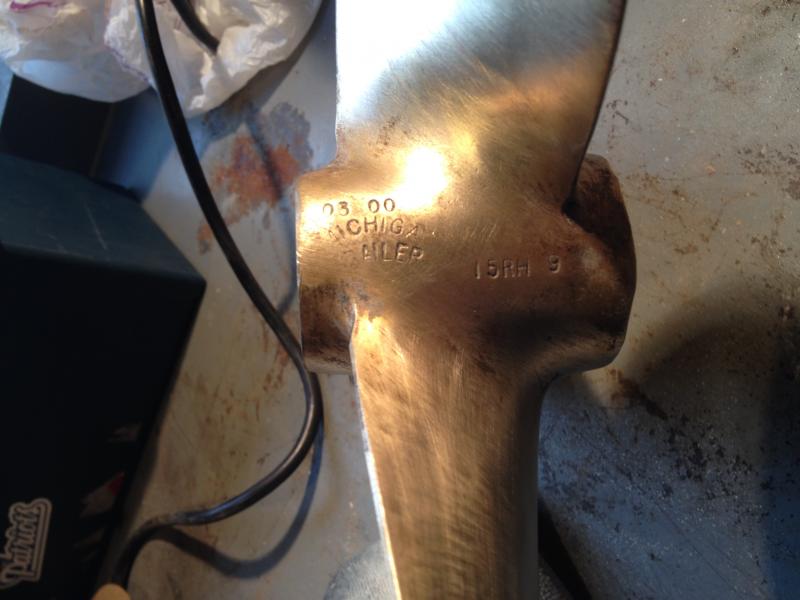

From the marine survey on the 2005 C-310 I purchased in July 2015:
Prop Shaft: 1" dia
Prop: 3-blade bonze alloy, fixed blades
Measured Dia: 16"
Pitch: 9"
Manual says it is equipped with a a 15x9

Mine came new with the 15x9 in 2001. Later changed to 15x9 flexofold and got rid of the prop walk.
