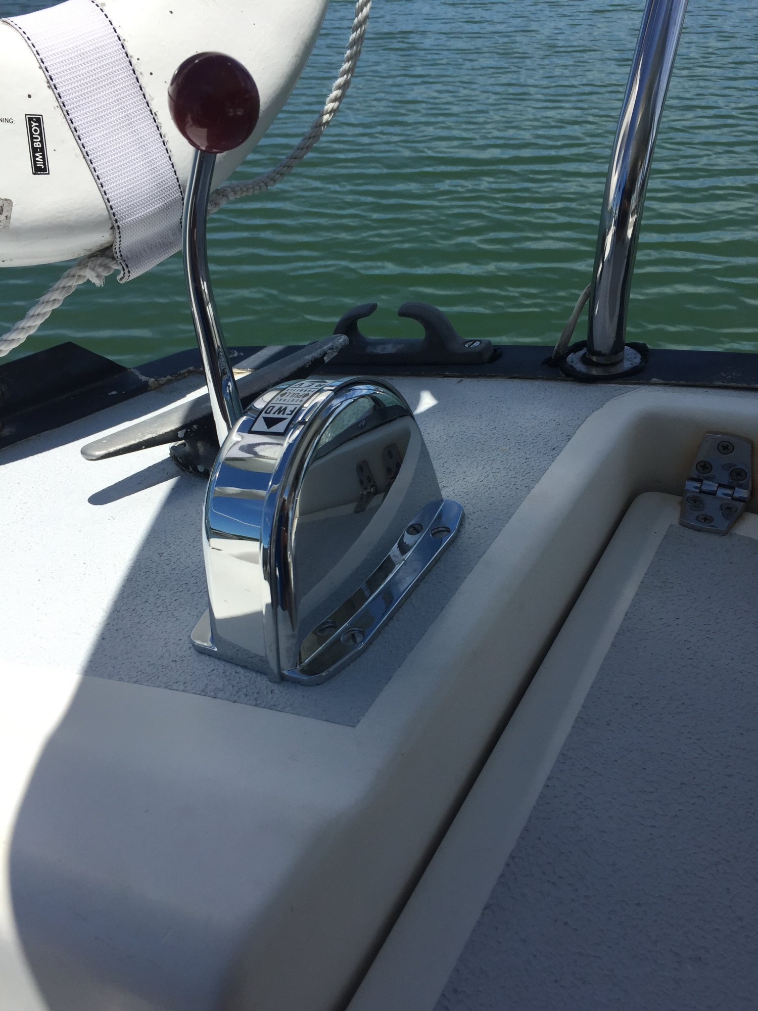

There may be a bracket available for your engine to reverse the direction of the shift cable. The Yanmar 2QM15 has one in the parts book under optional equipment. I went from a boat that had the throttle backwards to a boat that had the shifter backwards. In a panic situation, I would get very confused. Finally replaced the throttle/shifter with a single lever, dual function assembly and confused no more.

The shifter shown above can be configured to match your requirements in the field.

There may be a bracket available for your engine to reverse the direction of the shift cable. The Yanmar 2QM15 has one in the parts book under optional equipment. I went from a boat that had the throttle backwards to a boat that had the shifter backwards. In a panic situation, I would get very confused. Finally replaced the throttle/shifter with a single lever, dual function assembly and confused no more.View attachment 197379

Installing the single lever dual function controller is not difficult. You need to find a suitable place to put it so that you can reach it while steering with the other hand. Mine is behind me and reachable when I am standing at the helm. You will most likely need new cables for the engine throttle and transmission shifter. The device permits any required arrangement of push or pull for each function with a little reassembly in the field. Pulling the lever outward at the pivot permits full span of throttle operation without engaging the transmission. Needed when starting the engine, for example. Pulling the lever back to neutral automatically re-engages the transmission function. Have some tricky maneuvers to get into my marina slip and this device helps. Mine is a Seastar. The only complaint I have is that it is chrome plated and not stainless. Some accountant did this! It corrodes and displays pits in a few months. Constant waxing does not stop that. Otherwise, it works well. When selecting a location, keep in mind that there is a fairly large amount of the mechanism below the deck. The usual installation permits the cables to be connected with the unit out of the mounting hole. After connecting the cables you slip the assembly back into the deck. You will like the ease of operation compared to the pedestal controls.
