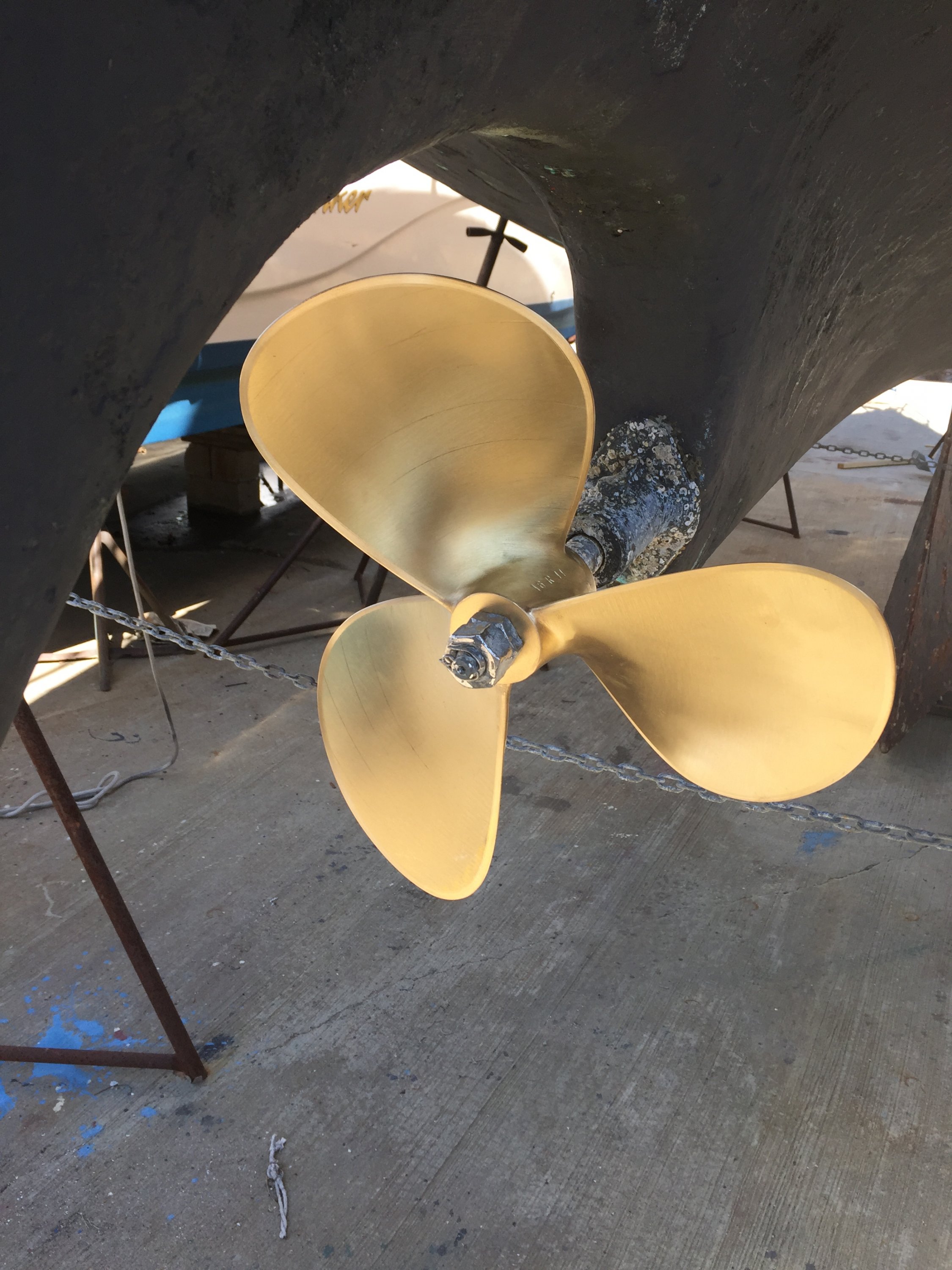

happy Easter all...I've got a question on prop, I just bought a new one and wondering should I paint with the Petite prop paint, I'm in Keyport NJ salt water?

No paint on the prop here. A diver cleans off a few barnacles each year then clean and polish every seventh year when I redo the boom paint at haul out. Original 1991 prop has always been in sea water; looks like new after polishing. Two zincs on the shaft.

If that prop is brass or bronze I would not paint it. Probably not since it is a new one. Chief

I'd leave it gold plated as it is.
