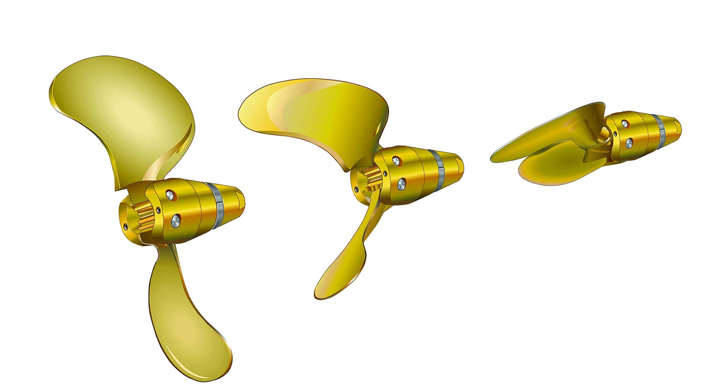

What type of propeller is the right one for this boat ?..........
Ditto quadrille38 ............depends what type of propeller type (fixed blade, folding, feathering) and how much you are willing to spend. You can do a search on this site for propeller recommendations. Once you select a propeller then go to the manufacturer/dealer and they will provide a quote for one sized specifically for your boat and motor. I installed a 3 bladed fixed propeller on my Hunter 31, 386 and now 46 for cost effectiveness and maneuverability.
You might find this article entitled "Understanding Your Sailboat Propellers" Helpful:
