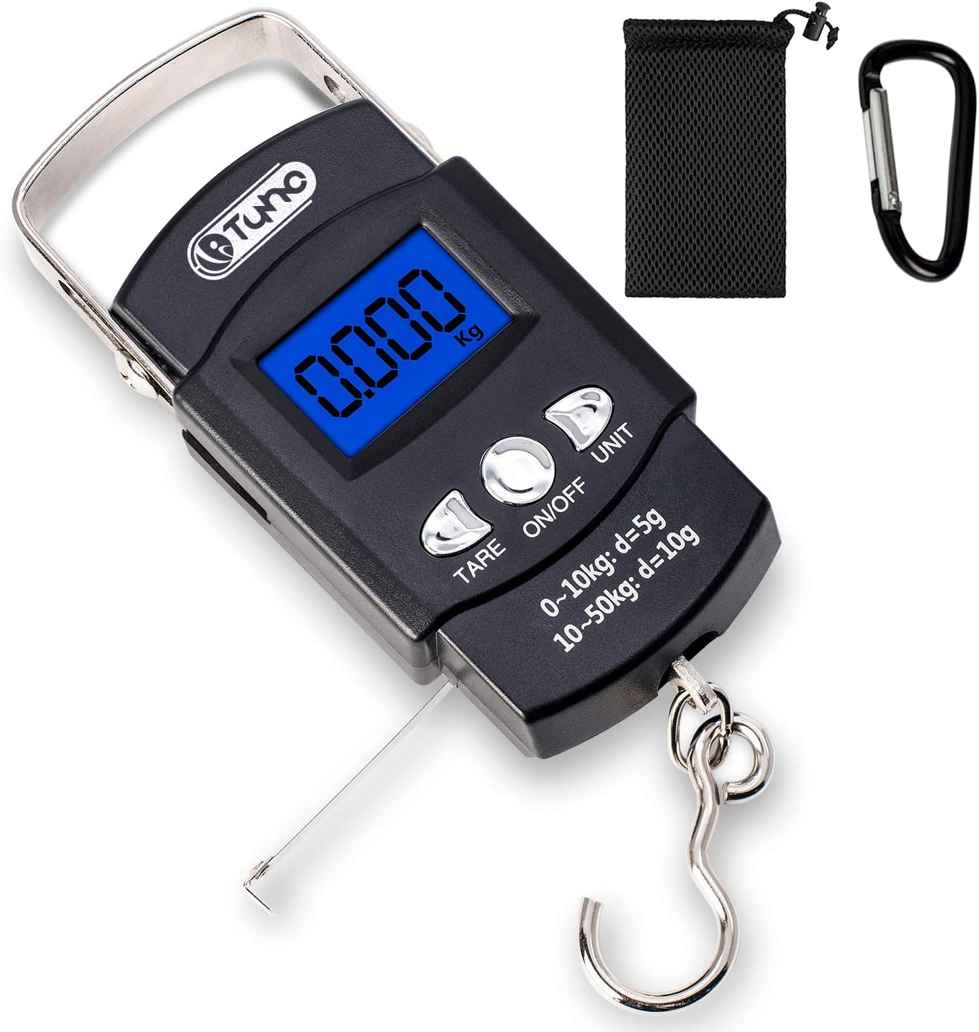

Incidentally, you might want to start measuring your gas consumption. We cruise for 3 weeks per year and spend most summer weekends on the boat, and use the range every day. I don't think I use a full 11 lb. bottle of gas per year. You may be surprised at how long 5 lb. lasts.
I bought a digital fish scale on Amazon:
When I bought the new tanks I weighed them empty, and then after filling them, and wrote these values on the tanks with a fat Sharpie. For remaining volume weigh then and subtract the tare weight, or use linear interpolation. :)
With the one lb. bottles, just weigh a new one, and assume everything but 1 lb. of propane is tare weight.
If you track the usage you can bring the bottle home to refill when it's getting low.
