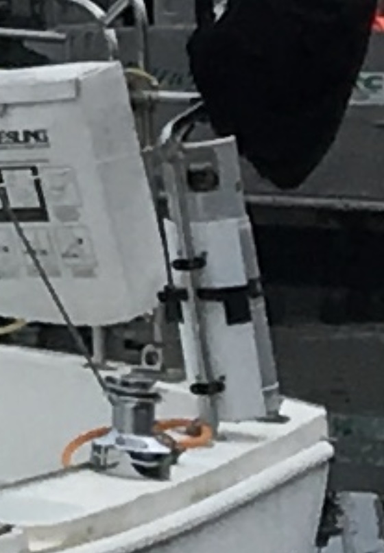

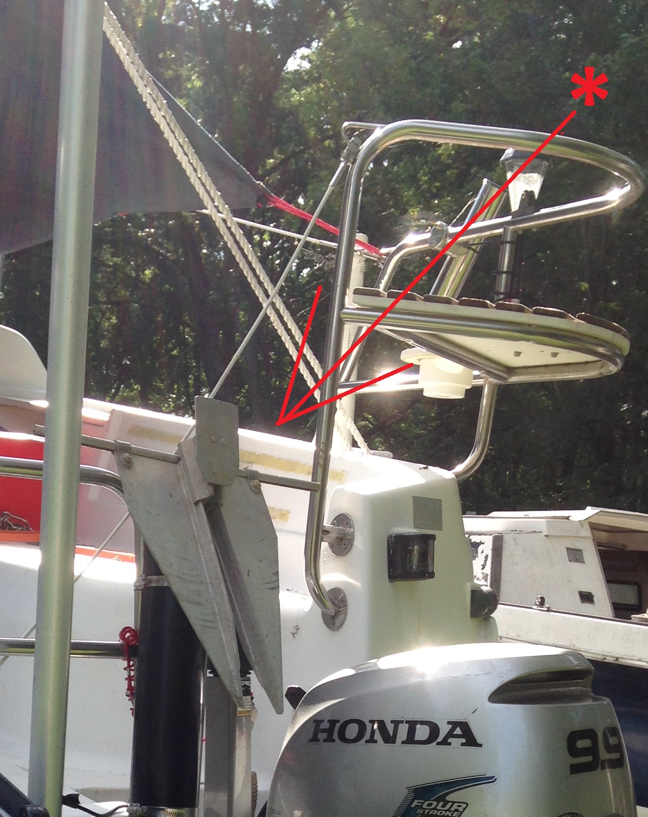

How professional do you want it to look? The stromburg that sf sail posted above looks a lot like a simple bracket and a large hose clamp. They sell large hose clamps in the plumbing section of Lowes and Home Depot... You might need to thred a few together to get all the way around a tank and then you need to figure out how to make a bottom "lip" to sit it on. I can think of several ways to do that but they would all look homemade. Here is an example of an anchor mount I attached to my stern rail using a similar strategy. You would need a really large pipe to make this work but maybe a PVC bucket with the upper lip cut off would work. Or you could attach an L-bracket to your stern rail to sit the tank on and hose clamp the tank higher up. I'm also imagining you would want to get a hose clamp with a thumb screw so you don't have to go fishing for a screw driver every time you changed out the tank.

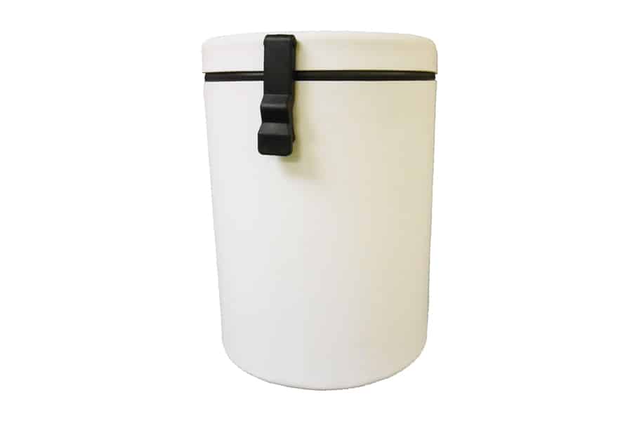

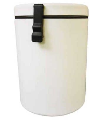

Another option is to install a Trident propane locker, which can be supplied with a solenoid valve and separate switch. I have a double locker with solenoid valve and separate switch on the sundeck of my power boat.
