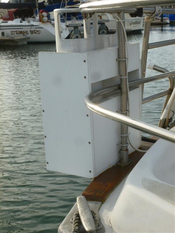

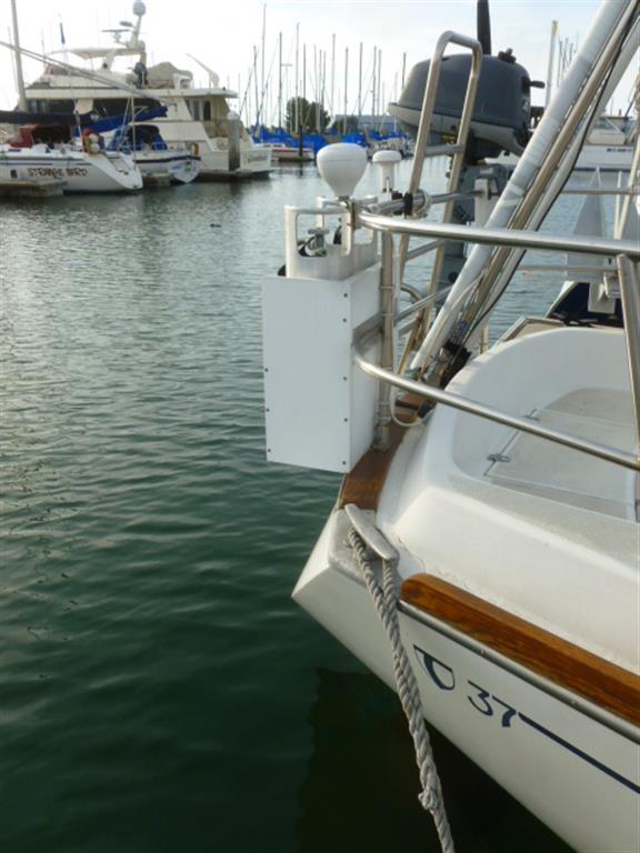

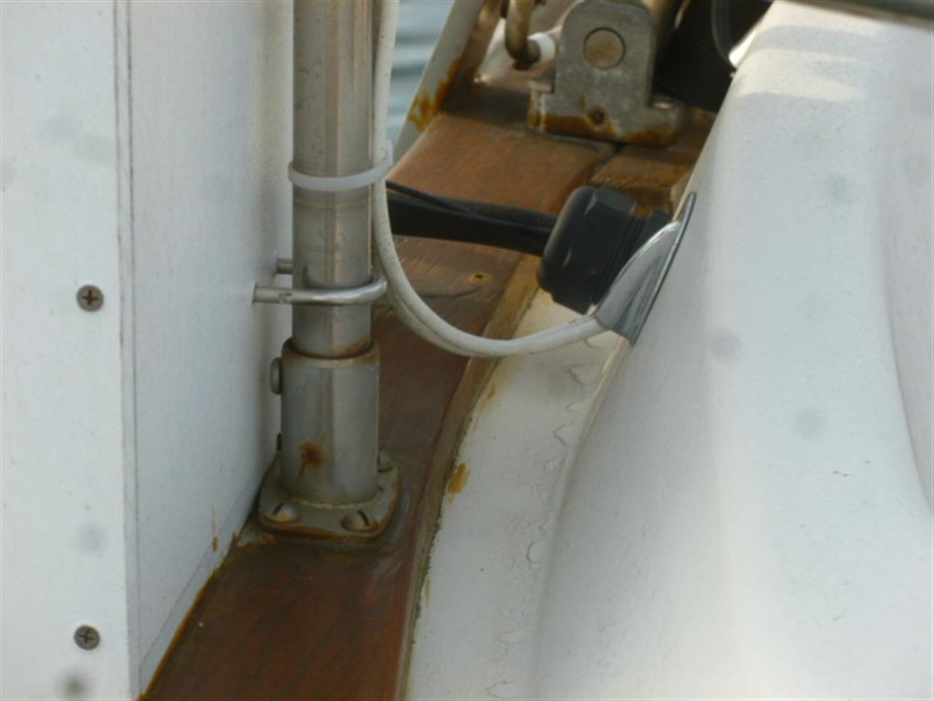

During a recent trip to Canada I noticed a number of sail boats with propane tanks stored in racks on aft railings. I am looking for pro/con comments, suggestions, etc. and sources of supplies.
May 20, 2016
2,992
Pro-
older boats don’t have the dedicated propane locker.
New lockers to ABYC and fire codes are expensive (6-7x cost of the rail mount).
Propane lockers take valuable space in lazerette
Propane lockers require yet another thruhull
On rail leaves wires and solenoid out in the weather
Some PO of my boat mounted a fender holder on the stern and racked 2 6-lb cylinders there. Ugly. I just pulled it off last week and am making a Aluminum rack with starboard cover so it looks better.

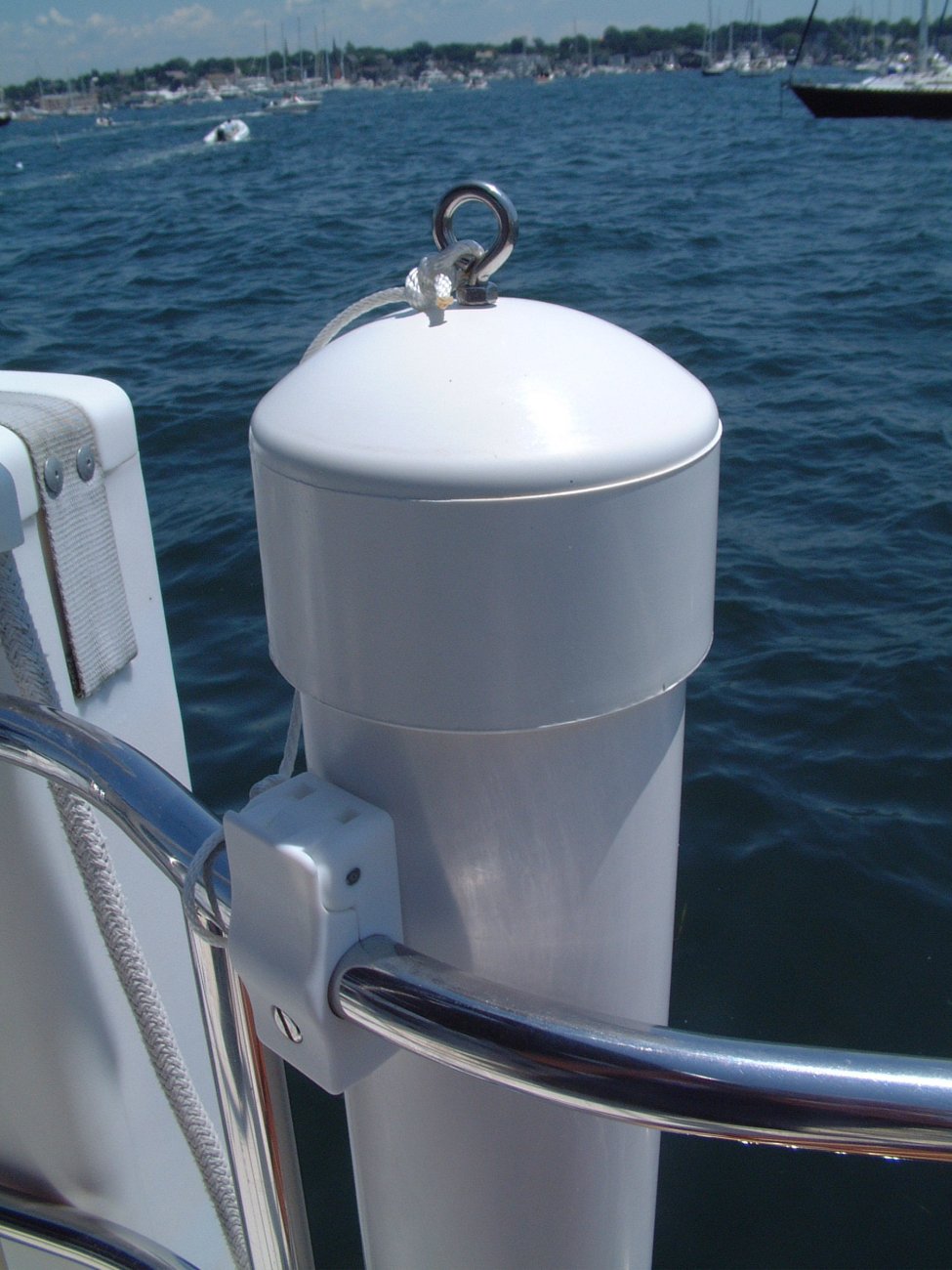

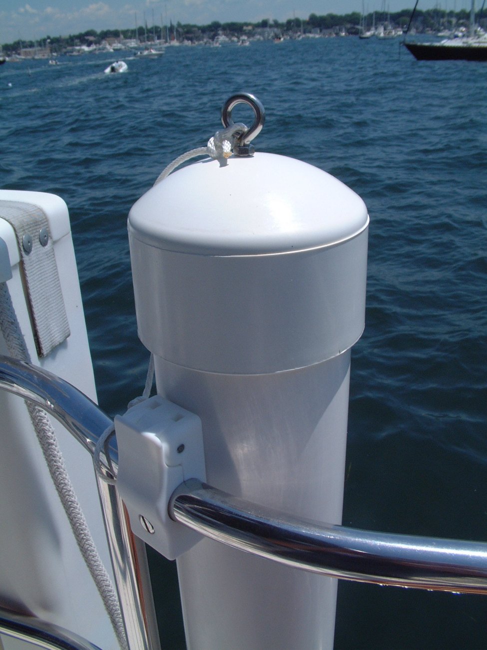

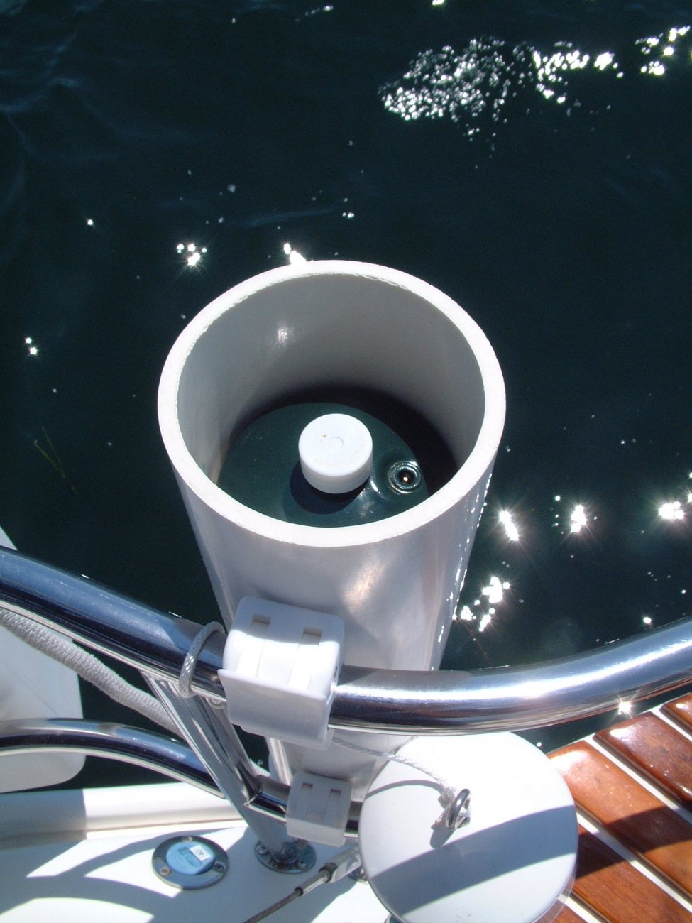

Rich. Nice project. What did you use for the clamps to the rails? Pre-made or self manufactured? How are they attached to the PVC Pipe?

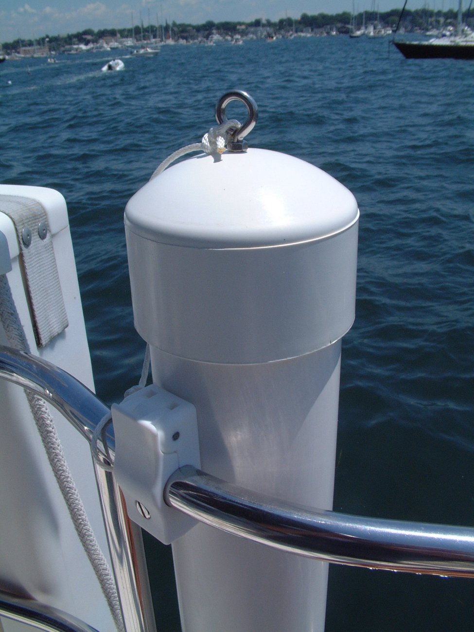

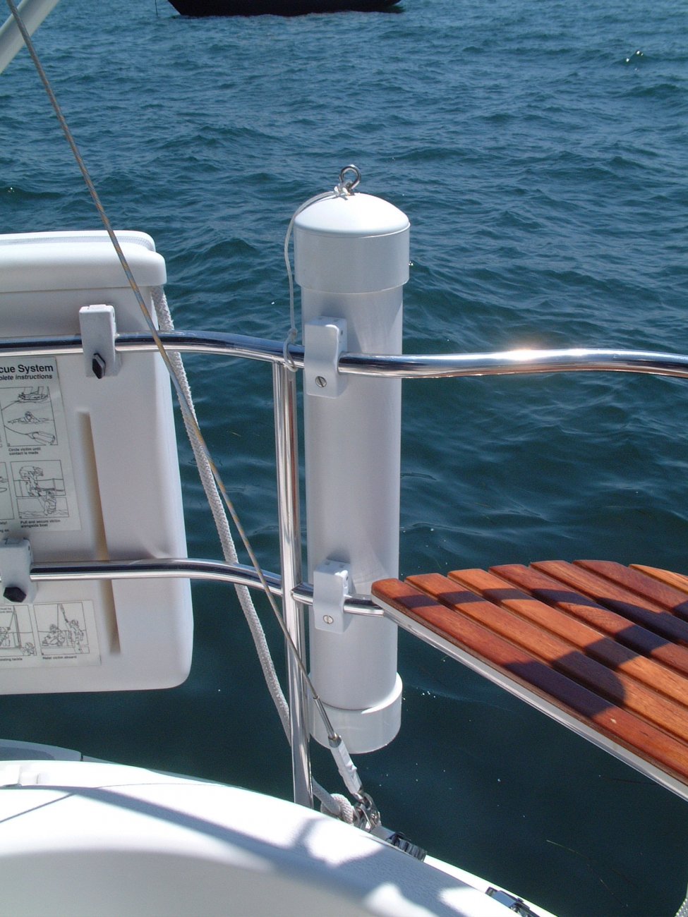

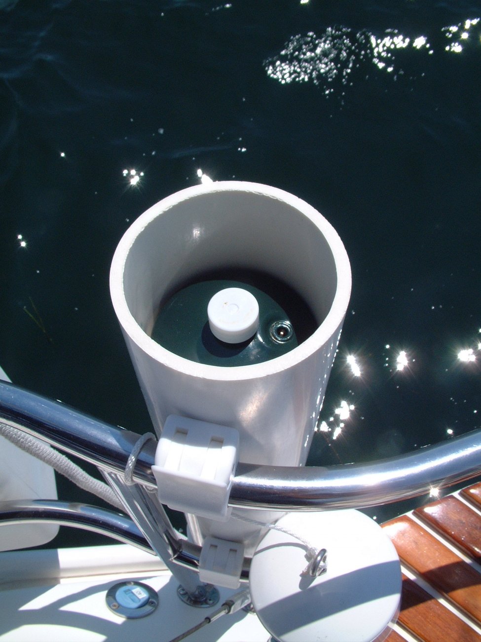

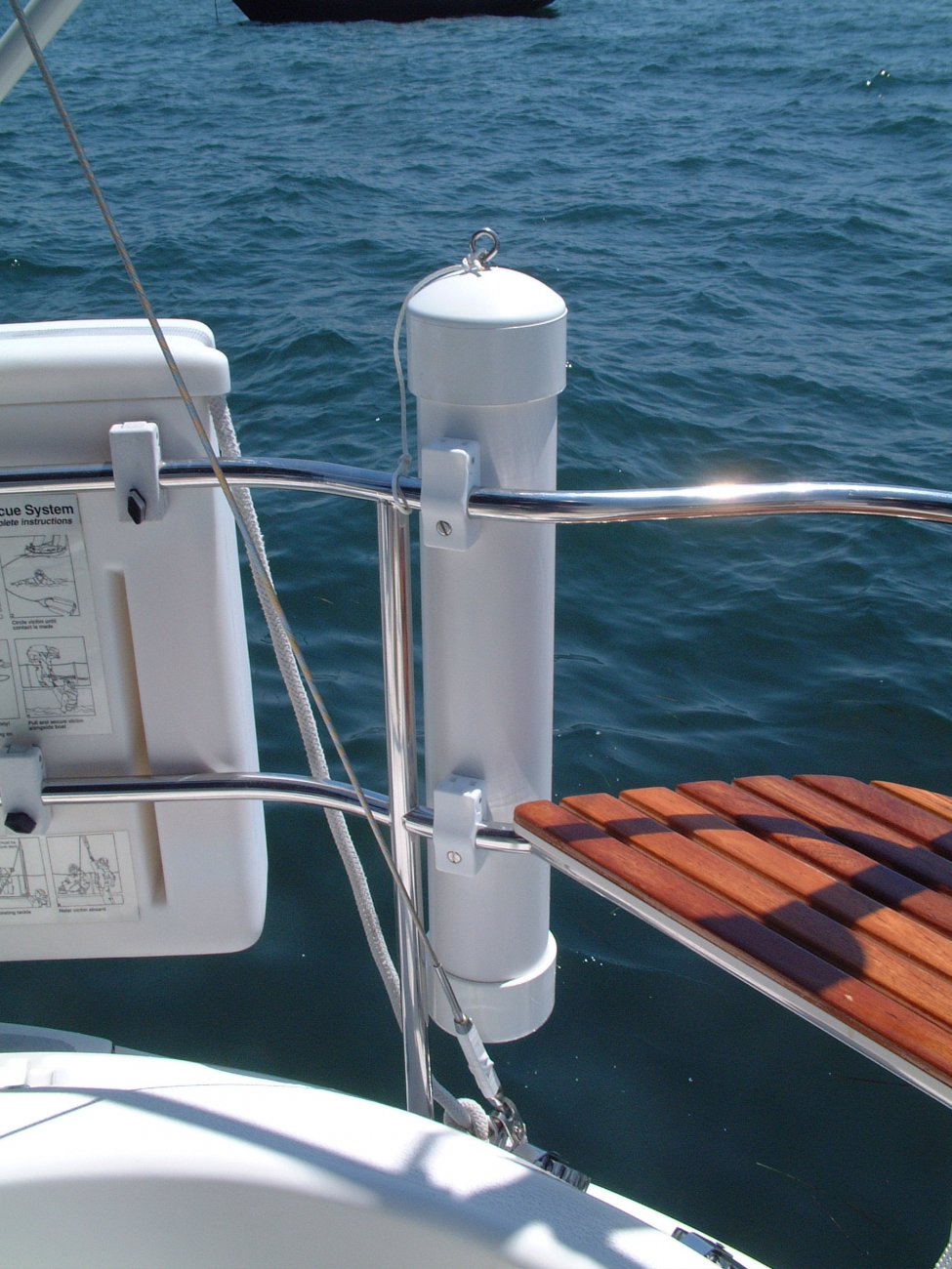

To answer jssailem:
The 4" PVC tube was a pre-cut 3'(?) piece that I bought at Home Depot. HD has a variety of PVC pipe sizes in short sections. Added to that are two end caps. The bottom end cap is glued on the tube and has a 1/4" hole drilled in the center for a drain in the event of a propane leak. Choose a boat mounting location so that any leak would pass overboard and not into the cockpit. The top cap also has a 3/16" or 1/4" hole that mounts a stainless steel eye bolt to secure the top with an 1/8" line to prevent loss overboard. The clamps were purchased at West Marine in a package of two.
Link: https://www.westmarine.com/buy/west-marine--plastic-rail-clamps--5142070?recordNum=28
The only thing I don't like about the clamps is that the clamping screw is not captive. So you need to be aware and very careful that you don't offer it to Neptune when you mount or dis-mount the assembly.
The hardest part of the construction was mounting the clamps to the PVC tube. The clamps mount with some #10 machine screws from the inside of the tube to captive nuts in the clamps. You need to attach the clamps to the rail in the location that you choose and then mark the position of the clamps on the outside of the tube. Then locate the two mounting holes for each clamp and drill the tube. Since the propane cylinders are a close fit to the inside of the tube, you need to use flat head machine screws and counter-sink the inside so that the screw heads are flush and don't protrude into the tube. I used a hand counter sink tool that I could get into the tube to accomplish this task. Then simply attach the clamps and mount on the rail. The tube nicely holds three of the 16.4 ounce propane tanks. If you have a "fat" arm, reaching into the tube to get the one on the bottom can be difficult. If you use the Flame King refillable tanks, they have a nice plastic combination cap and handle that is much easier to grab than just the top threaded fitting on a standard bottle. And the plastic handles minimize the chance of dropping the tank in the water too!
All told, the construction project took about an hour. But you do need access to your boat to mark the tube and determine the best mounting location.

The only thing I don't like about the clamps is that the clamping screw is not captive. So you need to be aware and very careful that you don't offer it to Neptune when you mount or dis-mount the assembly....
I would think that any machine shop with a lathe could easily make undercuts in the threads of the screws that would allow you to add some stainless steel E-clips or maybe some O-rings to make the screws captive.
Feb 10, 2004
3,508
Hunter 40.5 Warwick, RI
I have a lathe. But the task is really far down on my list. Until I drop a screw overboard, that is.

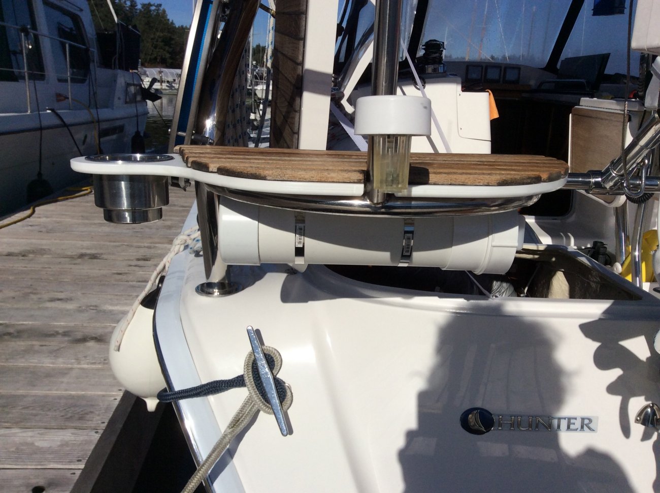

My design: Holds three 1# bottles. Cost about $30. It even holds the Flame King refillable 1# bottles- slightly taller but fit perfectly. BTW, these refillable bottles are really slick.
View attachment 158427 View attachment 158428 View attachment 158429
Nice. I did similar but added an aluminum flat bar, cut to size and folded 90-degrees (with ends bent in toward the middle, about 1”) and the cans are inserted with the bends above and below the cans. To remove cans lift the bar and the bottom can is lifted so they all slide up.
Feb 10, 2004
3,508
I considered that option, but the clearance between the bottles and the PVC tube is only about 1/8" (1/16" around) and I couldn't find a thin metal that was strong enough to work. What did you use and when did you source it?
