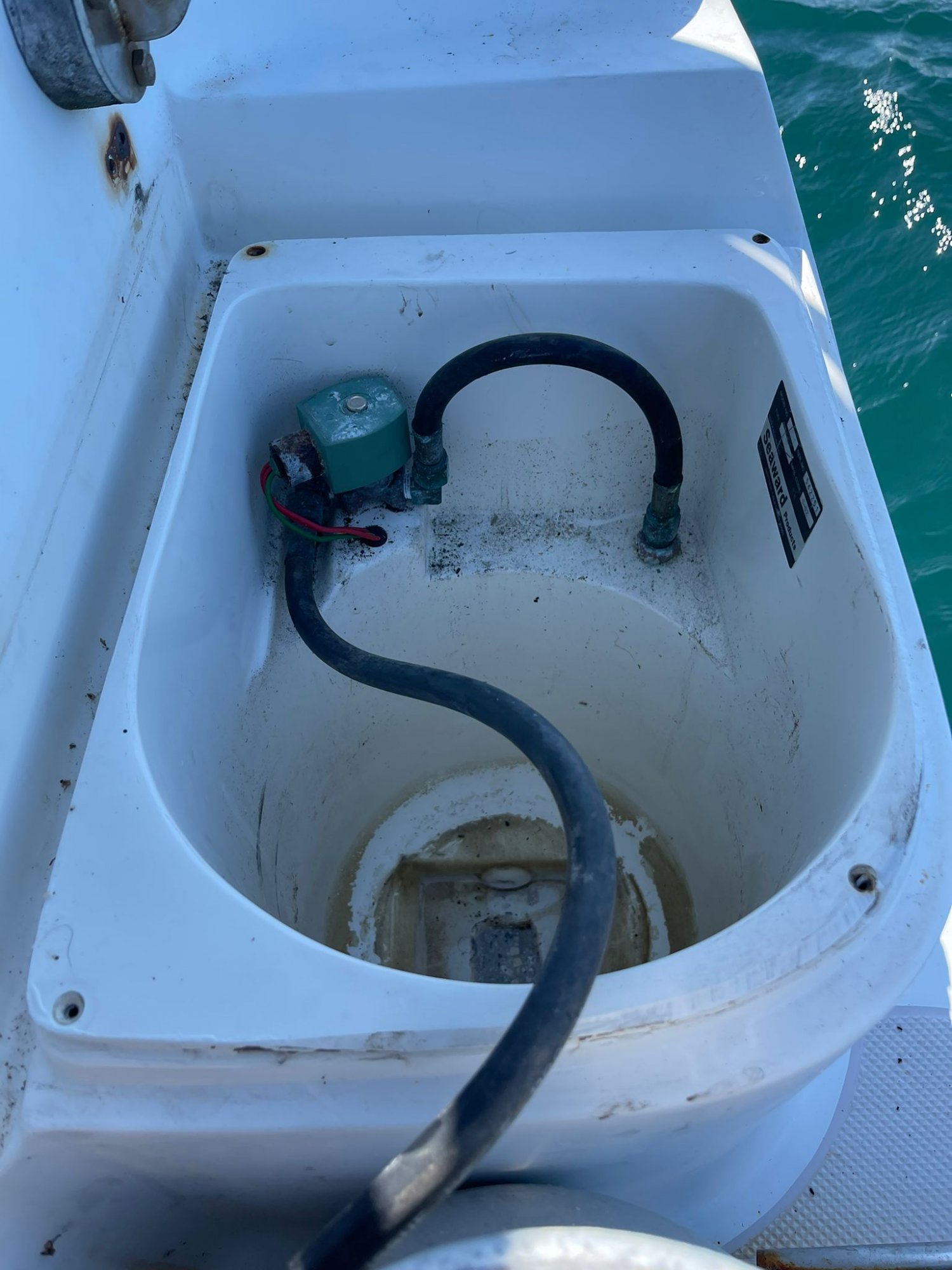

Hello All,
I need to replace the propane solenoid valve. I see CD sells it for $$$, I was wondering if there is any difference with ordering any 1/4” NPT female 12v solenoid? I was looking specifically at this:Solenoid

I may give it a shot: Does anyone know what the original asco valve is, on mine the plate is faded and illegible. Can you also confirm that it’s 1/4” thread? Asco valves can be found at any grainier store and are reasonably priced for 12v valves.

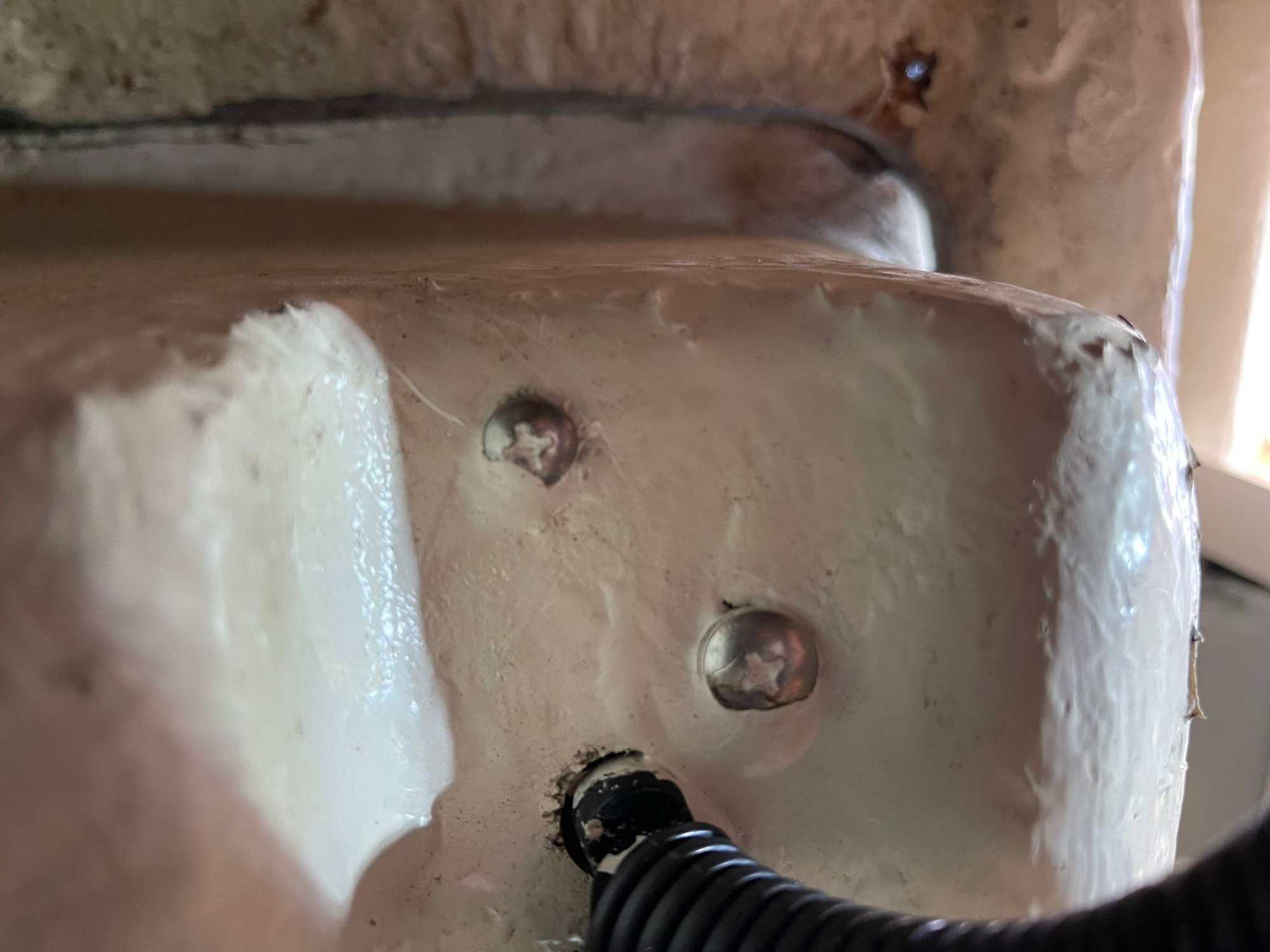

I went with the wife back to the boat on Sunday, has anyone had any luck with removing the solenoid. The two screws that hold it in place are partially covered by gelcoat. I sent my wife in the locker but she had no luck getting either of them loose. I'm on a ball so don't have a lot of options with using different power tools. I tried removing the 4 screws that hold the seaward locker in place but its glued on all 4 sides. Any thoughts or ideas?

The only thing I can think of is to remove the wiring and the gas lines and outline the base of it with a box cutter - just score it. Then using a sharp chisel remove the gelcoat/fiberglass working until the screw holes are exposed and any flange that is there. A Dremel may be useful too. If you can smack the screw ends from underneath it may come out. You may be able to get a pry bar underneath the unit. Last resort is to get a piece of plywood between it the locker surface and pry it out with a crowbar or other means.

Battery powered rotary (Dremel) tool. Grind the gelcoat off the screwheads and clean them up. Or, battery powered drill and drill em out.

I was able to go get it out this way, only down side is that we managed to drill a hole next to it. I'll epoxy the holes and re-drill for the new solenoid! Thank you!
