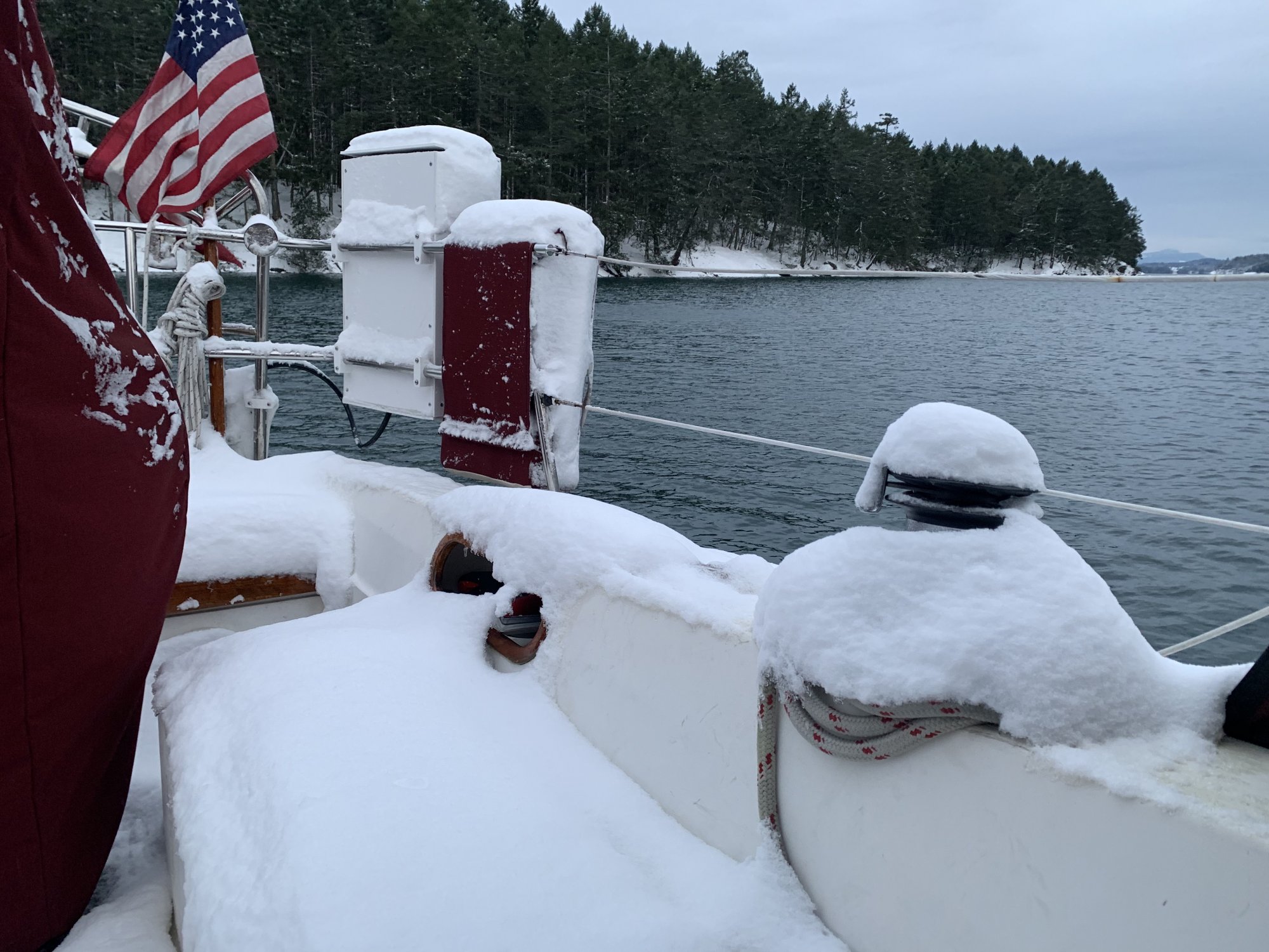

Feb of 18 @jssailem and @Ward H went sailing with me on a winter cruise.. much colder than expected. The Planar was belting out heat for a solid week no problems, nice and warm.
