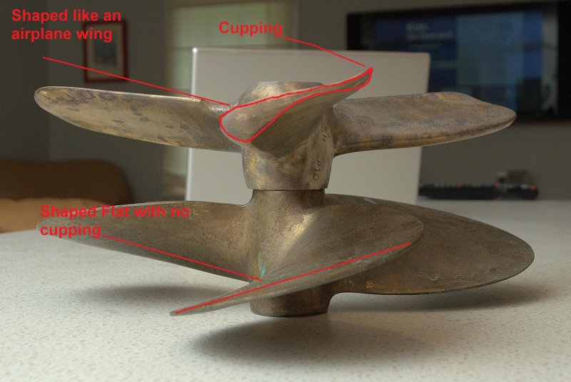

Here's cross sectional comparison of the props unique design comparing the CS to the MW:

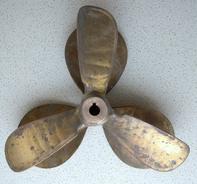

Here's a photo of the sheer reduction in surface are which helps result in the 200% reduction in drag between the MW and the CS (13 pounds vs. 39 pounds):

Most boat propellers and many fans look very much the same. The Campbell is the first that has a true airfoil shape appearance. Low speed props and high speed props look very much the same but they shouldn't. What works well at 250 rpm won't necessarily work well at 2500 rpm.
